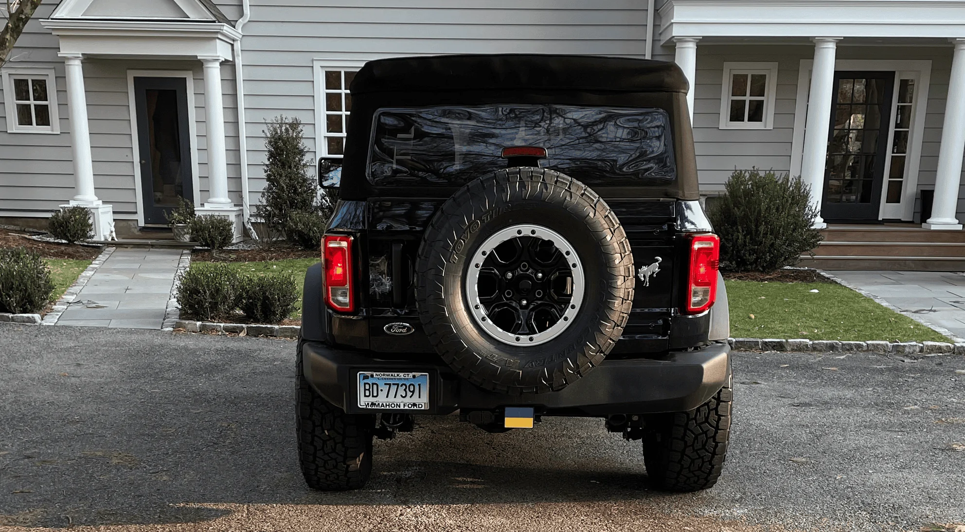

black rhino delta wheels. 17x9.5, +12 offset. I bought these for the numbers and had them powder coated.
Mickey Thompson Baja Pro XS 35x13.5
I did a cheap 1" spacer level lift from rough country in the front. But that was for the look. I don't think it was necessary for clearance.
And crash bars removed.

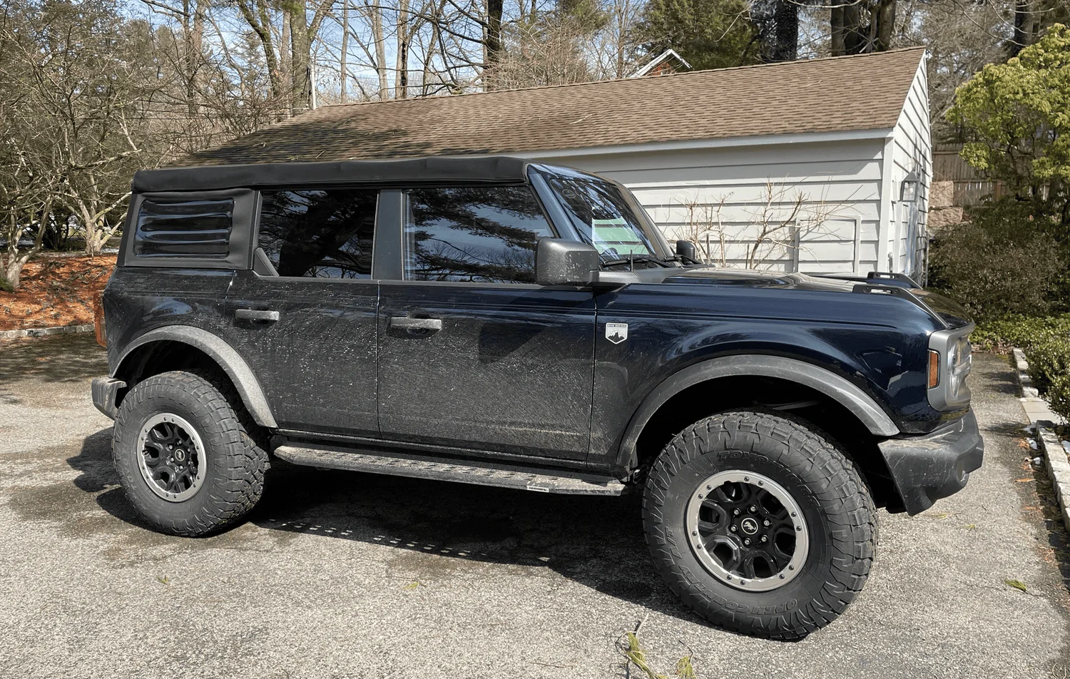

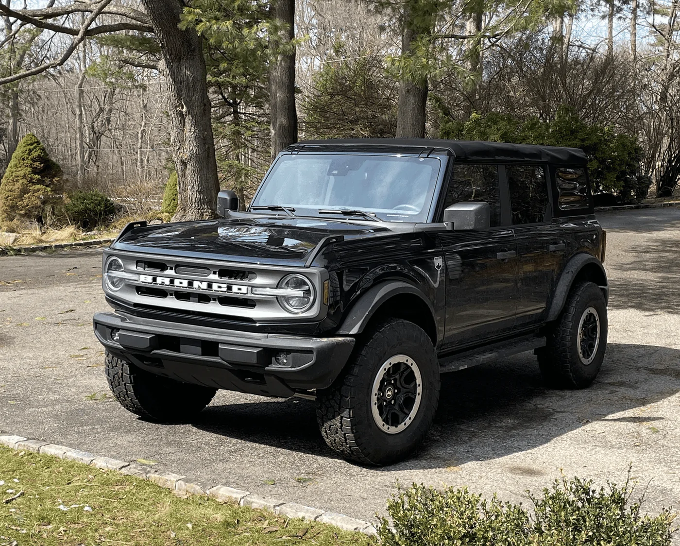

I’ve posted this before.
1.5” spacers stock alternative BL wheels. 315/70/17 Falken Wildpeak tires.
Love the feel of these. Handle rocks/mud/snow great. On road manners are also good. The tire poke, bc I have the standard flares, does throw A LOT OF MUD! These tires are not rock slingers.

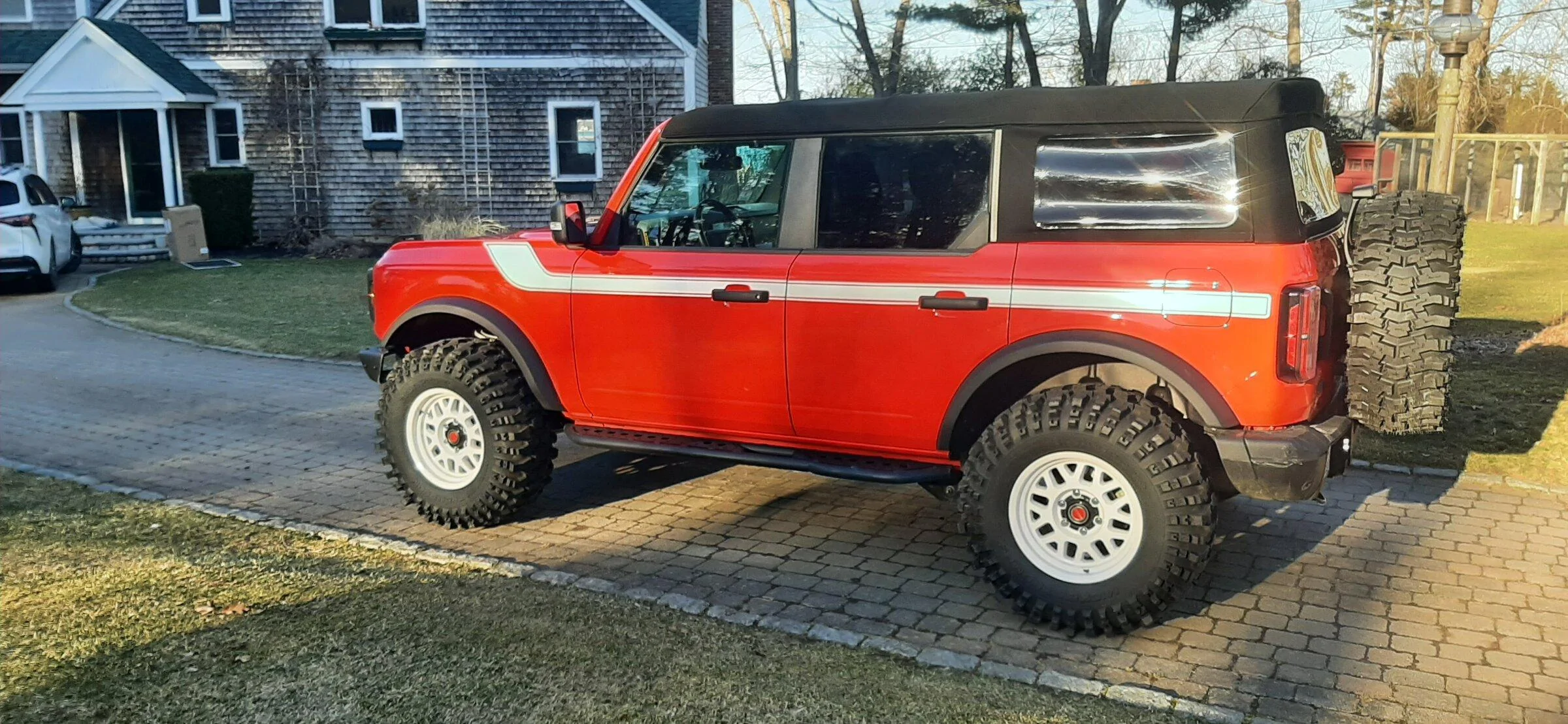

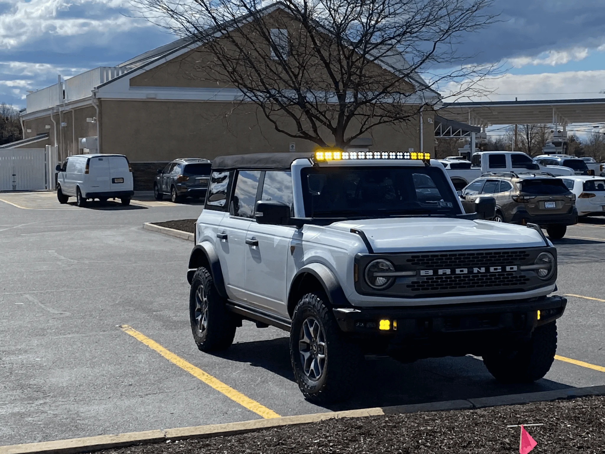

Has anyone received their Non-Sasquatch Badlands and installed 35s on it successfully with no lift? I'm curious if the <1" lift that the Sasquatch package has over the standard Badlands actually makes a difference or not when it comes to rubbing.
I opted for the Manual Transmission and I'm having a hard time paying $4k for the Sasquatch package, when it's mostly just different wheels, larger tires, a small lift and larger flares. After reading about how much people dislike the Goodyear tires, I am starting to think it would be a better idea to get a non-sasquatch and get my own wheels & tires after delivery, but I would prefer not to have to install an aftermarket lift. It seems like a waste of money to order the Sasquatch package and have to buy different tires upon delivery to avoid the Goodyears throwing rocks all over the side of my brand new vehicle.
Apologies if this has been asked in another thread recently. I looked around and most threads on this subject were created before people actually got their Broncos. This thread is more of intended for people that have actually done this to their own Bronco.
I have a non Squatch Big Bend 4 door manual. After I had it for a couple of months I bought used Sasquatch rims, 35" Toyo AT III's, a Zone 2" lift and a Rough Country tail light extender. Even with the lift there was some rubbing, and my mechanic couldn't legally remove the crash bars in my state, Connecticut. I replaced the OEM crash bars with tapered 4-Wheel Parts crash bars and everything is fine now.
