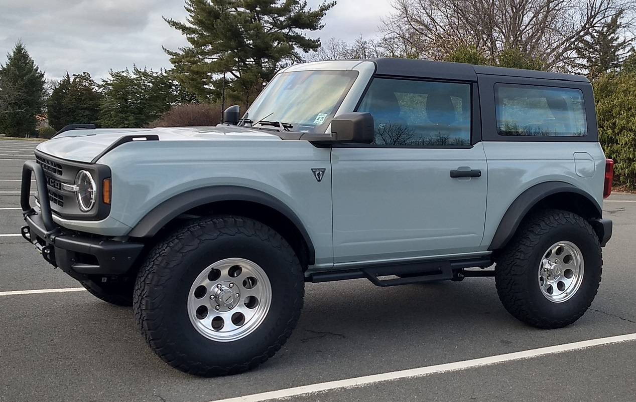

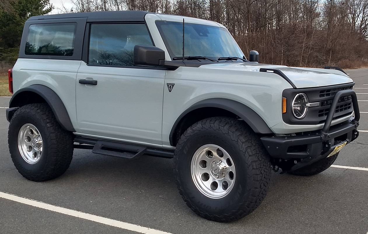

I just got some 37's this week so not a lot of time to judge, but these KO2 C rated tires are lighter than the 35" E-rated KM3's I had so it feels a lot better on the road. I did have to remove the front mudflaps since they rubbed the 35's so there was no way they would work with the 37's.
Just gotta say I love the look of those wheels. I got a clearance deal on some Methods, but that "soft 8 hole" look in machined or polished should have been a factory option or maybe Big Bend stockers.
I'm going back and forth between KO2s and KM3s. My KO2s have been great and they generally wear well.
