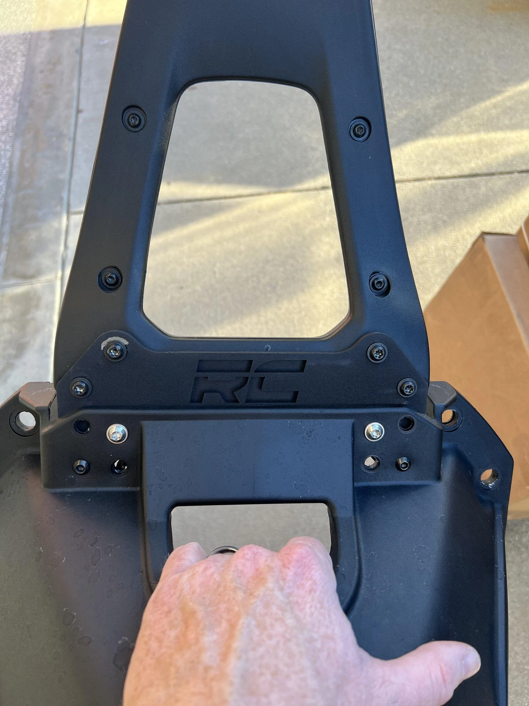

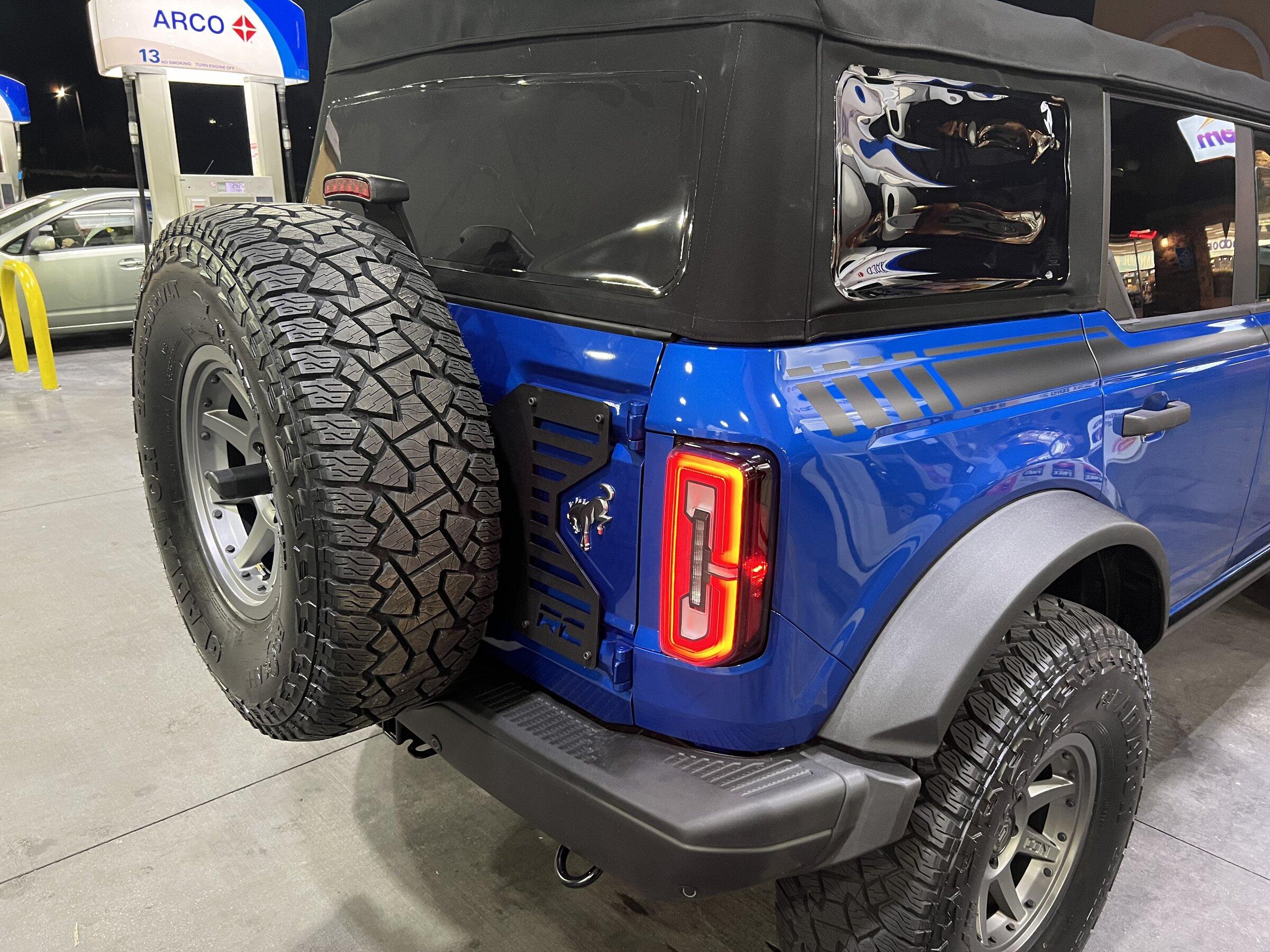

So prior to having the Bronco delivered, like many I had a garage full of parts. These parts also included things I thought I would need to accommodate my planned 37" tires.
I bought the Rough Country spare tire extension bracket, which pushes the carrier out about 1" and "up" about 2" from stock. https://www.roughcountry.com/bronco-spare-tire-relocation-plate-51053c.html
I also bought the Rough Country 3rd brake light extension bracket. https://www.roughcountry.com/bronco...qJ_FbN2BdXSuTNsZVGhBGRbJNYCjcT2RoCRhwQAvD_BwE

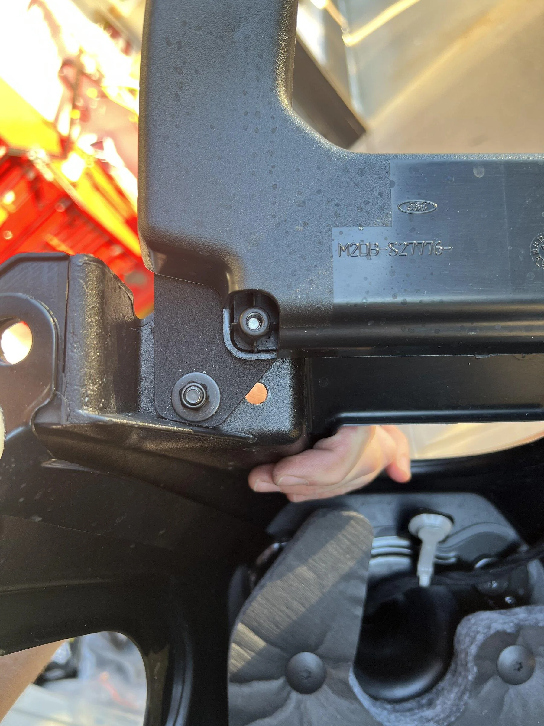

I also bought the tailgate reinforcement bracket. https://www.roughcountry.com/ford-bronco-tailgate-reinforcement-51052c.html#2921=6651
A few things I discovered when installing:

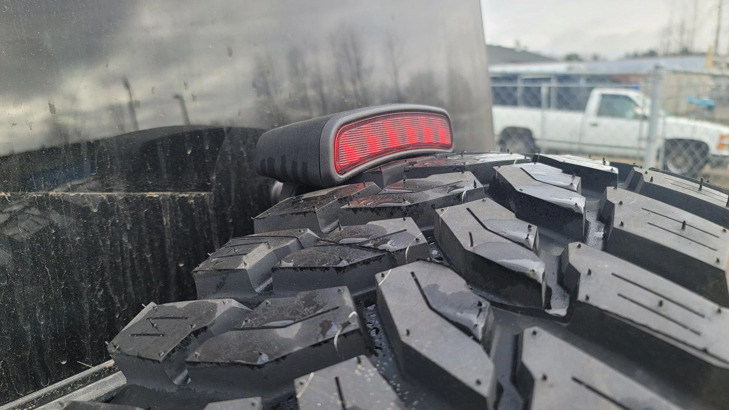

- The 3rd brake light extension does NOT fit sasquatch models out of the box, as the two bolt holes on the carrier are 180-degrees of where they are on the non-sasquatch models. However, it was very easy to drill 2 new holes in the "right" location through the carrier (using the extension plate as a template) and making it work. This IS neccessary to have this extension for running 37's, so I had to make it work... and it works well.

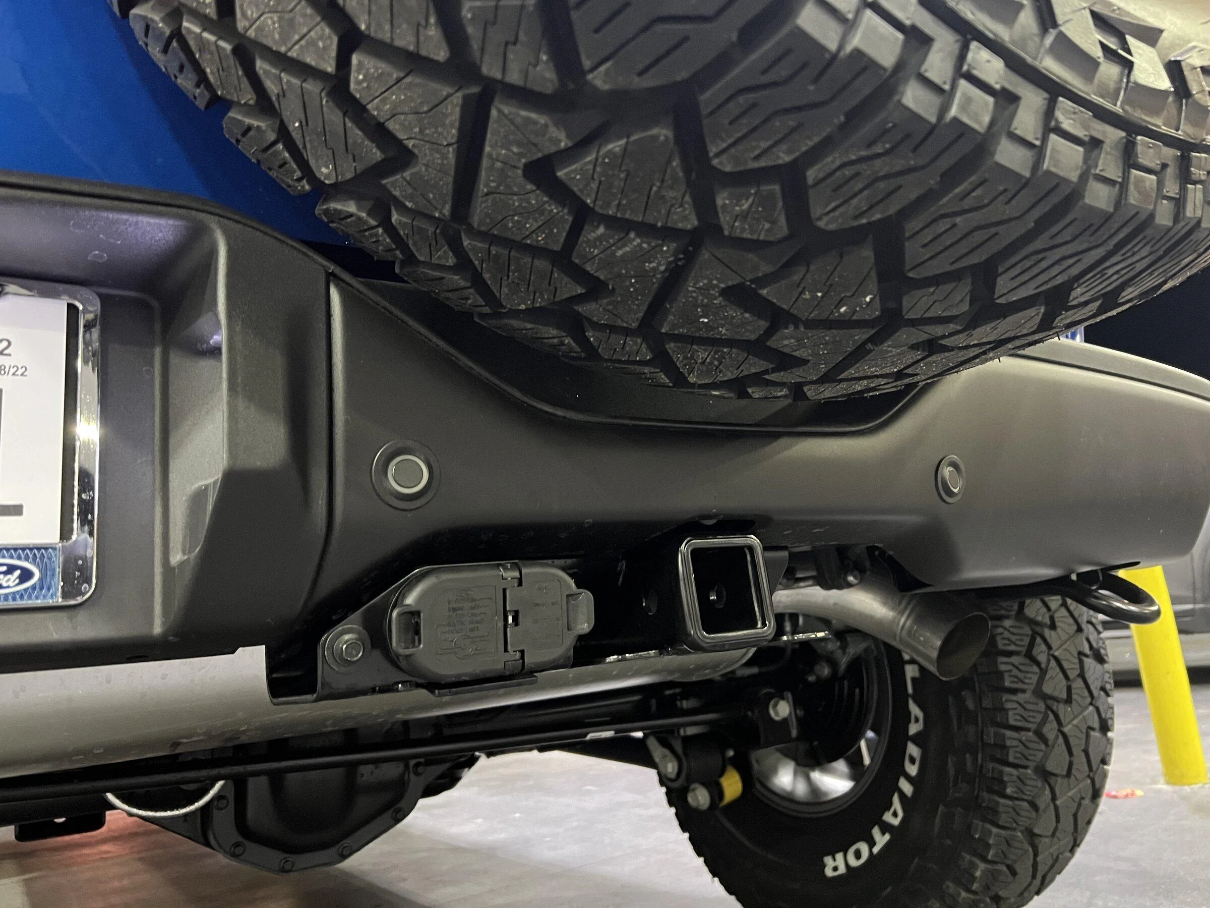

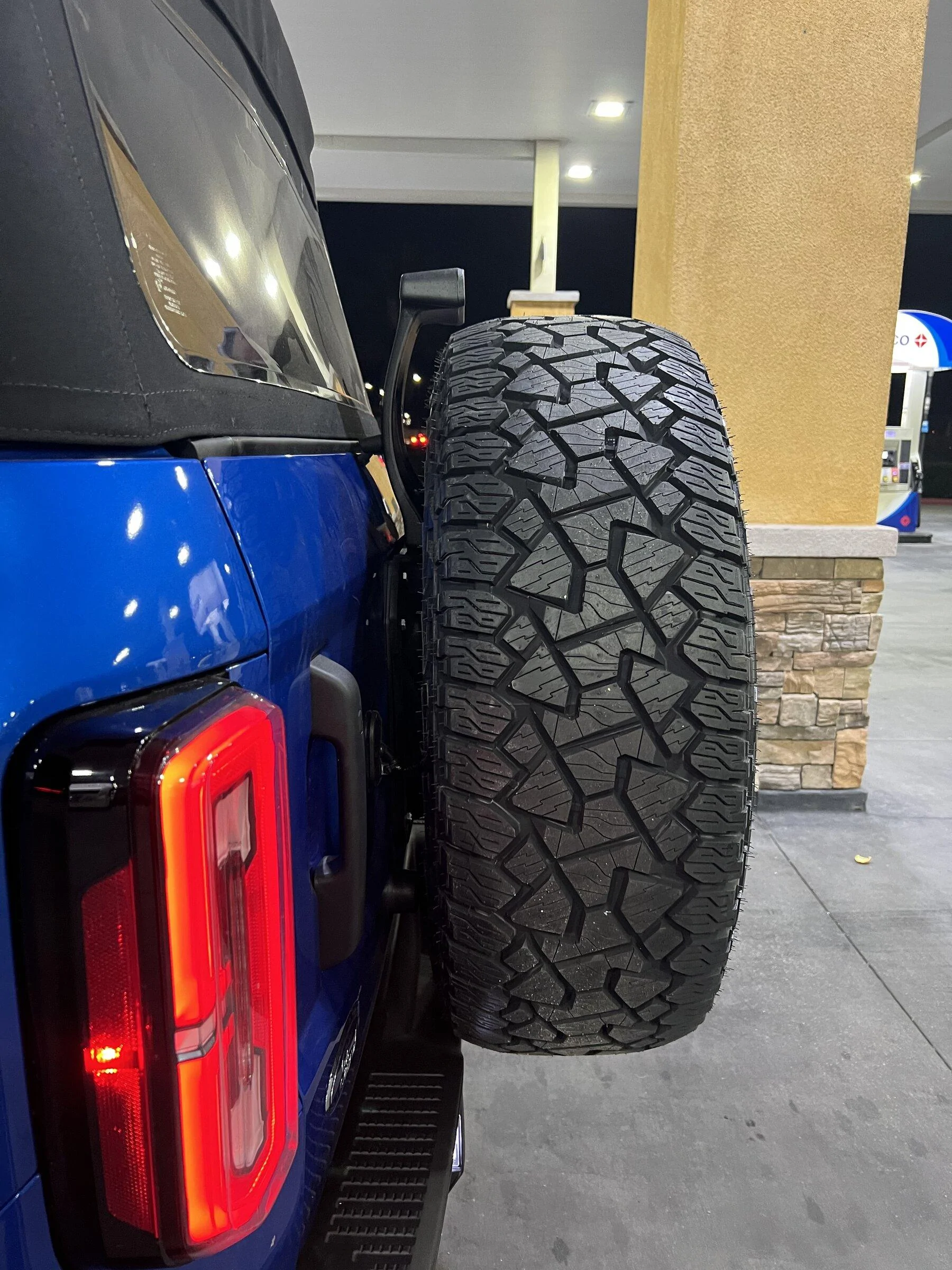

- The spare tire relocation plate is NOT needed necessarily, depending on the wheels you run! I have the Icon Rebound Pro with a 0 offset, and the 37's fit PERFECTLY without this bracket. I'm glad too, as I want the extra weight as low and close to the vehicle as possible. This bracket may only be needed if you have a high negative offset wheel... I'd test fit anyway before I bought one!
- The tailgate reinforcement bracket was a bit tricky, helps having 2 people to get things lined up when you to to retighten everything!!!
Pics:

What were you stock sized tires?
My 37s fit just fine on the SAS tire carrier
EXO Bronco
EXO Bronco
Matt
Sep 30, 2021
148
547
Upland, CA
Explorer ST, Audi S4, Raptor (Previously)
35’s, Sasquatch package.
Yeah it seems the 37’s fit OK if you had a Sasquatch package factory, must be a different carrier?
Their site should say that… save the hassle!

Yes, I had to redrill the brake light extension as well. Wasn't a big deal but obviously wasn't expected.

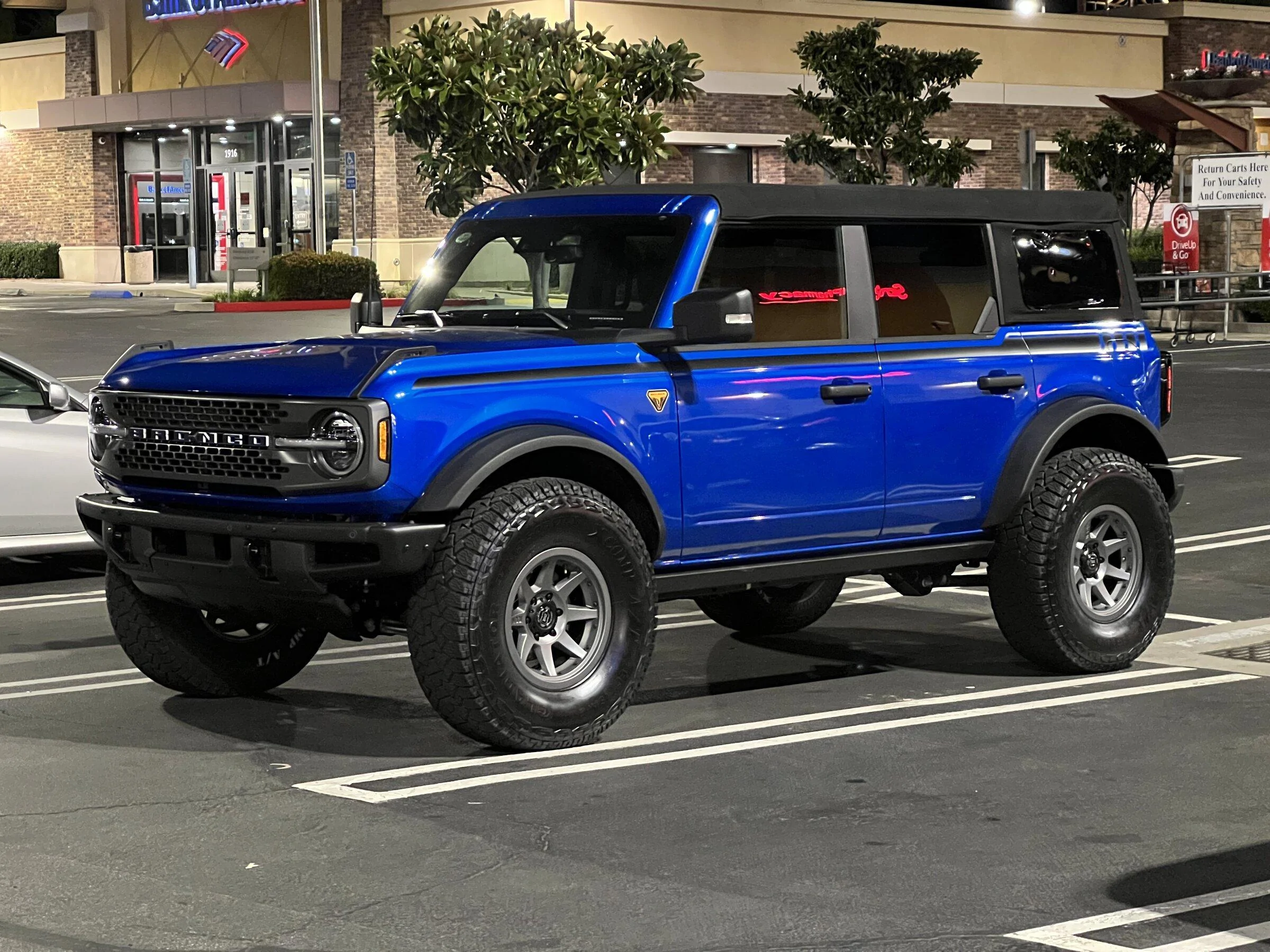

Wheels directly from Icon and tires directly from Gladiator.
Wheels are the Icon Rebound Pro 17" Titanium Silver with "zero" offset, in 6x5.5
Tires are Gladiator XComp A/T 37x 13.5 x 17
No rubbing at all even bone stock at full turn lock, but I've been told by Icon that a leveling kit should be used to avoid rubbing under full compression off-road.

I have a BL Sasquatch stock.
My 37’s fit with NO issues of rubbing on the street without a lift. But, the 0 offset wheels help in that regard.

U didnt need a relocation bracket for 37s with the sas package? Does it fit on the stock sas tire carrier or do i need to get a relocation pkg? And do i need to do the 3rd brake light extension? Thank you for any help u can offer
All I needed was the 3rd brake light extension, which had to be slightly modified to make the bolt holes line up. But I also had SAS package factory which helps.

Yes that is what i was asking. Thats good to know. U have the factory rear bumper as well?
Yep! But again this is with 0 offset wheels… which I think are a great choice for 37’s. They just peek out past the fenders a bit, maybe 1/2”.
Perfect. I have rtr 17 inch 0 offset wheels on order sitting out on a boat waiting to be shipped once they can dock and unload. Lol i was looking at some nexen mtx 37s

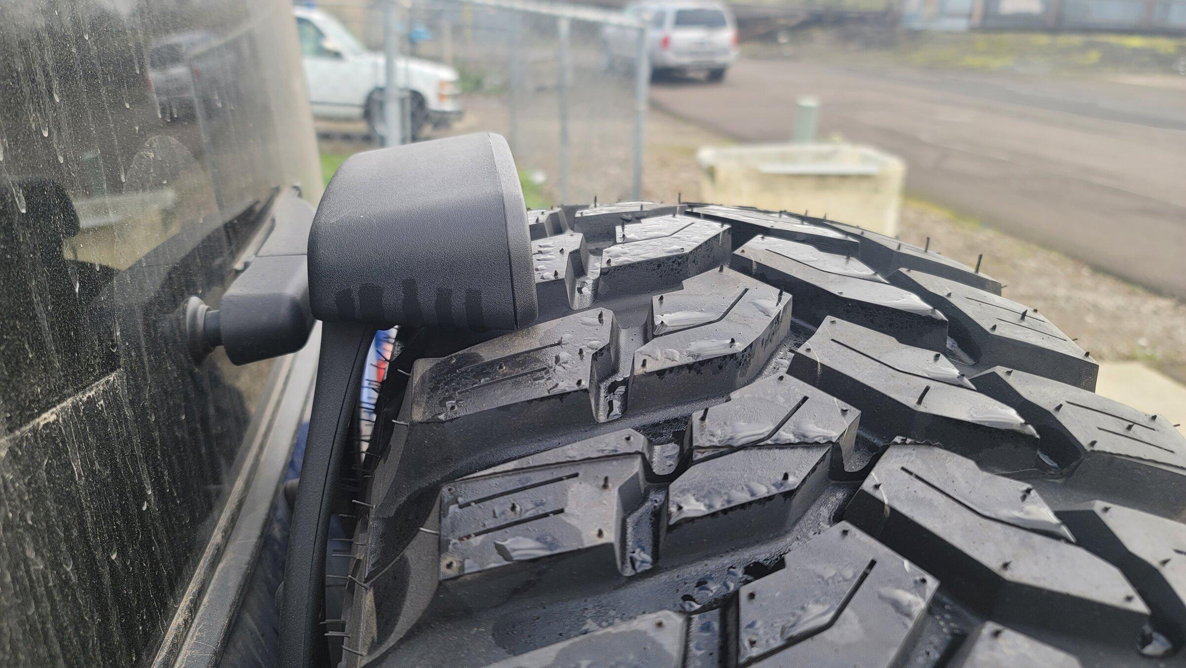

No relocation bracket needed for me 37 fits fine....the SAS brake light bracket is high enough to fit over the 37...it barely touches the tire.
Lots of of folkers will tell you you need to buy something, when you don't.
