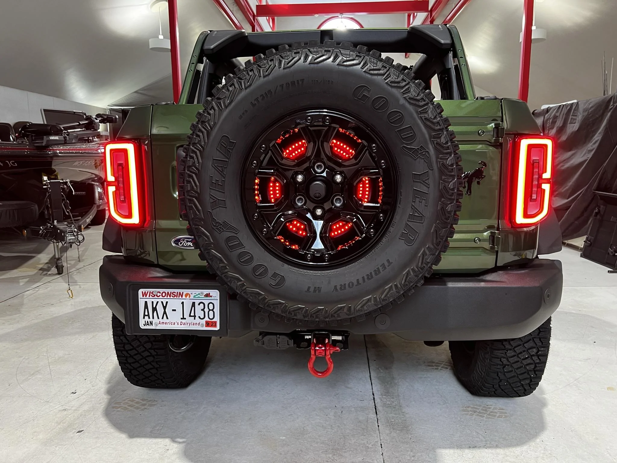

No relocation bracket needed for me 37 fits fine....the SAS brake light bracket is high enough to fit over the 37...it barely touches the tire.
Lots of of folkers will tell you you need to buy something, when you don't.

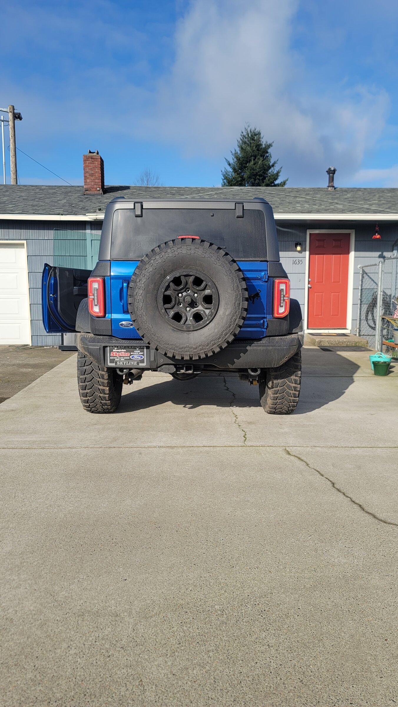

There is a difference between physically fitting, and properly fitting. Although it fits without modification, you actually don’t see the entire third brake light if you were in a car behind the bronco unless it’s a bit higher up.
This is the view from behind the bronco at the height most people in their cars would see it, and this is with the extension. Also a side view.

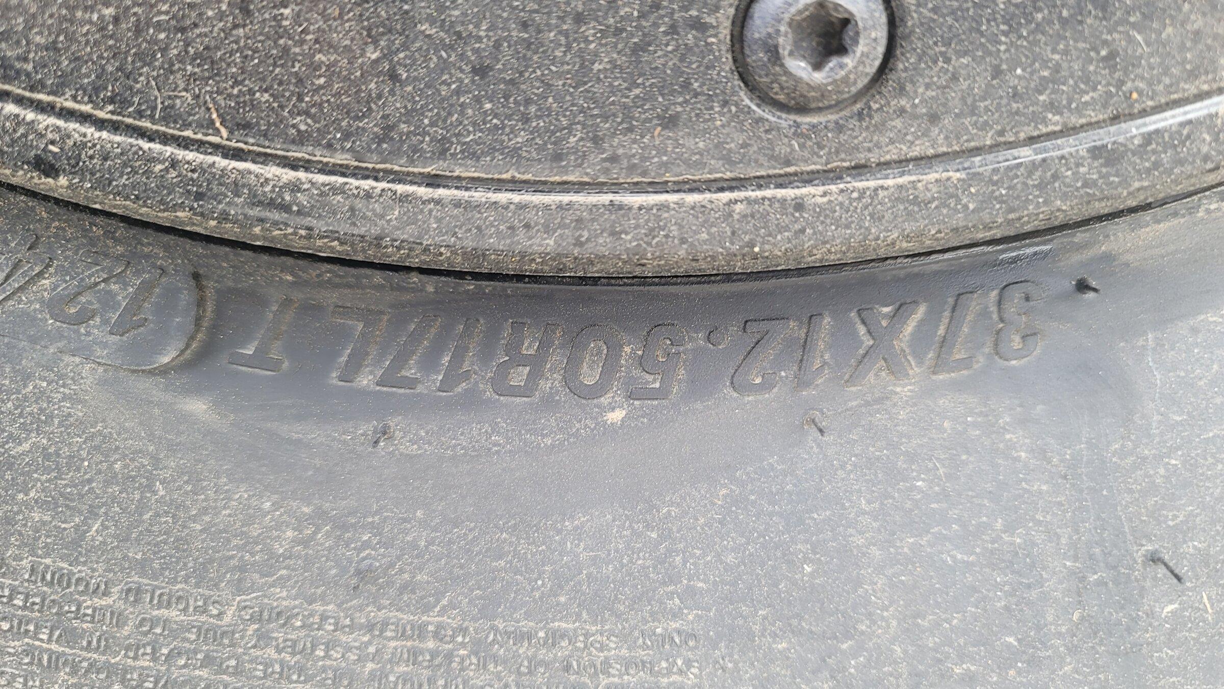

Keep in mind not all factory 37s are truly 37 inches either, some might be 36.7 inches, some could be 37.2, etc.
For the sake of a proper installation, I would still do the extension, it’s super cheap and super easy to install, so why not? Nobody wants to recommend parts you don’t need, but I feel this is a more proper install.

Fair enough....but mine is plenty visible...camera.20 feet back and 3 feet high. I'm enjoying the fact that its a tighter fit with no gap.
Seems like splitting hairs to me?
And I think its ugly anyway, especially sitting up even higher, unsupported by the tire.

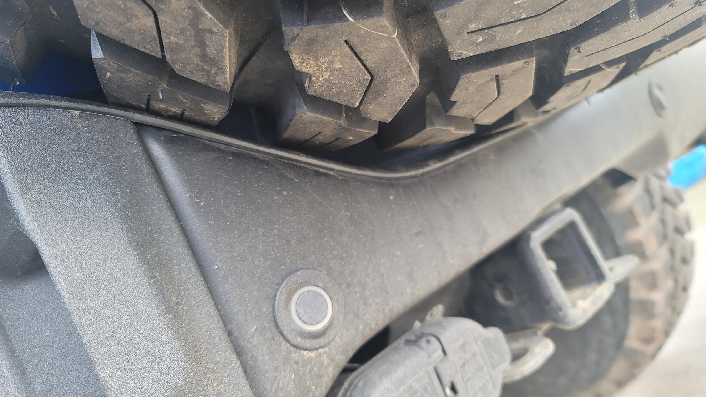

That's correct! No extension needed. I added rubber stops between the 3rd brake light (near top) bracket and tire. It pushes the bracket out from the tire so it doesn't rest on the tire.
