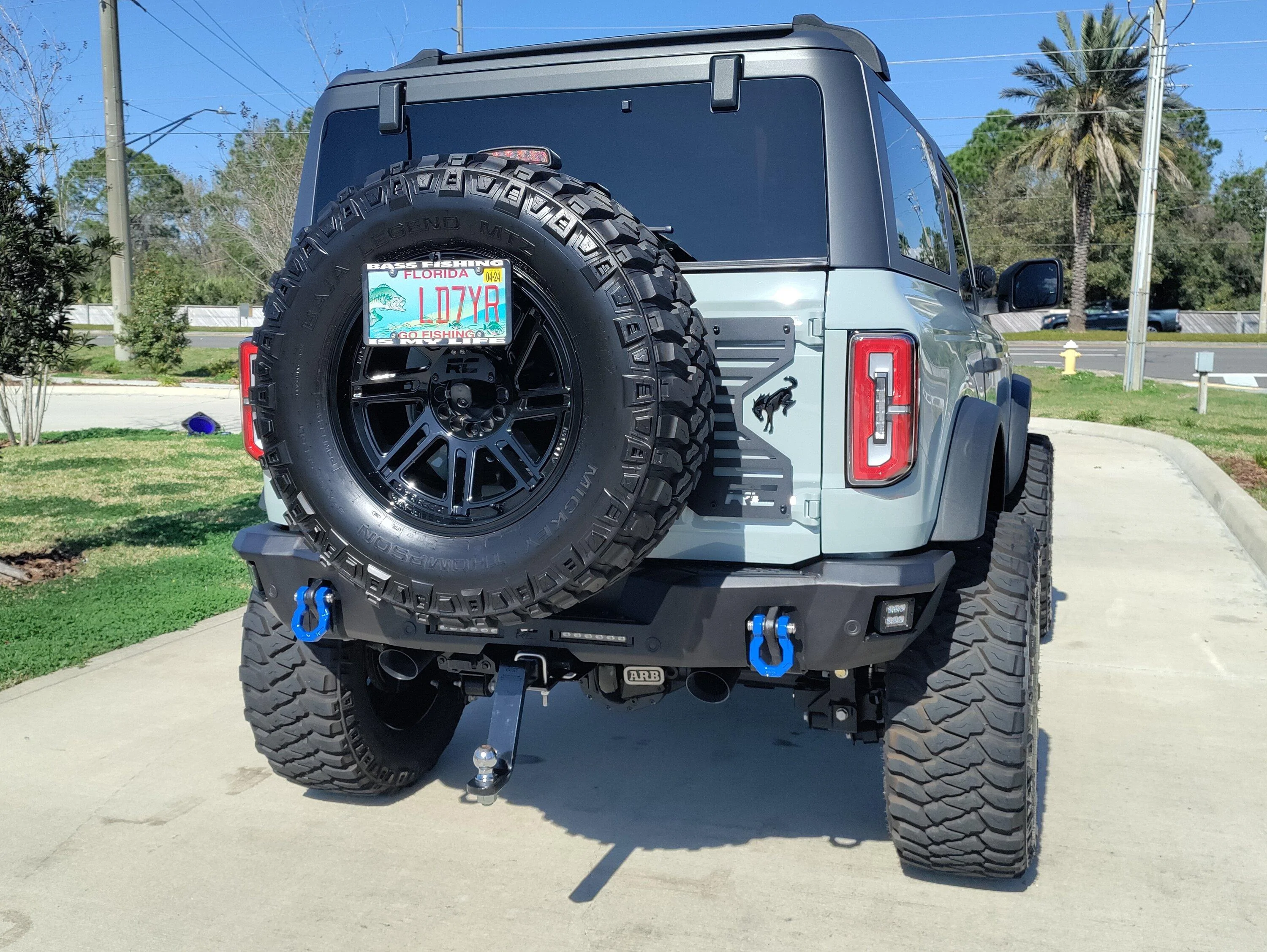

I have no idea about a tailgate bending, very improbable but could cause strain on the hinge pins while opening. I ran a 37" and a 20x10 rim spare on my BB for about 5 months. The only thing I did during that time was buy the Rough Country spare tire relocation kit which include the spare tire relocation base plate and brake light extension. But after that time I went ahead and purchased the reinforcement plate to complete the kit. I did this only because I got tired of the reverberation from hitting bumps at speed. I had no tailgate damage. The reinforcement plate helps spread the weight of the 37" spare throughout the area from door hinges to base plate instead of on the center of the door. Now I have zero reverberation after the install of the reinforcement plate.

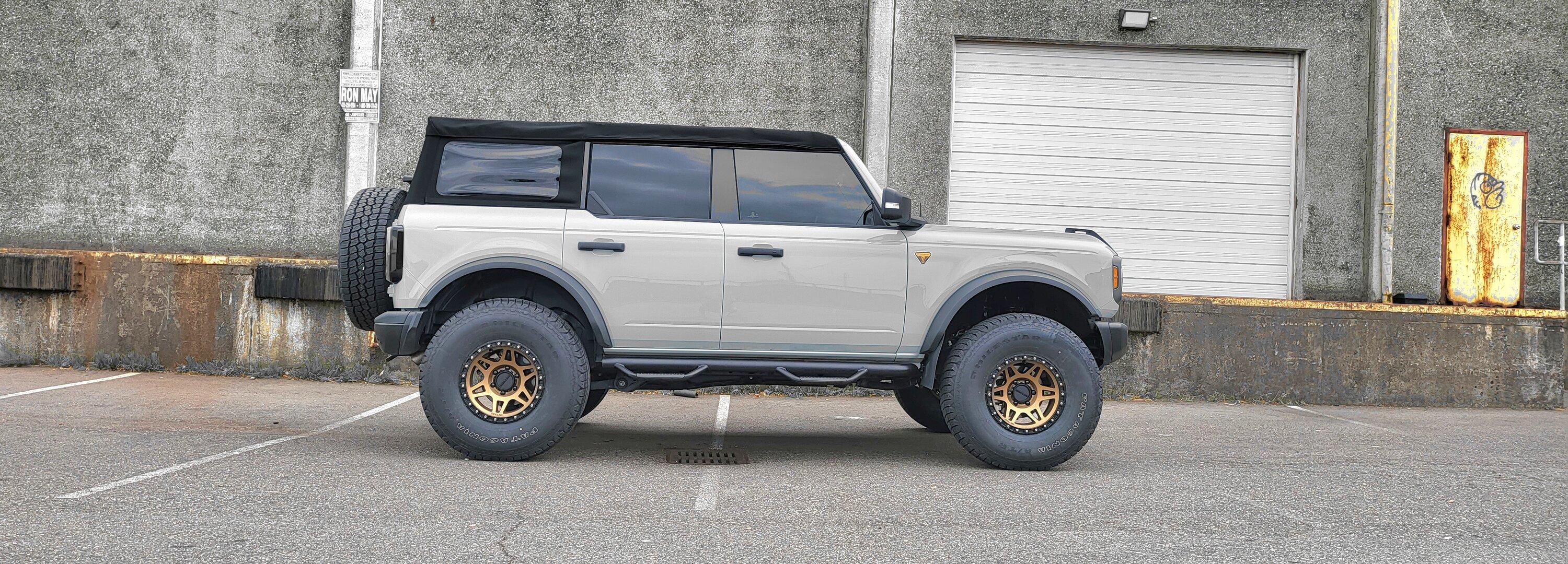

My setup is 16lbs heavier than stock sasquatch wheels and tires. I'm running methods 17-9/-12 & 37x12.50R17LT patagonia AT/R. I run a rough country brace just for peice of mind.
