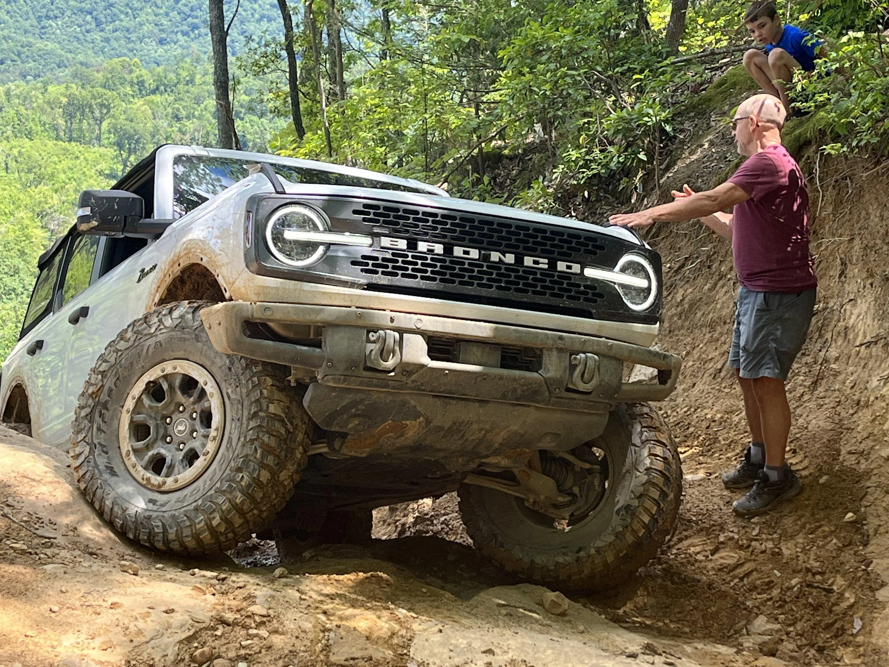

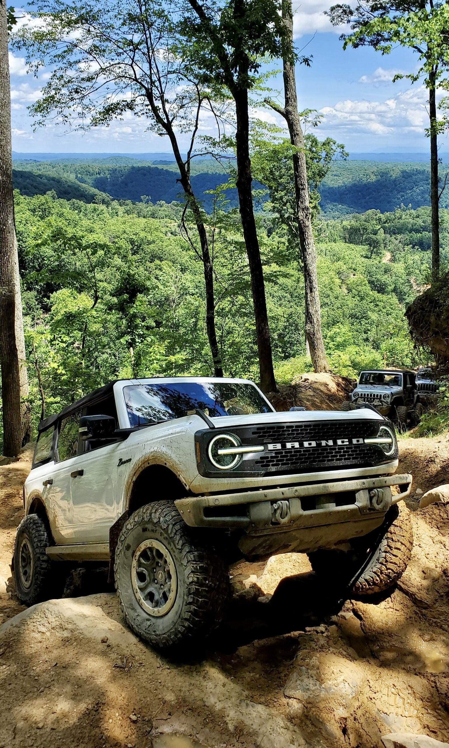

As you can see in this build above I scratched the wheels wife said she wants nice looking ones for mall crawling so the goal will be to buy a new stock set add the 37s on them then put 39s on the scratched wheels just for hitting the trails.
((This is what it looks like on the 37s))
