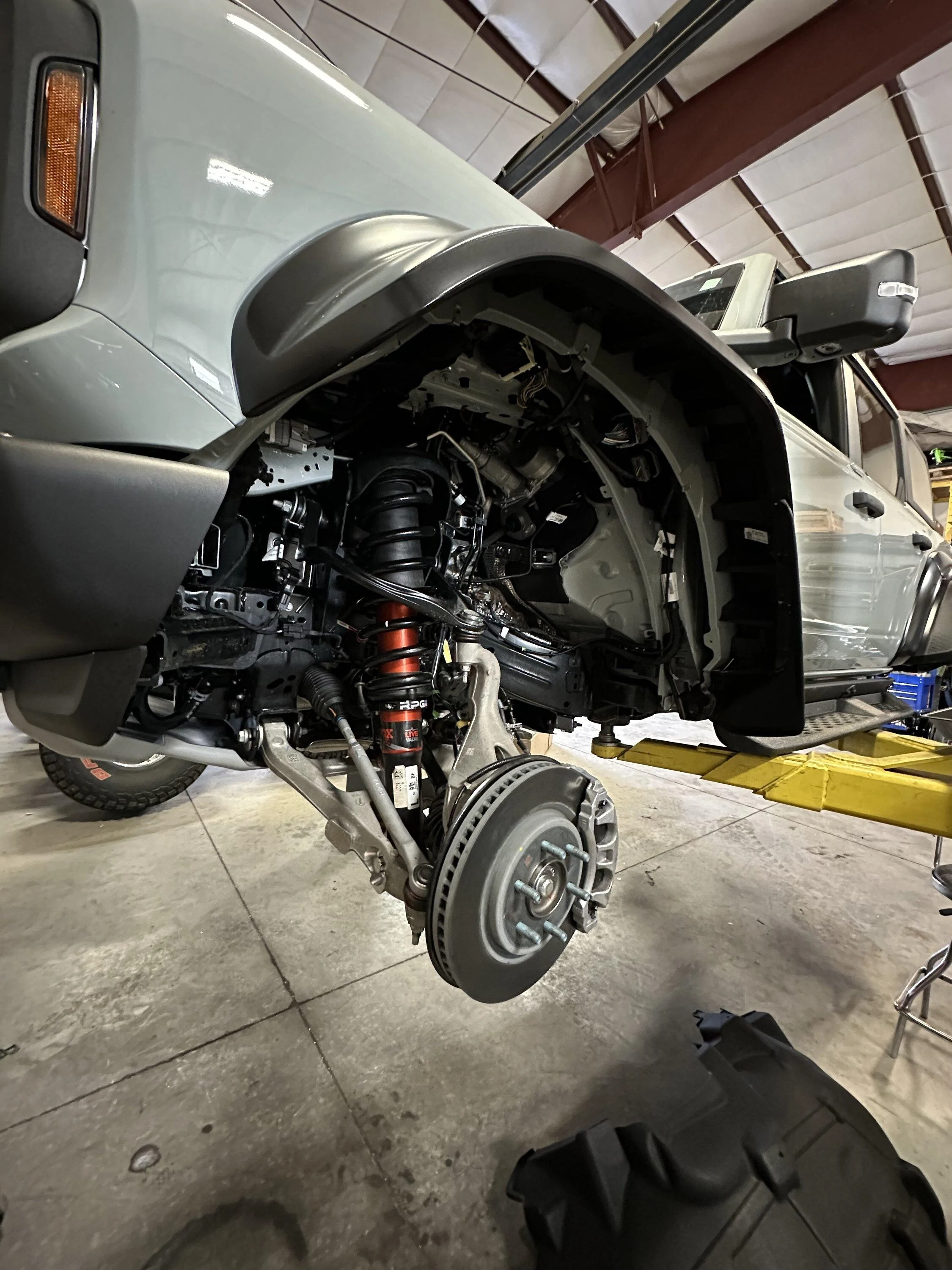

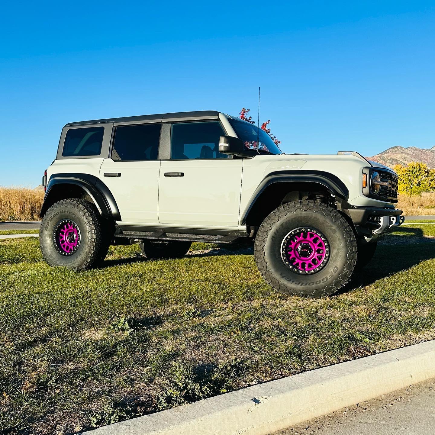

I put 39" BFG KO2s on. Lifted it with RPGS coil collars. Steering wise they they didn't rub too much stock height. But at full bump they did.
Ford Bronco 39" BFG KO2 tires + RPG Coil Spring Perch Collars on Bronco Raptor 311579532_5613852995346760_6556696200219114678_n

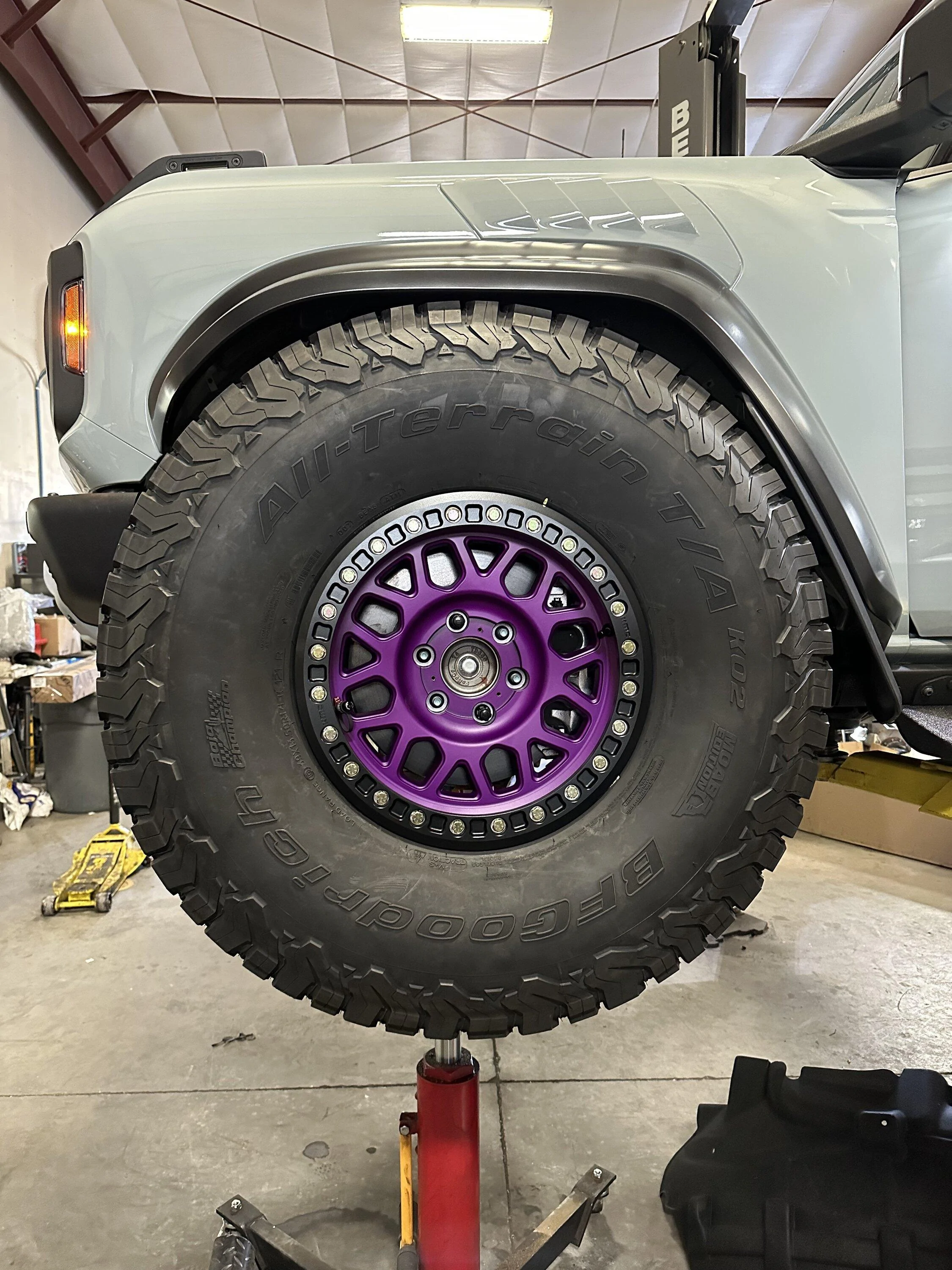

Here are more pics, fully tested clearance and measured for new really go fast fox shocks. I put on the RPG Coil collars until the new fox coilovers show up.
Ford Bronco 39" BFG KO2 tires + RPG Coil Spring Perch Collars on Bronco Raptor f87107be-6317-4b24-88e2-b2202d29cdd6-

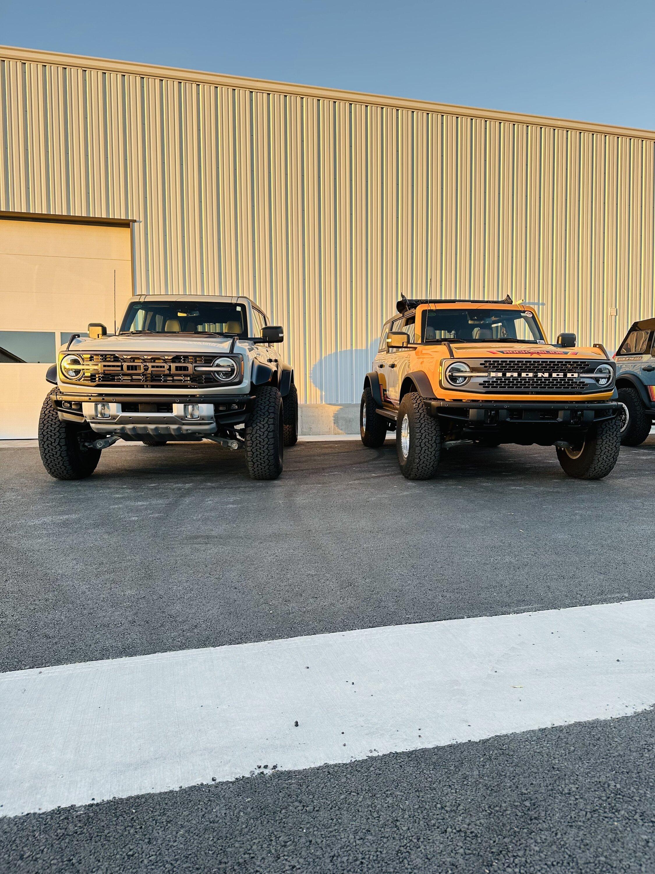

This is it next to a bronco with 37S
Ford Bronco 39" BFG KO2 tires + RPG Coil Spring Perch Collars on Bronco Raptor img_1075-

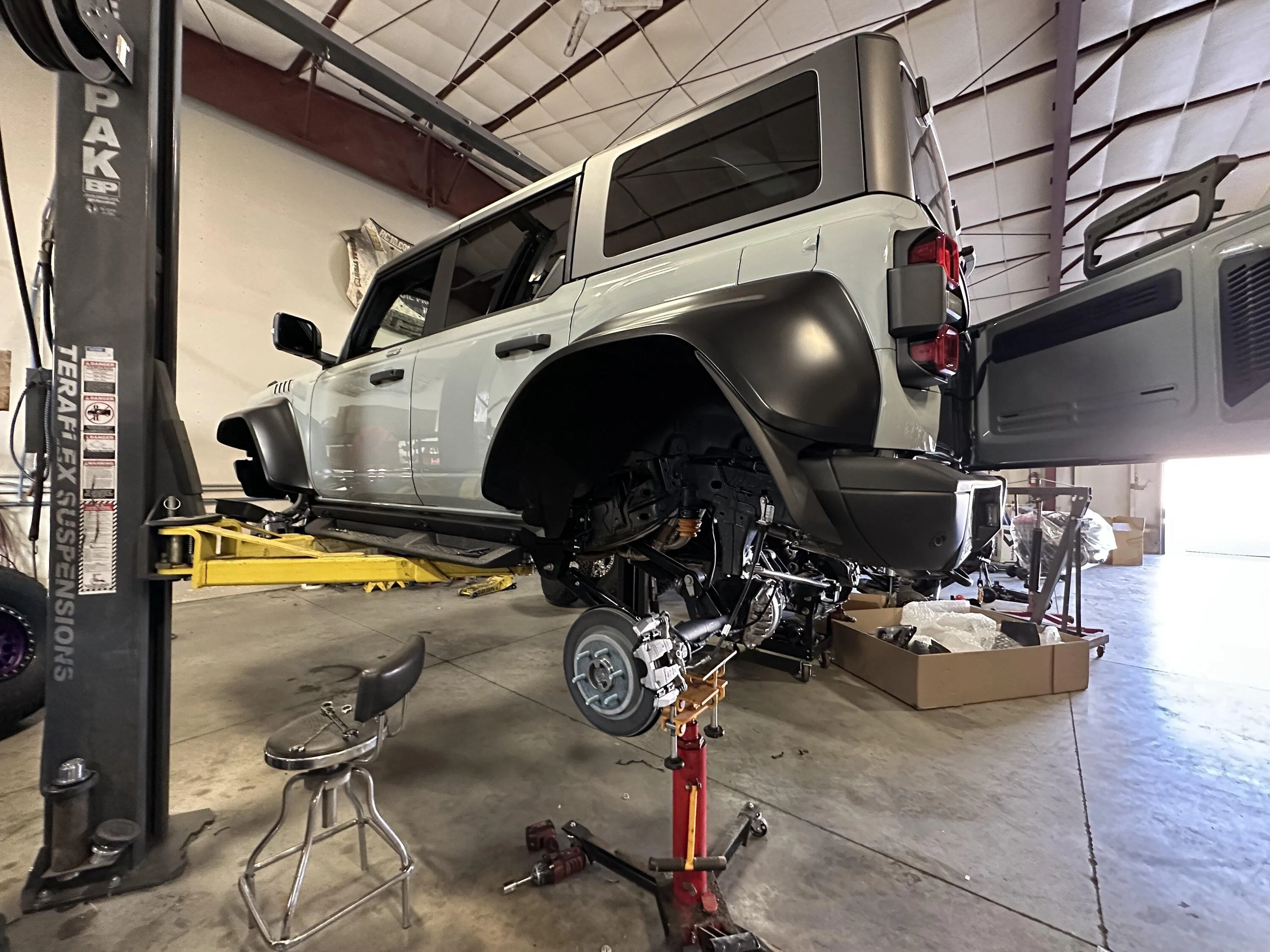

here is full droop and full stuff,
Ford Bronco 39" BFG KO2 tires + RPG Coil Spring Perch Collars on Bronco Raptor img_1034-
Ford Bronco 39" BFG KO2 tires + RPG Coil Spring Perch Collars on Bronco Raptor img_1040-
Ford Bronco 39" BFG KO2 tires + RPG Coil Spring Perch Collars on Bronco Raptor img_1055-
Ford Bronco 39" BFG KO2 tires + RPG Coil Spring Perch Collars on Bronco Raptor img_1043-
Ford Bronco 39" BFG KO2 tires + RPG Coil Spring Perch Collars on Bronco Raptor img_1054-
Ford Bronco 39" BFG KO2 tires + RPG Coil Spring Perch Collars on Bronco Raptor img_1058-

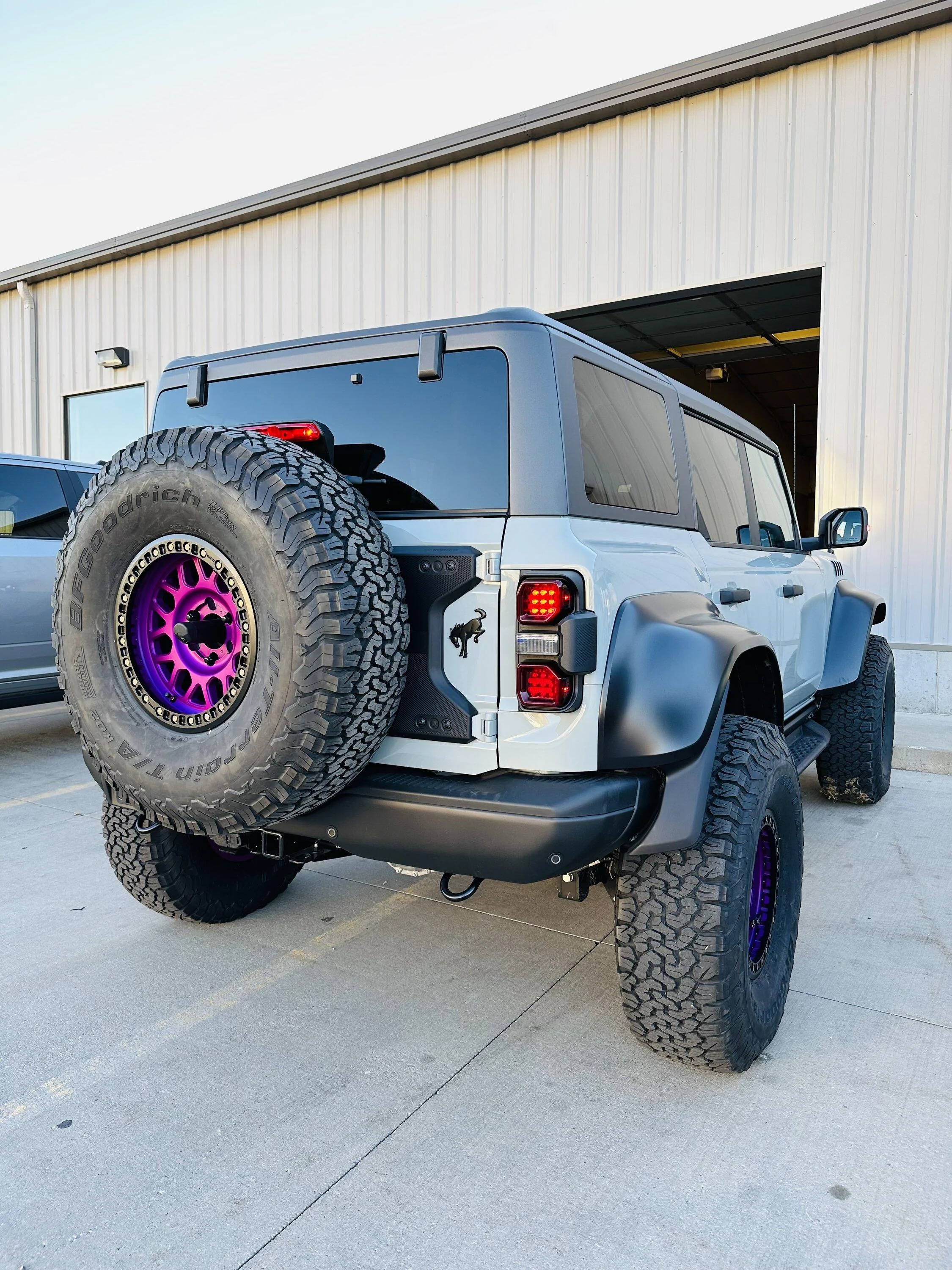

And yes the 39 fits on the tire carrier,
Ford Bronco 39" BFG KO2 tires + RPG Coil Spring Perch Collars on Bronco Raptor img_1069-

Yes keeping them on, the past tense was I put them on over a week ago. Here are more pics, fully tested clearance and measured for new really go fast fox shocks. I put on the RPG Coil collars until the new fox coilovers show up.
Wheels are 0mm offset 4.75" backspacing.
Ford Bronco 39" BFG KO2 tires + RPG Coil Spring Perch Collars on Bronco Raptor F87107BE-6317-4B24-88E2-B2202D29CDD6.JPG
Ford Bronco 39" BFG KO2 tires + RPG Coil Spring Perch Collars on Bronco Raptor IMG_1075
Ford Bronco 39" BFG KO2 tires + RPG Coil Spring Perch Collars on Bronco Raptor IMG_1034
Ford Bronco 39" BFG KO2 tires + RPG Coil Spring Perch Collars on Bronco Raptor IMG_1040
Ford Bronco 39" BFG KO2 tires + RPG Coil Spring Perch Collars on Bronco Raptor IMG_1055
Ford Bronco 39" BFG KO2 tires + RPG Coil Spring Perch Collars on Bronco Raptor IMG_1043
Ford Bronco 39" BFG KO2 tires + RPG Coil Spring Perch Collars on Bronco Raptor IMG_1054
Ford Bronco 39" BFG KO2 tires + RPG Coil Spring Perch Collars on Bronco Raptor IMG_1058
Ford Bronco 39" BFG KO2 tires + RPG Coil Spring Perch Collars on Bronco Raptor IMG_1069

There is no rubbing after the lift. Before it was lifted it would rub at full bump but added in extra bump. I used Gen 3 lift collars from RPG, I used the one they list as 1.5" lift for the front and used the 2.25" for the rear. That listing is for the front of a Gen 3 raptor. On the bronco this lifted it pretty equally all the way around about 1 7/8". I would not put any bigger spacer on the front or rear it will take the shock out of its ride zone and out of the bypass zone and it will ride like crap. The spacers used Kept it in the ride zone and the bypass happy and it still rides like it did stock. The new shocks will still have live valve on them.

Ride quality is good and like it was stock, but I did the 1.5" collar on the front and kept the bypass and shock in the ride zone. I did the 2.25" collar in the rear and that put the rear just at 1" higher than the front. But when I put in the dometic fridge and a few other things it sits level. Looking at the cad model of the shock and where the bypass tube is and ride zone and after measuring ride height the 2.25" coil collar on the front would take the shock out of its ride zone.
I have been very happy with it ride and drive quality wise.

Do you have a side view shot of the 39" spare on the tire carrier. Looking at it I cant visualize how it doesnt hit the 3rd brake light. Also what offset are your wheels?
Thanks
