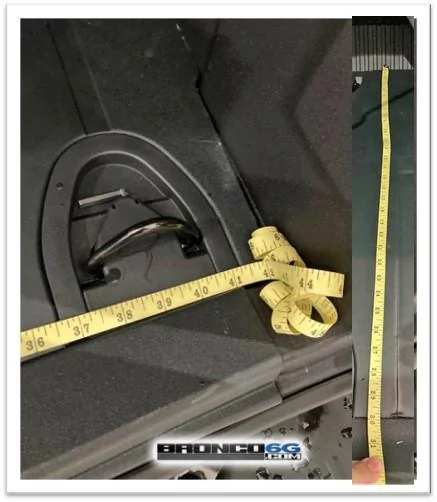

Admiring @BroncoUnicorn nice work prompted a question about a 3rd row seat add. I thought it would be a useful thread for future searches.
(2) Ford cargo security drawer installed in a 2-door Bronco with rear seat delete | Bronco6G - 2021+ Ford Bronco & Bronco Raptor Forum, News, Blog & Owners Community

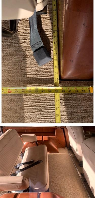

Made me think of strictly the dimensions involved so I took the 4D rear cargo and and EB rear seat to see if it was possible. Well, yes, with only about 6-7 inches for foot/leg room it would be tight, but possible - all safety implications and considerations aside. The cool thing about an EB rear seat is that it is deck mounted so the application would be similar.

So, I just measured my wife's 2016 explorer third row, the seats are 39.5"-ish installed width. With some custom seat brackets. They would fit beautifully. Plus if you are handy enough, you could even maintain the folding capabilities. I'm only 5'10"ish but, I fit in the third row comfortably. So even if the leg room was less than stellar, I'm sure some sub 5' kids would be perfectly fine. Keep in mind though, DOT approval is not existing. But, from when I asked a DOT officer about this very subject years ago. A bolted down seat, roll over protection, and 3pt seat belts anchored to structural points of the body, Is sufficient. Keep in mind, this would be at your own risk. The design of the body may have that area calculated as a crumple zone. But being a BOF design, I wouldn't worry too much. Besides, odds are, getting rear ended would likely be a car driving under the rear bumper. Or if it is a larger vehicle, it's a steel frame and the load would be on that first during an accident.
So maybe, a beefy bumper, sandwiched 12-14ga plates for the seat bolts and belt anchor points.
