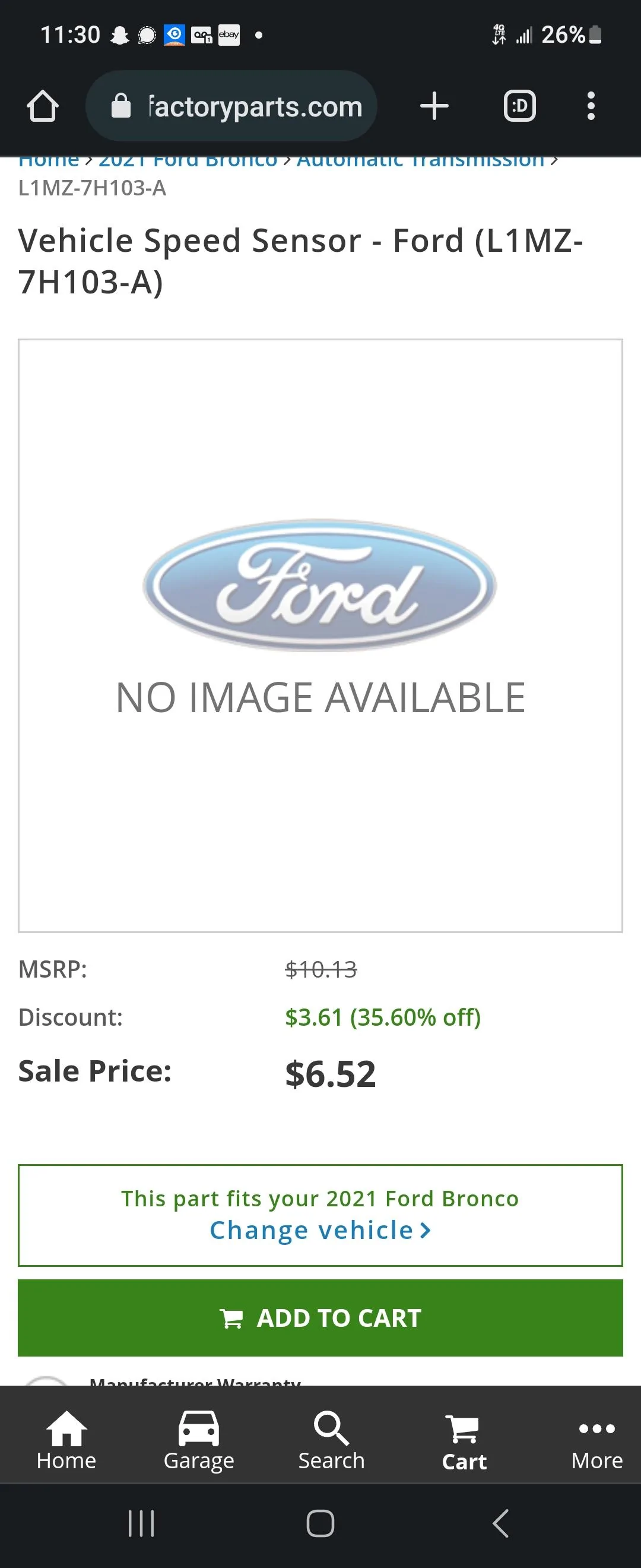

Here is the part number in question. It is the vehicle speed sensor or "output shaft sensor."
Ford Bronco 4.46 vs 4.7 Gear Ratio Discussion Screenshot_20221027_113025_Chrome
MT doesn't have that. OSS is for auto trans to calculate slippage. VSS is still a signal from ABS. Seriously try disconnecting your ABS and drive it
