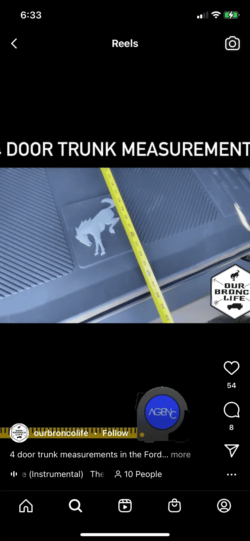

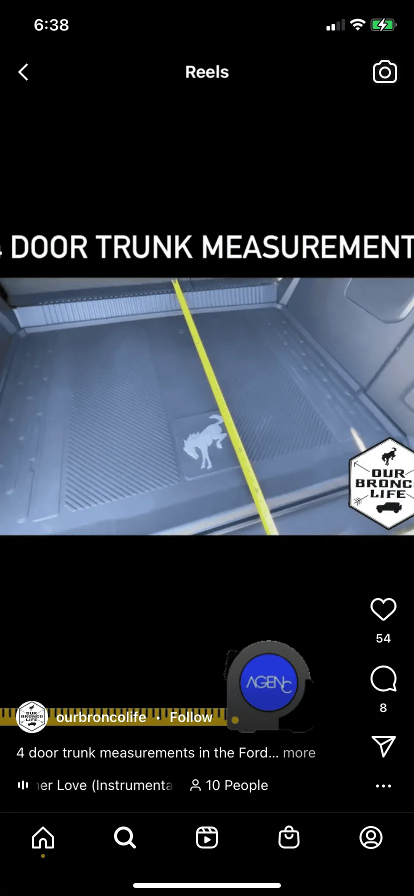

checked to see if this was posted here, and it was not.
32” depth becomes 37.5” when you include the hump. Inline with estimations but good to see official dimensions.
Also means if the plastic hump plus the little felt ledge leading up to the backseat is in total 5.5” then the height of the hump is probably closer to 4” than 5”

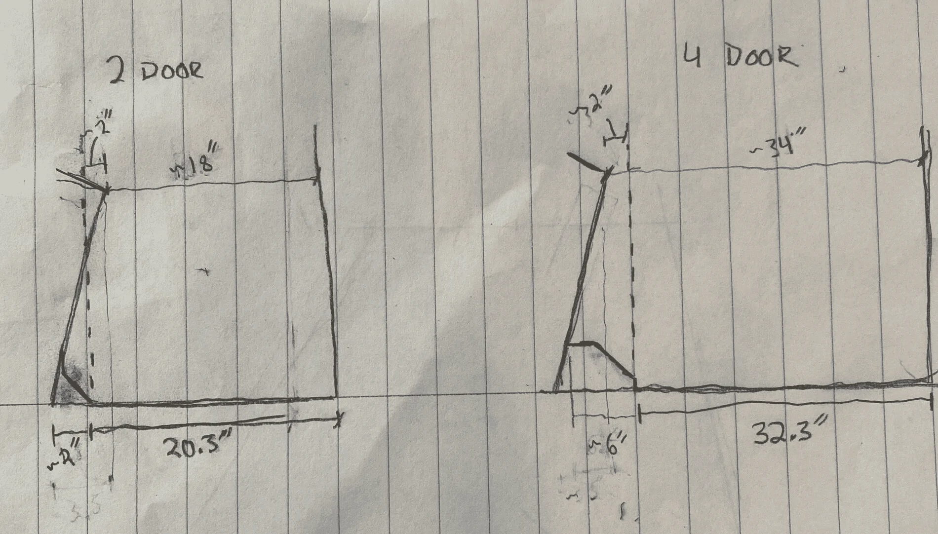

but isn't the hump space take up by any recline of the backseat?

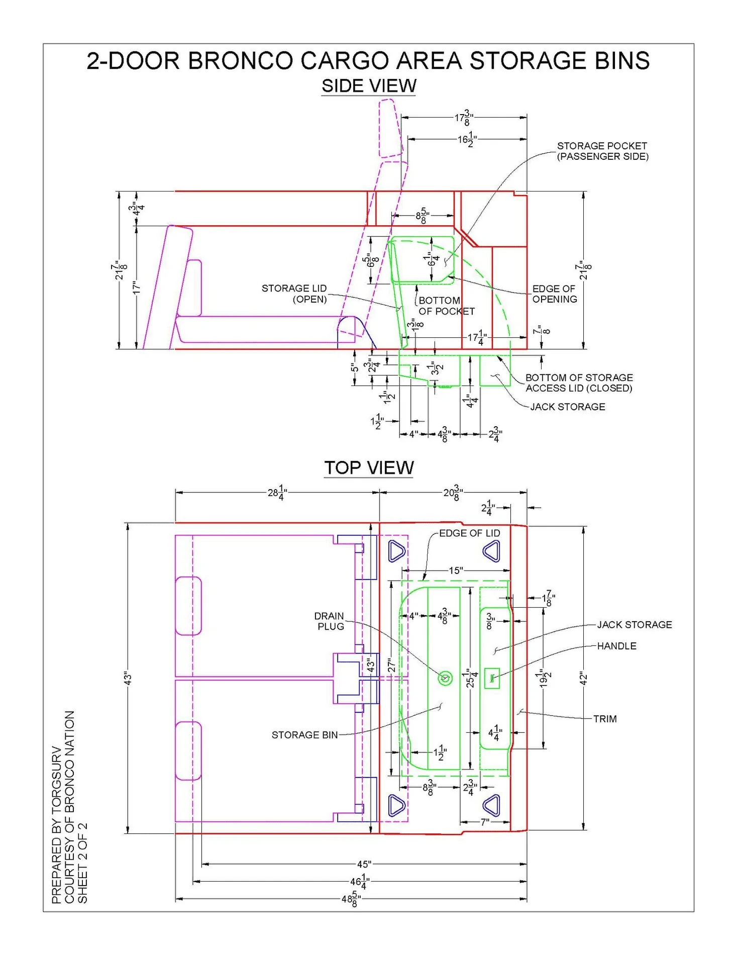

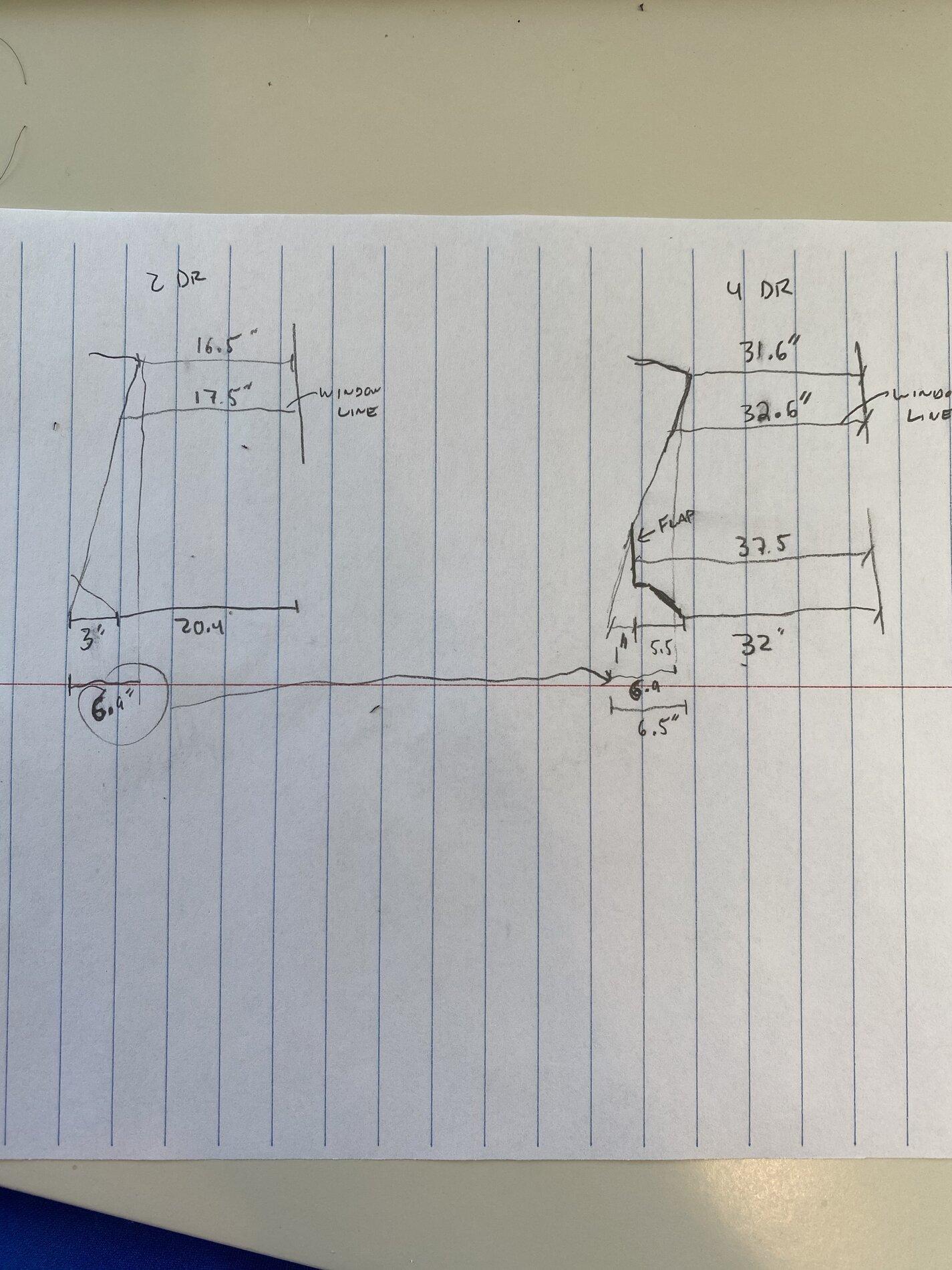

Well, that was my estimation before we got the exact dimensions on the 2 door. now that we have that.... scaling the above photo, the 2 door seat bracket is 3" deep. Per the dimensions, 20.4" + 3" = 23.4" (2 door depth to seat back at load floor). Cargo depth at the top of the seat is shown as 16.5". So the recline of the seat is the difference, 6.9". Carry that over to the 4 door....see below...I am assuming there’s another inch behind the 4 door seat flap given the angle of the seat. The 2 door depth changes by an inch when comparing the window line height with the seat back height, so that seems like an appropriate adjustment. FYI the 2 door doesn’t have this flap
.so yes you lose almost all of the extra space
HOWEVER, if you think logically, all vehicles have a sloping rear seat, so apples to apples, its similar to any other cargo hold thats 37.5" deep at the load floor.
