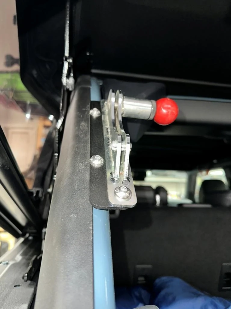

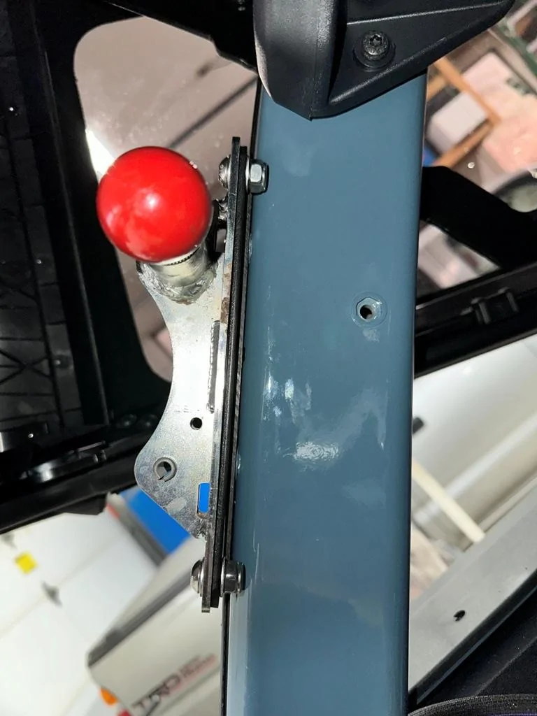

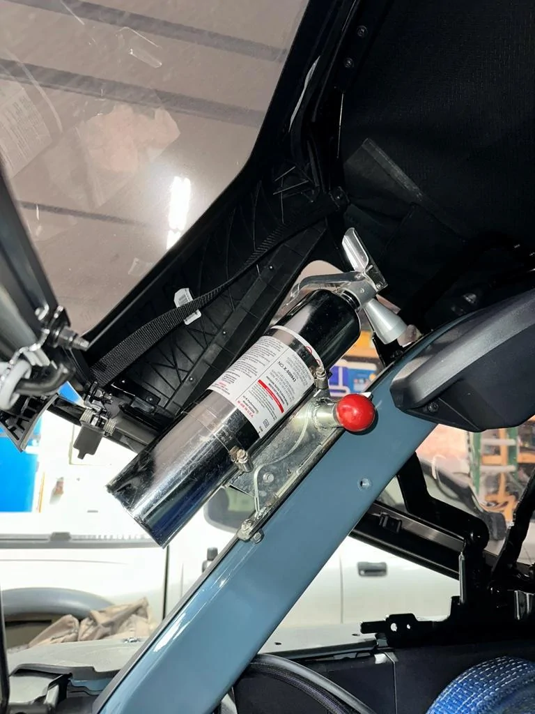

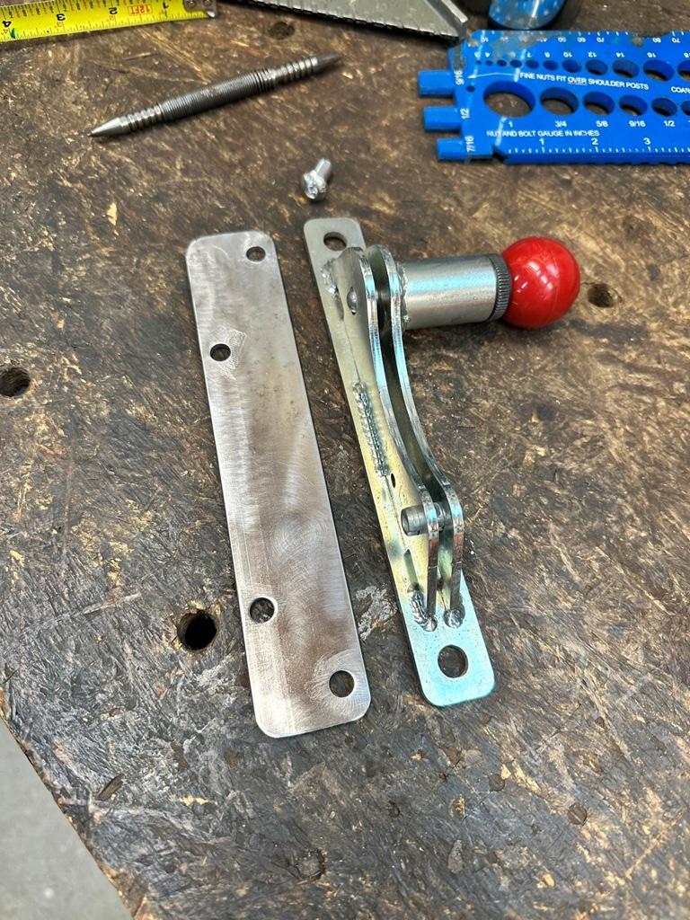

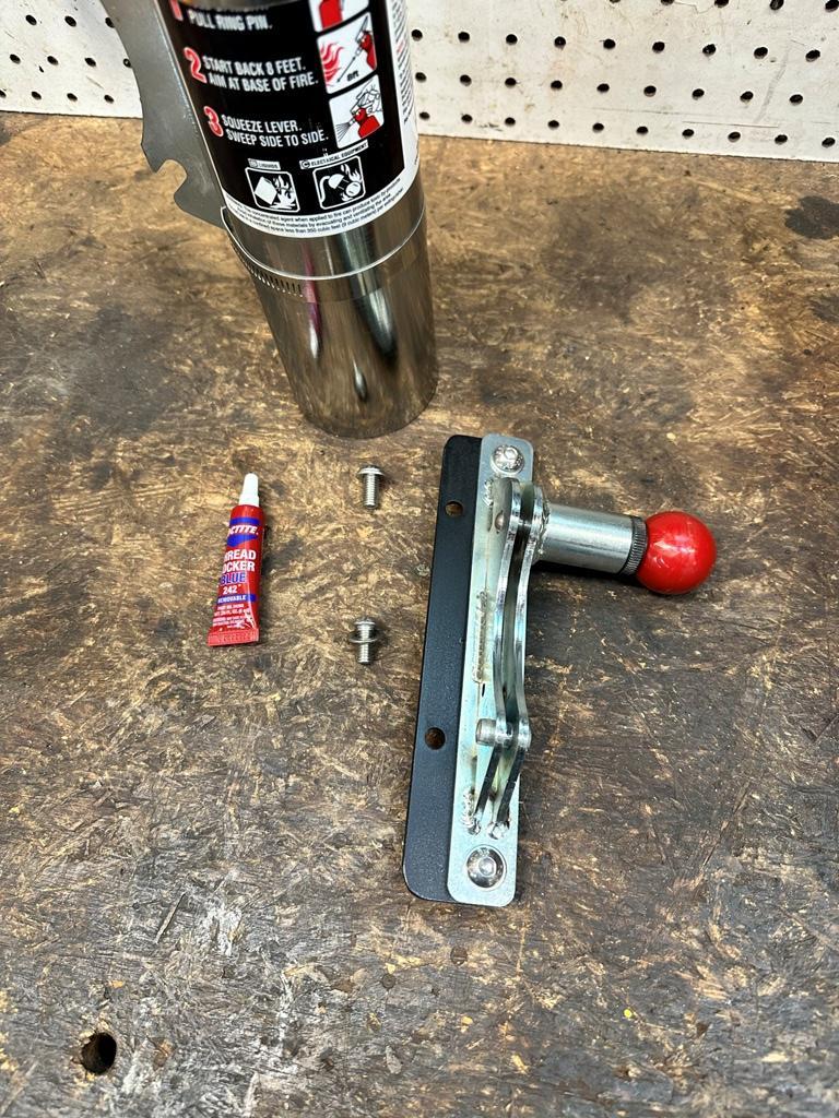

I just fabbed up an aluminum plate to offset ours inward slightly.
Ford Bronco 4-door rear roll bar fire extinguisher solution? 8BsUghq
Nice work! I already have the flat back quick release bracket - so I just need a means to mount that to the existing accessory mounting points.

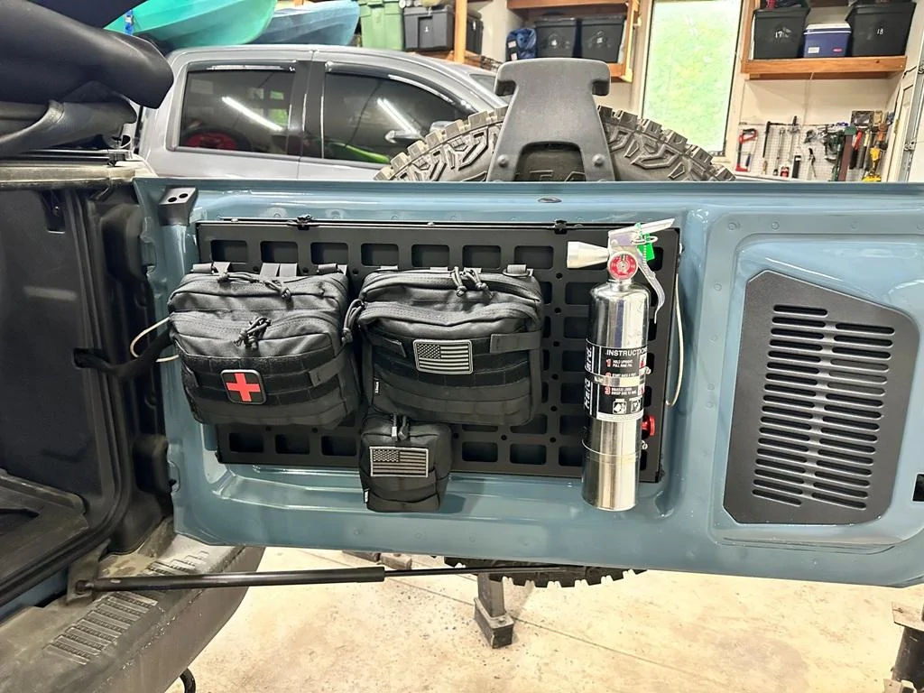

Well....after measuring a couple of times, we went to drop the top all the way back yesterday and one of the bows on the soft top was hitting the fire extinguisher and preventing the top from going all the way back 🤦‍♂️.
So I ordered a new aluminum quick release mount off Amazon and mounted the fire extinguisher to the tailgate table.
This is perfect. I will be using your idea. Thanks!

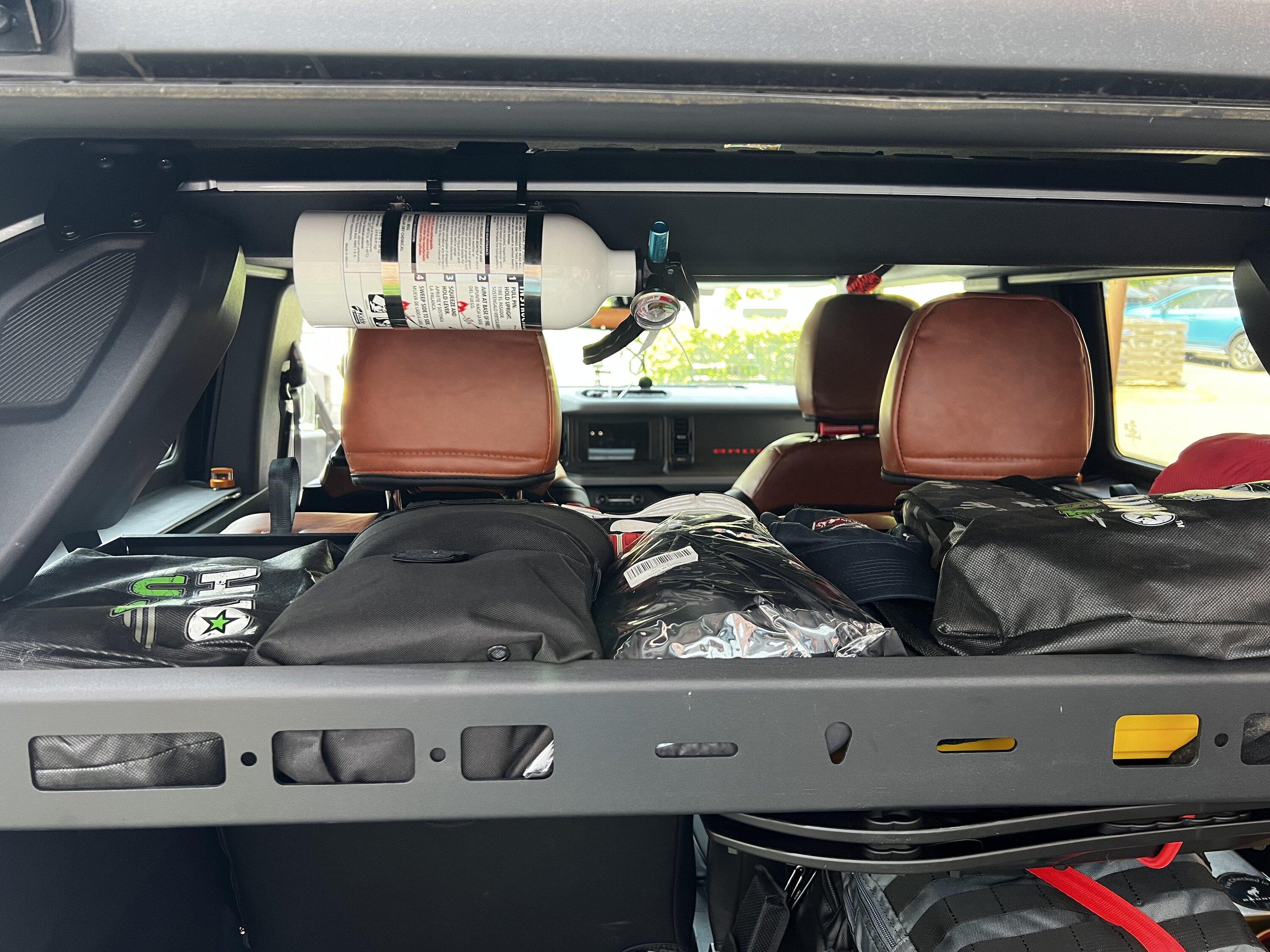

I have a 2 door, but I like where I mounted mine out of the way
