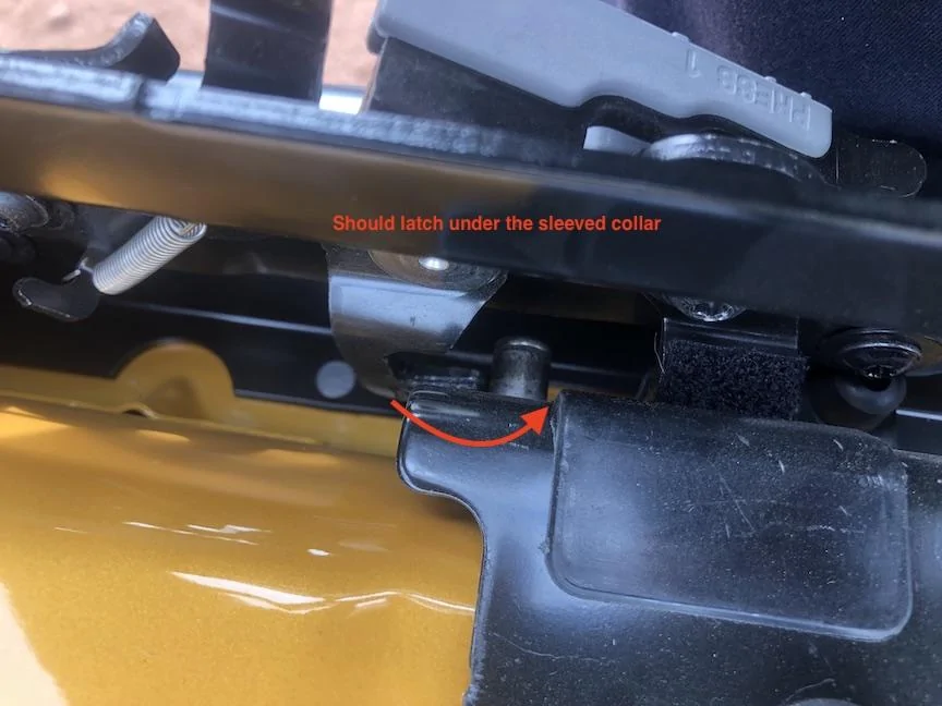

The latch on the driver's side of my soft-top at the B pillar won't lock in place - the "J" shaped hook can't get underneath the sleeved collar no matter how much pressure I put on it - it just seems like there isn't enough room.
I've heard of instances of people driving w/out this latched at highway speeds and the top getting blown completely open, and I certainly don't want this to happen.
Anyone else experience this or know of a fix?

i had this- i loosened the bolts holding the piece that it latches to and then latched it and then tightened them down- it gave me the few millimeters i needed to make it work. i still have to push it really hard to make it latch which i don't like but it's working now

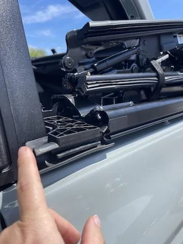

So I had this same issue and unfortunately my top ended up getting blown up in the wind and bent. It broke two pieces off from the side window seals also. Also when I take it down completely it does not latch. My dealer I went to said they will not warranty it because they do not want to pay the 11k they have to in order to get the part. They said they see it is bent but they tried it 8 times and it latched fine. I told them I would come and show them how it does not for me. They left before I got there. So now I have a new vehicle with a bent top that the company will not fix. Ford gave me a case number but thats it. I sadly am trying to find the parts and fix it myself and keep a bent frame. And cancel my extended warranty. Clearly they don't care about customers. They had the nerve to tell me not to have the top off on windy days or the expressway!!

after i pushed really hard on the lever and loosened the bolts and moved it a tiny bit it works 100% easily now for me. also, when it sits in the hot july sun it works 100% because the metal gets softer from the heat
Thank stinks - especially the part about not having the top partially opened on the express way, when I believe their is Ford documentation stating it's perfectly fine to drive on the freeway that way (as long as the B-pillar is latched).
Actually, after I got the B-pillar latched, both of the front alignment pins for the A-pillars were out of alignment - about 1/4" too far forward toward the front bumper. I tried putting it in the shade, leaving it in the sun, neither worked to provide enough expansion/contraction in the top to give me enough leeway to have those even get close to their holes.
I ended up unlatching the B-pillar again and was then able to clamp the A-pillar hooks. Now I just have to remember to re-latch that B-pillar whenever I'm only opening up the front portion of the top - definitely not ideal.
