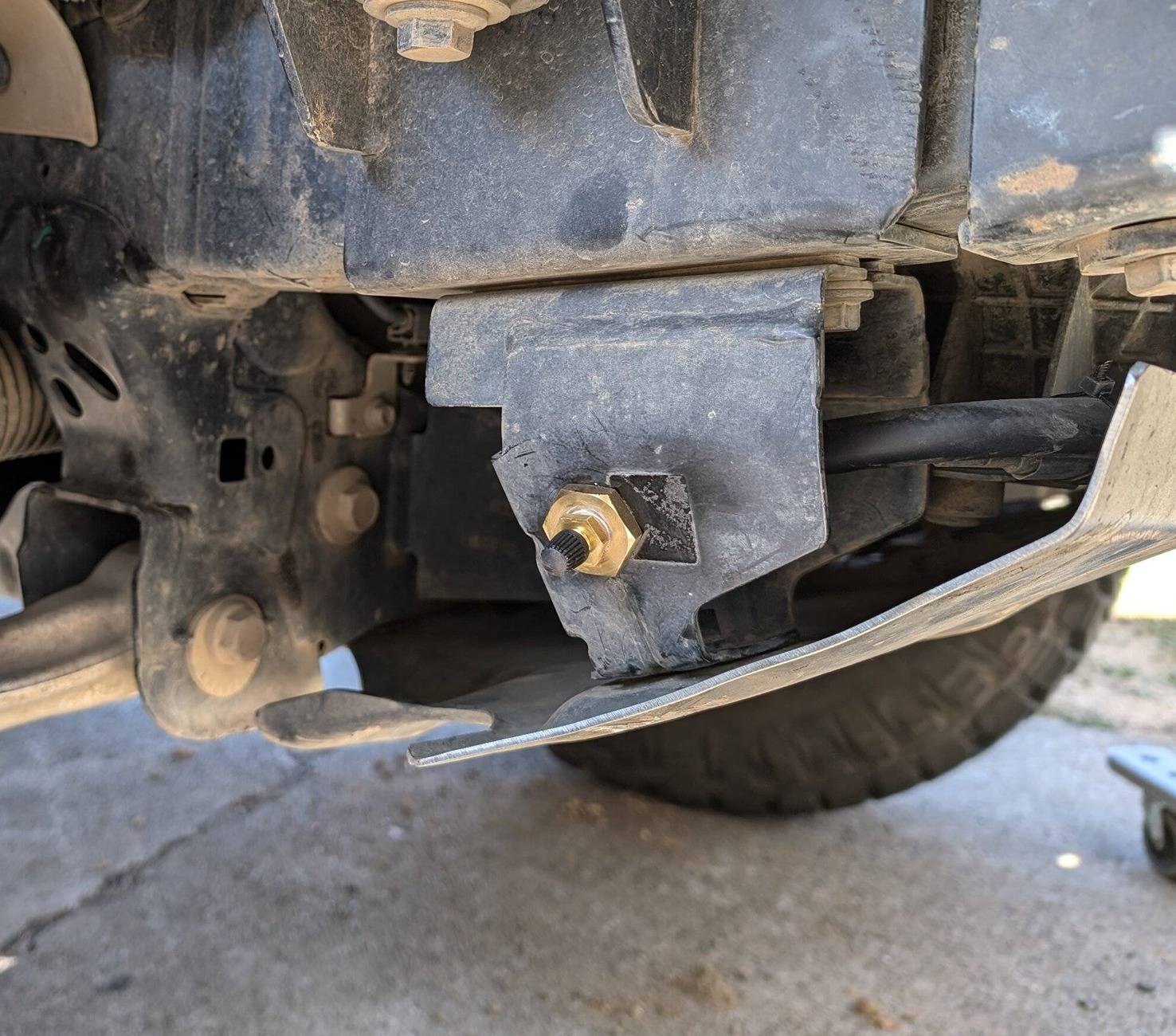

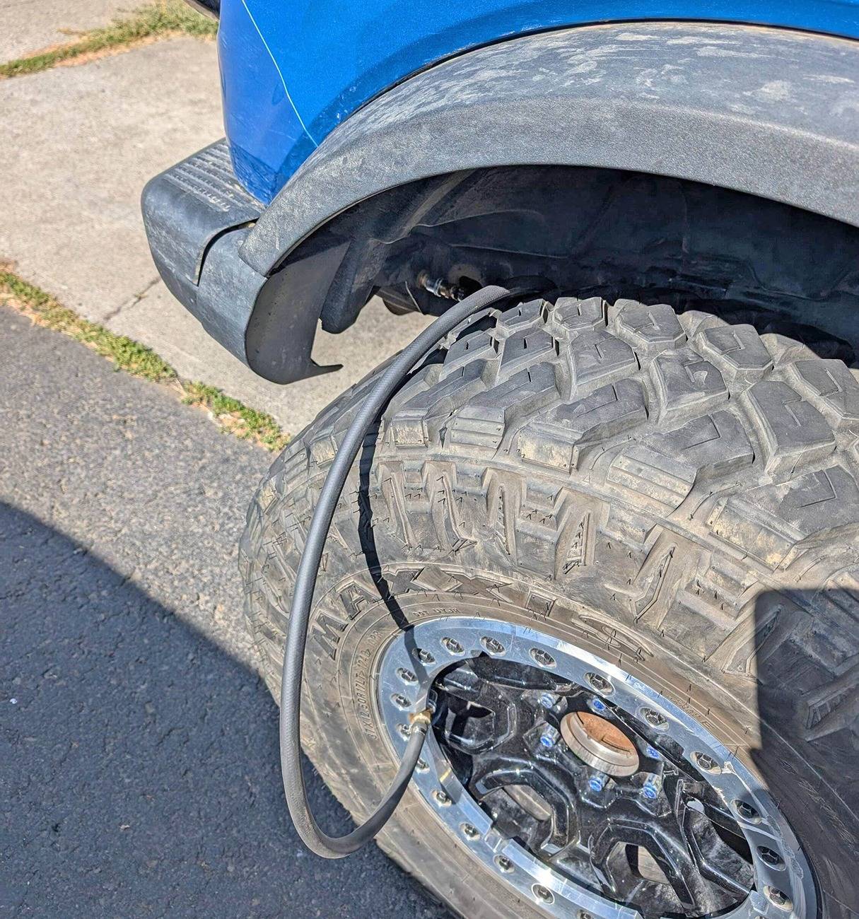

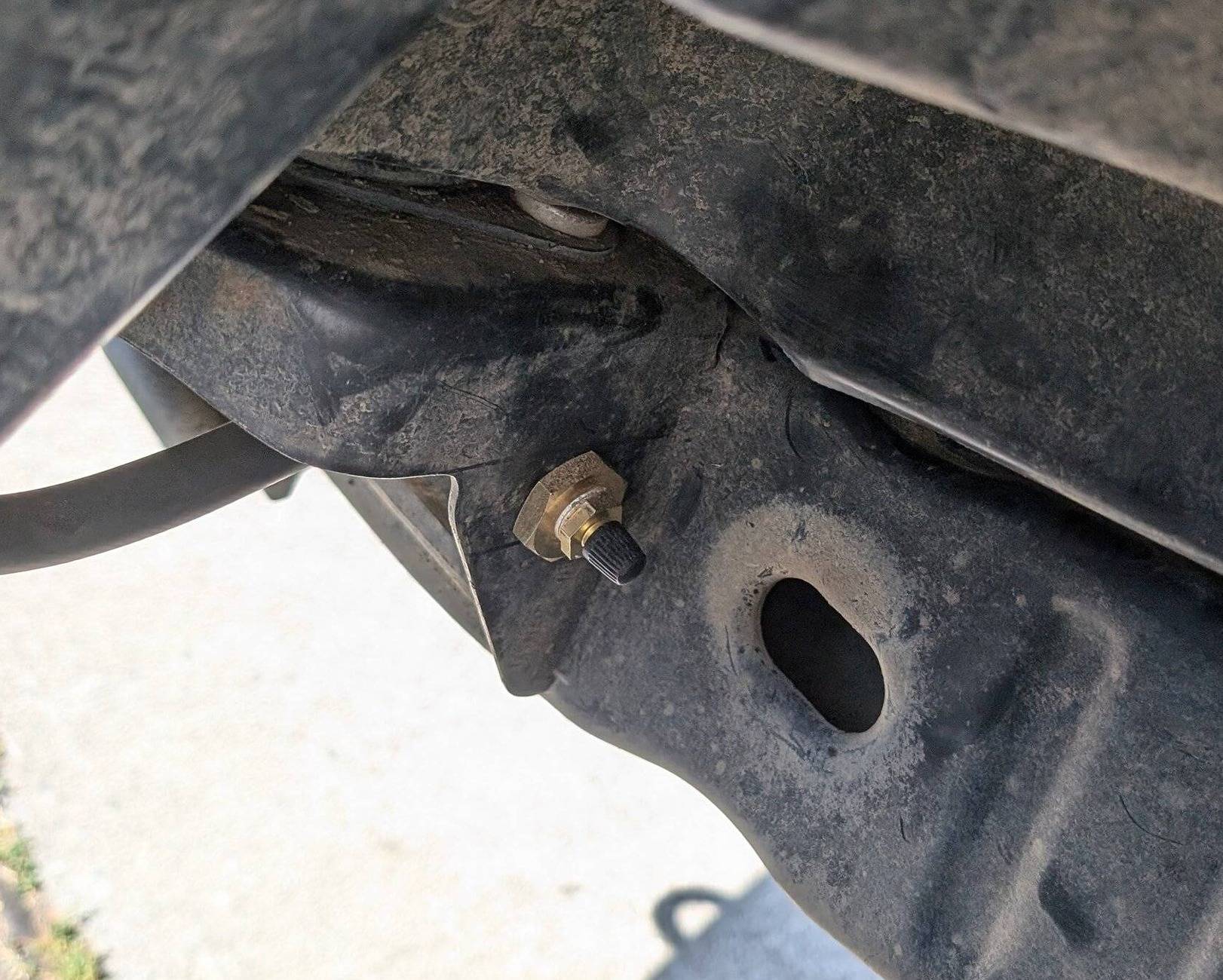

I just built and installed a permanent air hose. Instead of dealing with a bulky 4 way, I now have 4 double ended locking chuck hoses just 4' long each.

Taking notes on your bulkhead locations 👍👍 Where did you locate manifold/tees?

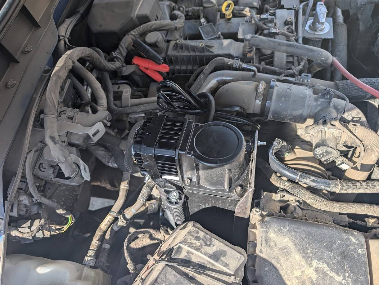

Very slick install. Do you have a tank at all or do you go direct to compressor? What's your setup like on the other end? I was going to shell out for the ARB underhood joint from FP, but I don't know what my airing setup will be like. Probably a standard 2-way for me, but I might just make it myself!
I did a Trickflate under the hood. IDK how well it's going to survive in the heat long term, that's a new location for me.

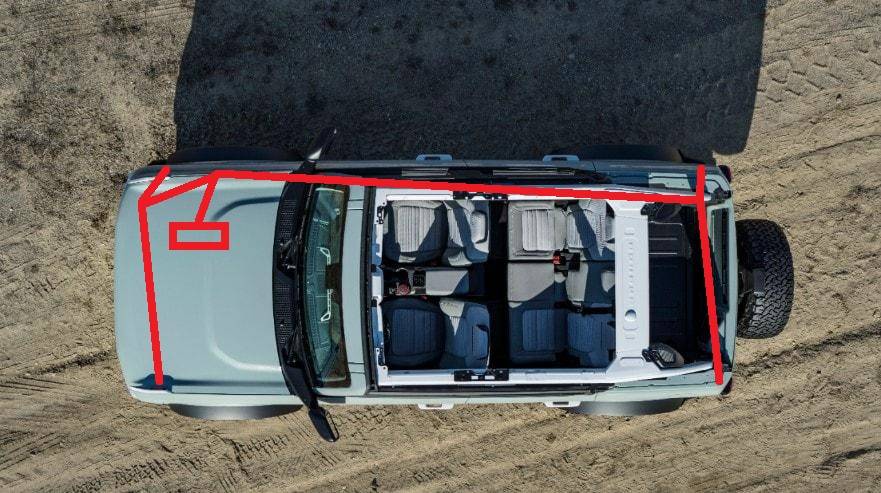

Attached a photo below to show the layout.

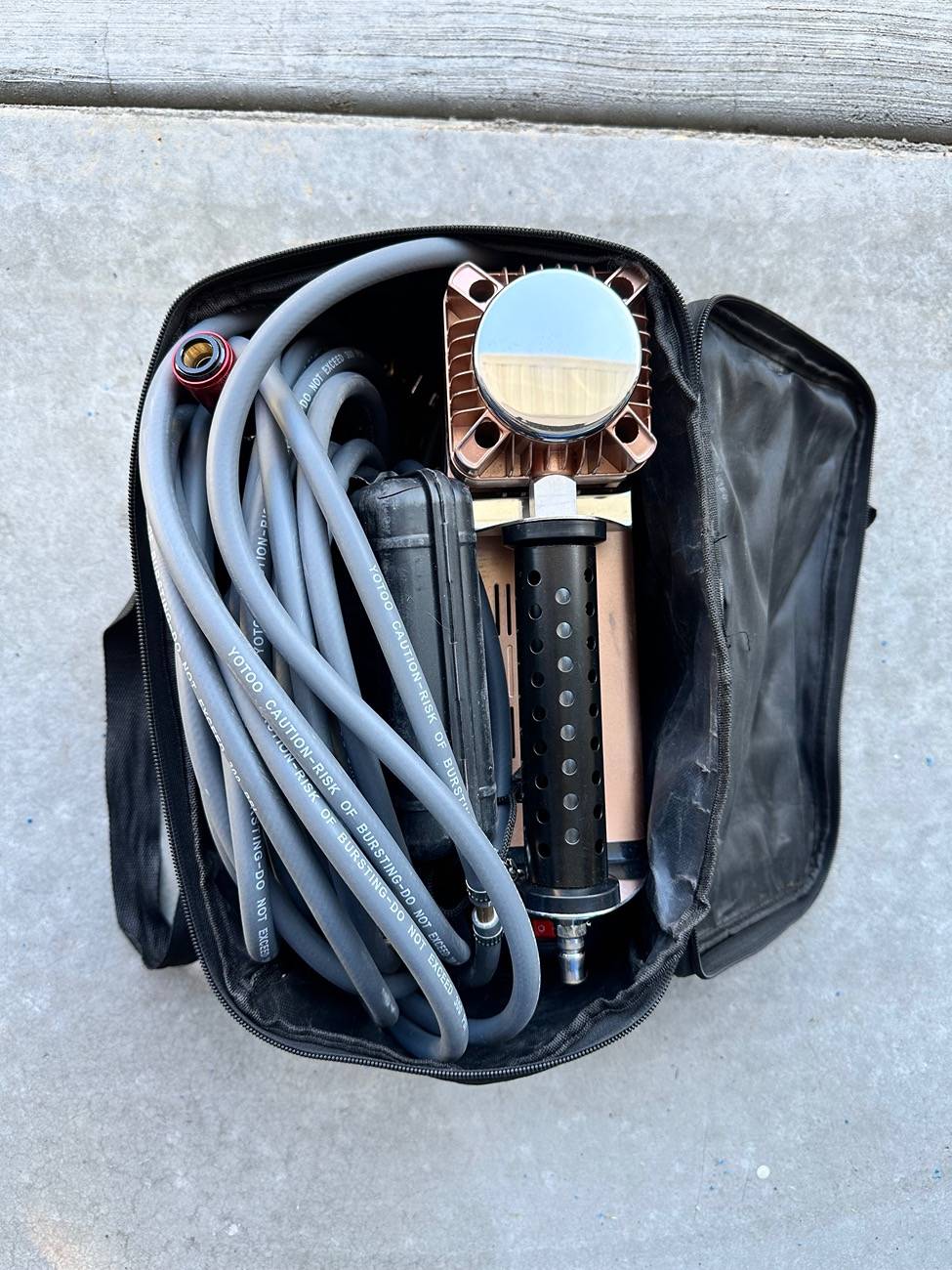

My DIY 4-way hose kit fits in the same bag as my compressor. Not bulky at all. I would go with a permanent solution if I could just flip one of my accessory switches and auto-inflate, I would do that. But if I need to get out and hook stuff up manually, my DIY kit isn't significantly more effort than anything else I've seen.
