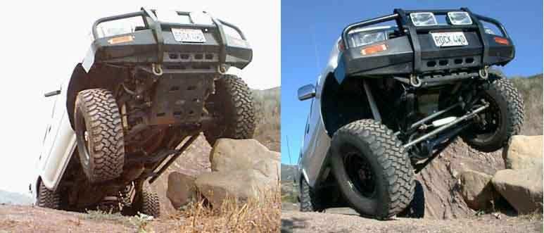

I was not singling out a stock jeep or a stock bronco, no mention of stock that I see. I was making the point that an IFS will "hang" a tire more often than a SFA. In others words you can lift a SFA to the sky and it will maintain contact with the ground for far longer than an IFS, maybe the pic below will help with my point.
Ford Bronco 4WP Bronco Upfits Packages & Parts ifs-vs-sas
One will need a locker more often with IFS because of this fact. Or you will have to have more momentum to conquer certain obstacles. Not crawl over them.

The one on the right is heavily modified. Heavily. I bet the two pictures are meant as a direct comparison but I feel like it’s favoring the SFA for the purpose of illustrating the superiority of the SFA. You could build an IFS with crazy range but no one does because it’s way harder.

Take a closer look. This is a before and after a solid front axle swap. Same truck, same wheels and tires, and the same obstacle, and almost the same spot on the obstacle.

It's still comparing a stock IFS to a heavily modified SFA. It's like comparing a stock car to a "stock car".

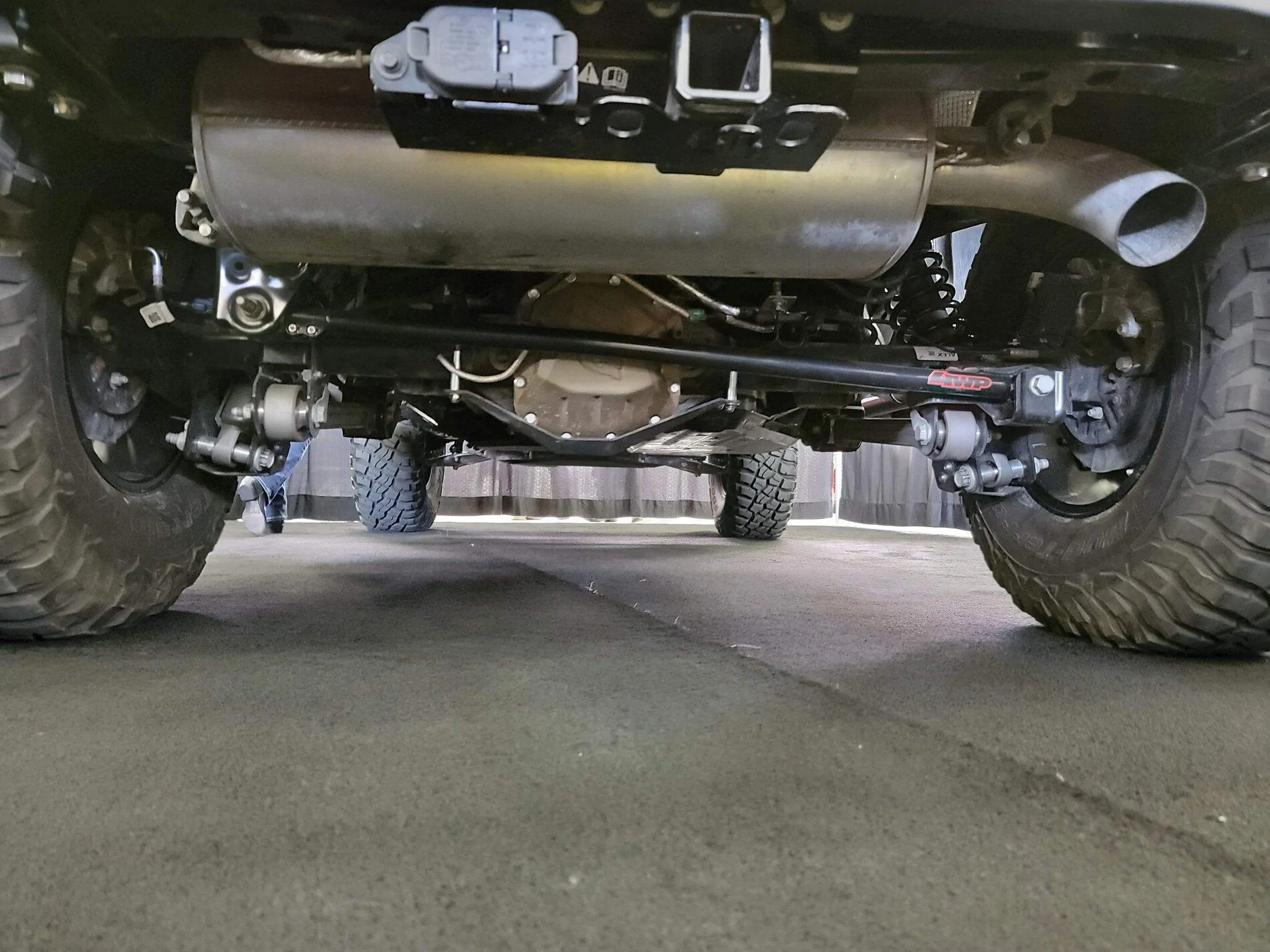

And rear? At what height lift do you have to make changes to control arms and track bar? All bolt on changes or any welding of brackets required?
Who is making the shocks and springs for 4WP? Will there be different spring rates available for those of us running heavy?
Here is a closeup I took Saturday.
totally bolt on. the springs are custom to that application but the shock is based on 2.5 shock technology. meaning you can probably tune coils from the racing industry. The team did a great job nailing that shock and spring down. try it first before you start tuning.
