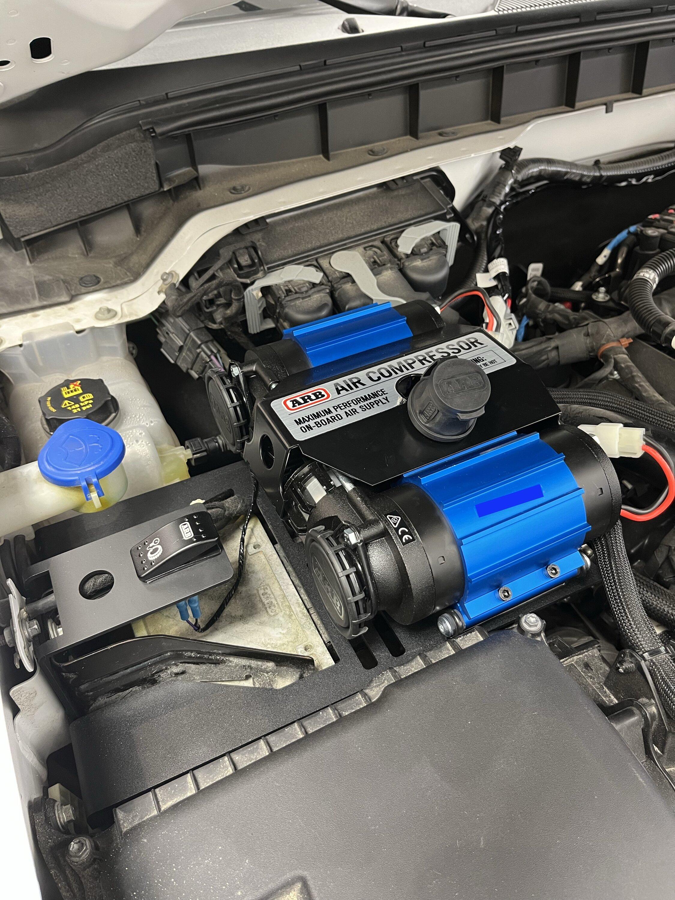

ARB Twin Compressor & KR Off-Road Mounting Bracket (From 4x4TruckLEDs):
Just installed this tonight. Not much to share on this as it's pretty straight forward. The mounting bracket is well built and easy to install. I opted for the additional mounting bracket for the ARB rocker switch, so I could turn on and off my compressor from directly under the hood and not need to use an AUX switch from inside the vehicle.
Any questions, please ask away!

Did you run into any issues you had to work around or deal with .... or was it a pretty straight forward "plug and play" install?
Any particular reasoning for this mount vs others, primarily, I thought there was a vertical mount version that was supposed to be pretty sweet.
(looked it up .... Grimm Offroad is what I was thinking of... )
I ran into an issue with adjusting the air hose coupler on top, from straight up to a slight angle. Even using a basic hand wrench, the bolt inside sheered off! I was directed to ARB whose customer service (quickly responded to my warranty claim) provided me a blow out diagram of the compressor and parts list, and offered to send me a new bolt. Thankfully I was able to get access to it and with some patience, was able to extract the bolt and find a replacement at a local hardware store. Outside of that, it was easy to install - Lots of helpful videos online and the instructions with the compressor were pretty good.
I was looking at the Grimm Off Road one, however I wanted a more simple installation. I also didn't mind having the compressor more out in the open like it is now - Thought it might help more with dissipating heat. Maybe that's a false thought? The bracket I got appears to be very well made and was super simple to install. Once everything was secured, I gave the compressor a good shake and it doesn't budge.
