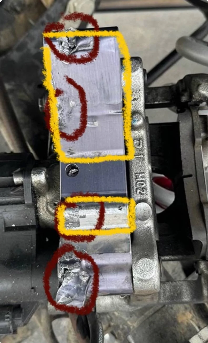

Here is the bracket from @ScLeCo that was damaged. This bracket had poor tolerances and thus not much bearing surface area. The two yellow areas represents the available bearing surface for tight tolerances. The red areas highlight the areas the took load. The bolts carried most of the load and failed. Some bearing contact damage is also seen on brackets. From this image, a significantly greater bearing area is required.
the shear pin area is similar to a single bolt. I do not think that adding a tight tolerance shear pin here will be anywhere near sufficient or do very much. The entire yellow bearing surfaces need to take the load. As was observed by the design that @5GENIDN showed. No local hot spots were observed.
a proper bolted connection needs to be designed to ensure sufficient clamping force under vibration loading in order to maintain adequate bearing surfaces. hopefully they will do this. Just adding pin won’t cut it. Lots of tweaks can be made to bolts, washers, etc… as shown in pic by @snacktime… but if significantly more clamping force is required this is typically achieved by more bolts or bigger bolts, as snacktime said.

Man. The unsettling thing about this example is that it’s a picture of @ScLeCo failed rear portal. After we initially “fixed” our rears they haven’t loosened. They were loose the first time at 200 miles or whatever but since then I’d pull everything and check the paint marks-they didn’t move so I left them alone. So maybe 1700-1800 miles? Still factory bolts and washers, just with red loctite. 262, in fact. Not 263 until recently. Pulled them last week (I think) and while there’s no evidence of load being taken on by the brackets like there is on front passenger, I chalked that up to how much tighter they are against the box. Couldn’t find any evidence of damage, not that my visual observations mean anything. It’s a very different situation when comparing our back portals to the front, so that makes me wonder what was different between his rear portals and ours…our rears are (were) the ones I’m not worried about!
I do know those are not the fronts. They look way to wide. However, The image of @ScLeCo bracket does nicely show the bearing areas the took all the load. Not sure why but very uneven load distribution on the large main bearing areas. Poor tolerance, inadequate clamping force? Who knows? But shows how f*up this is.
Some of the brackets are clearly behaving well (5gen) some are totally jacked up. I would check mine on all 4 corners and see if there are hot spots of wear on the bearing surfaces or in the bolts bearing areas (threads). I wouldn’t want the bolts carrying any significant shear load, just applying clamping force. I would get with 74weld if abnormal wear is observed.
