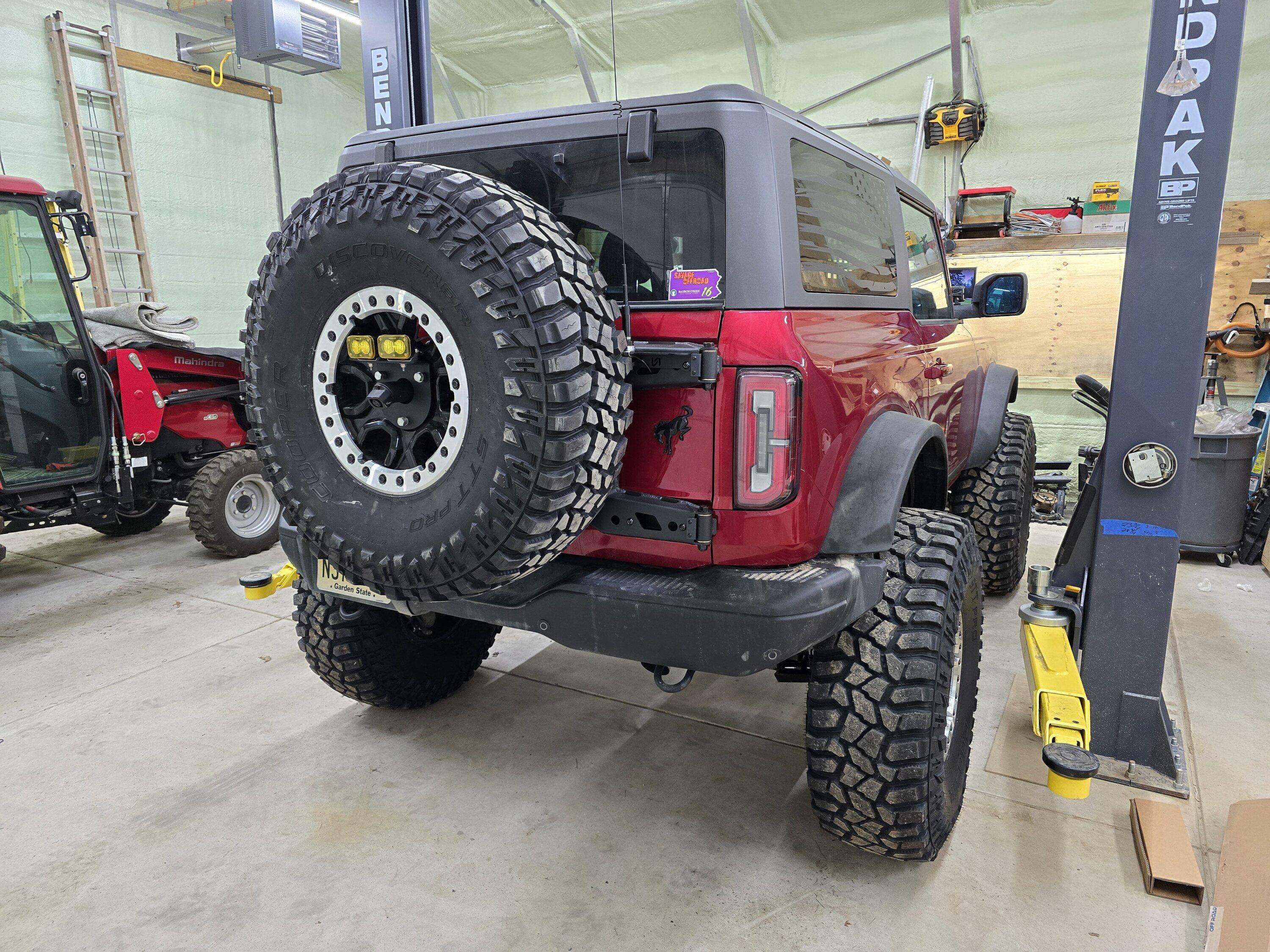

Evening all, been traveling a bunch.
Finally got the Turn Off Road tail gate and adjustable tire carrier installed!!
Really nice product. Instructions meh...
Feel better with the forty on the back now.

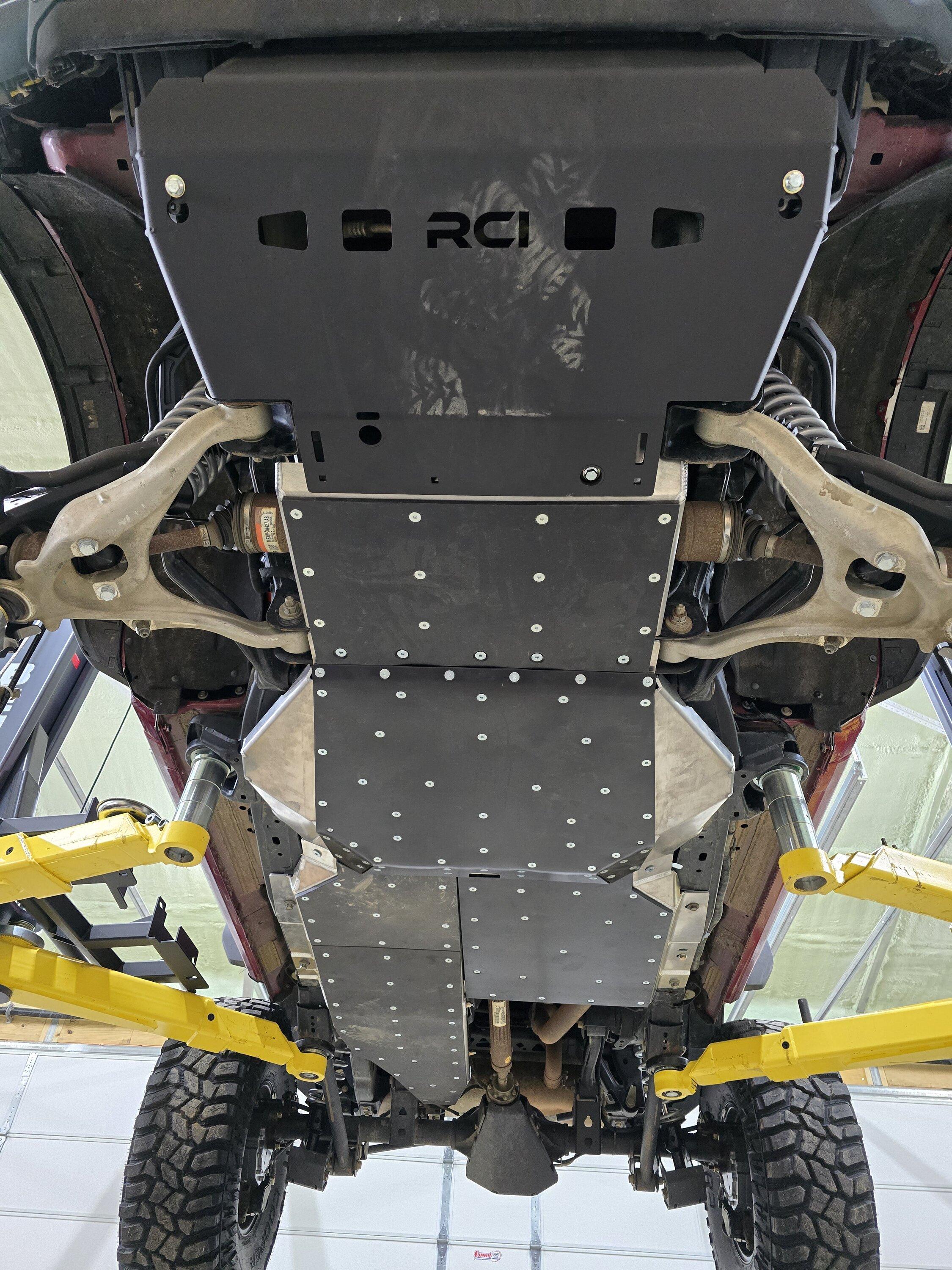

Also installed the NVR belly skids. Another instructions not that great but there product is amazing!!! Super strong feels almost bulletproof now!!!
Replaced my bash plate with the RCI one. It is 1/4" thick compared to 1/8" thick and had already bent the factory bash plate. It meets pretty much perfectly to the NVR belly skids. Supper happy with it
Have a little hill on my property and it was like nothing!!
the boot prints make me think someone flipped your bronco over and stood on the skid plate to do the installation ;)
Yeah, they where all laying in the garage floor, and if they can't take my fat ass walking in them then there shit!!!!!🤣🤣🤣

Sick. That looks amazing. Any insight as to wether the RCI rock sliders are going to work with the NVM?
So I put them in place on both sides and I think I can get them to work but you would need a spacer plate under the one bracket per side and you would need to elongated the holes in the sides to receive the side bolts and figure away to hold the nuts on the inside of the frame because onelce the NVR slides are up, there is no way to get to them. I think all doable just time. If my local fabricator wants too much to modify the ones I got I'm going to call RCI directly and see if they'll do something for me I'm already out the money for these so and I would really like them they're freaking beefy as all heck! But for now use the stock ones they are pretty easy to modify and they will support the vehicle It would just be nice to have somebody sticking a little farther out and something uses a step concerning how tall it is now.
Damn. So it’s as I thought it would be. Those inside nuts are going to be a head scratcher. I really would like the RCI’s for the same reason. Built incredibly well, provide a step, and the bump out can be handy also. A real bummer. My NVM armor should land here tomorrow. I guess I might as well unbox the ARB sliders I’ve been sitting on and see if they’ll work together.
Please keep me in the loop if possible about what you need to do to get them to work. Here’s that other thread so we don’t hijack this one:
https://www.bronco6g.com/forum/thre...-rock-rails-sliders.84684/page-3#post-2118332
Thanks a ton.
