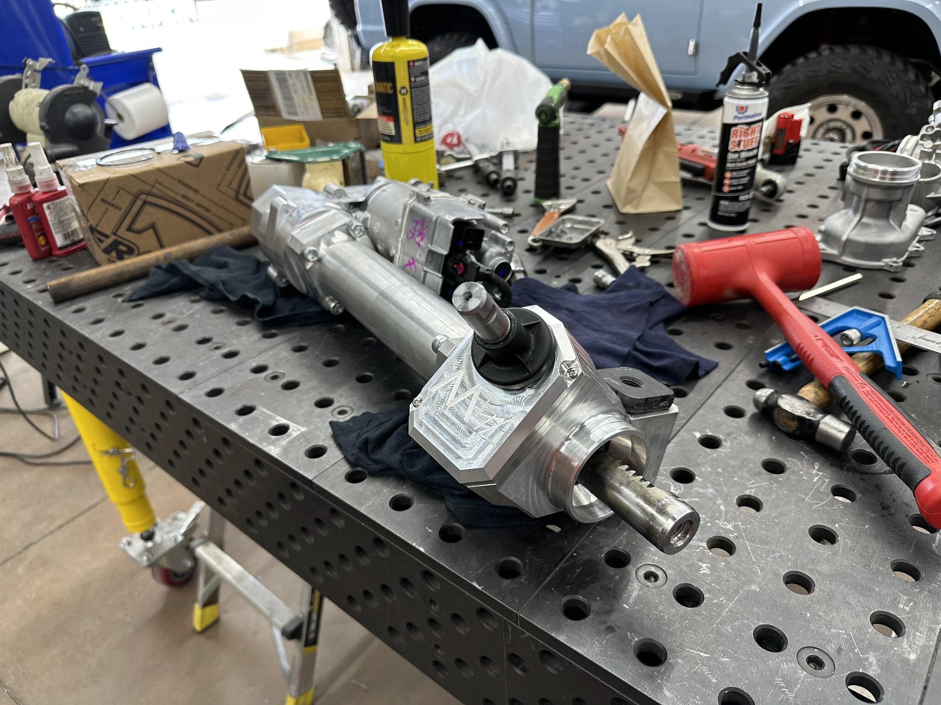

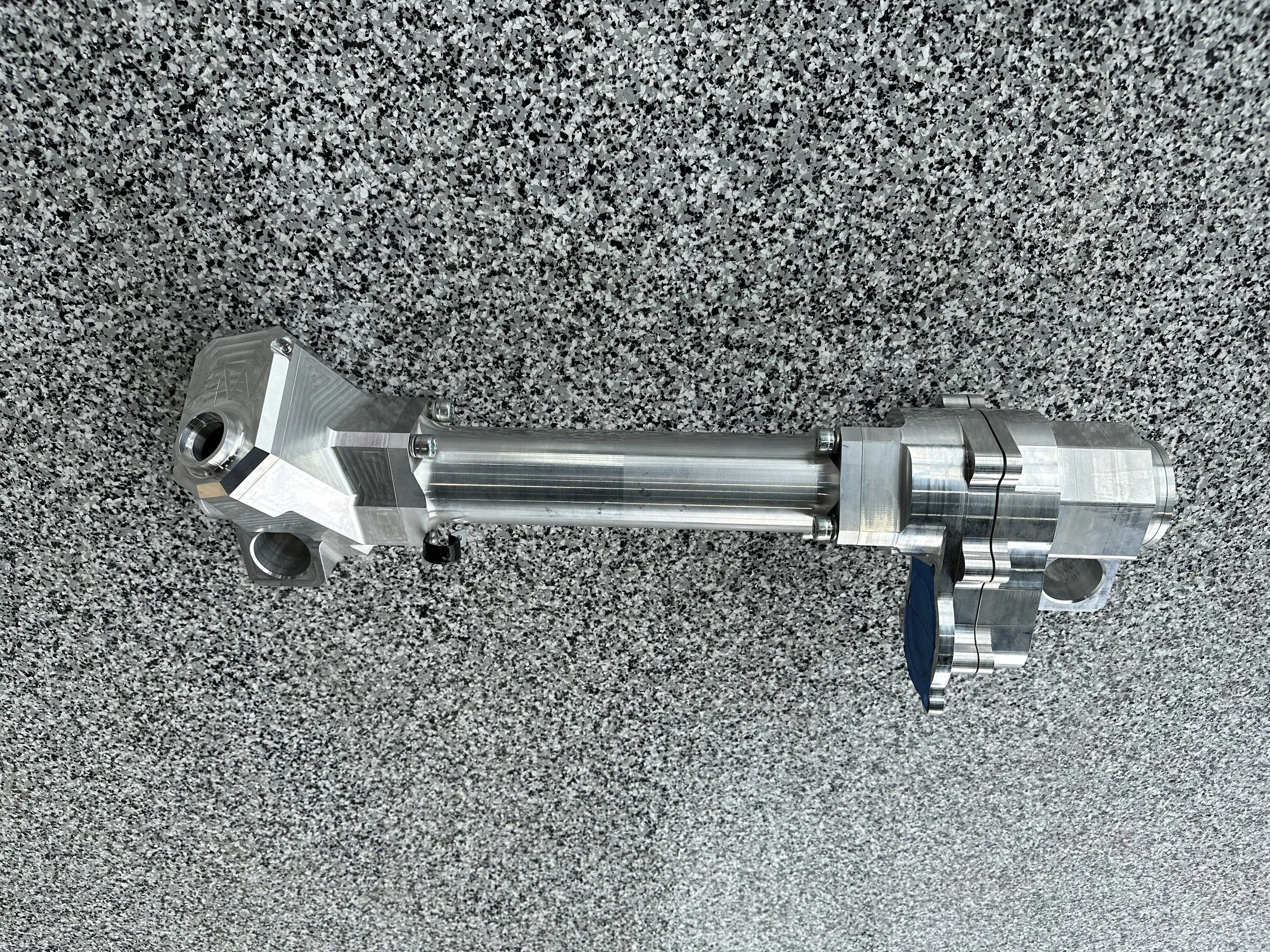

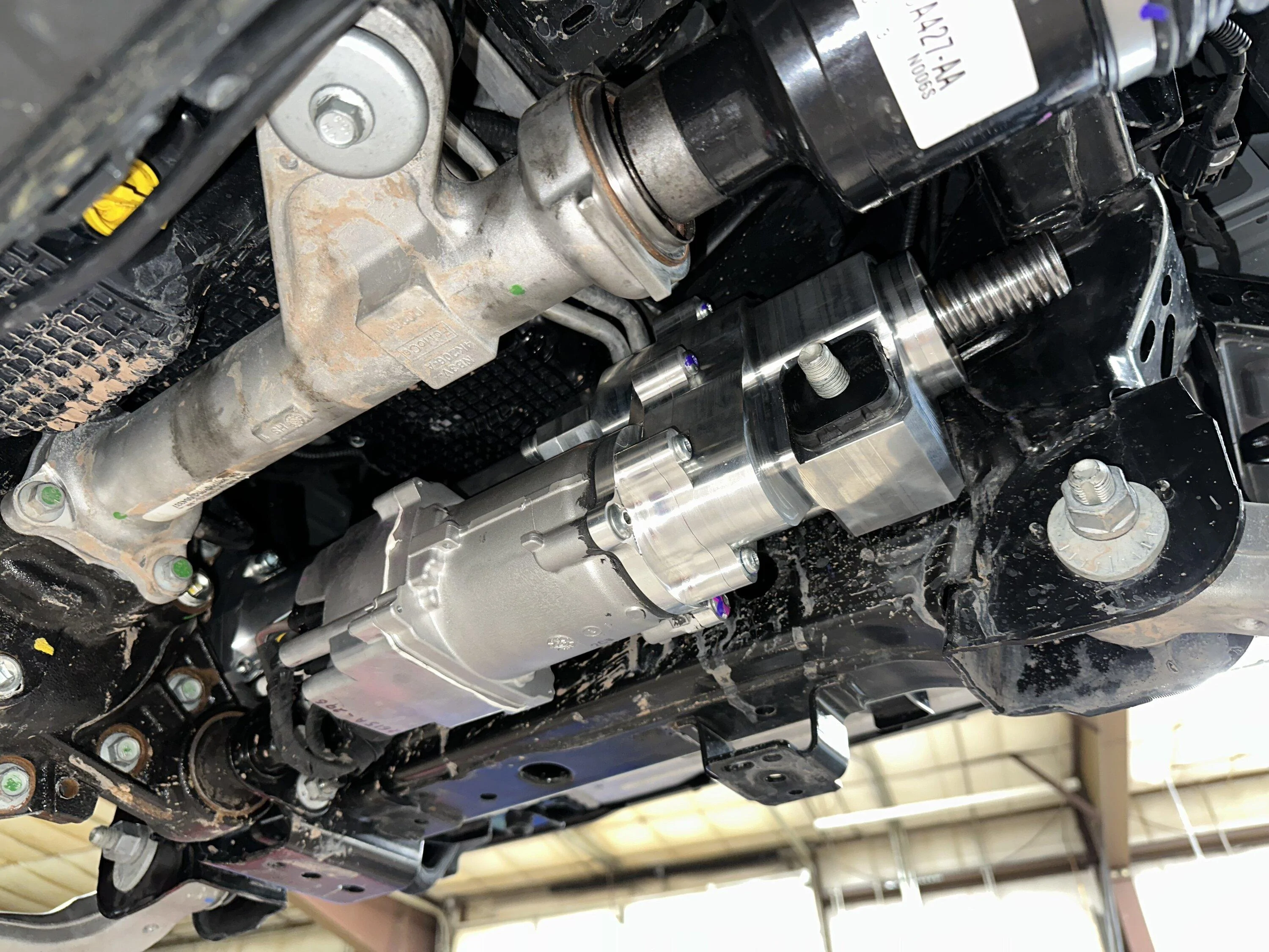

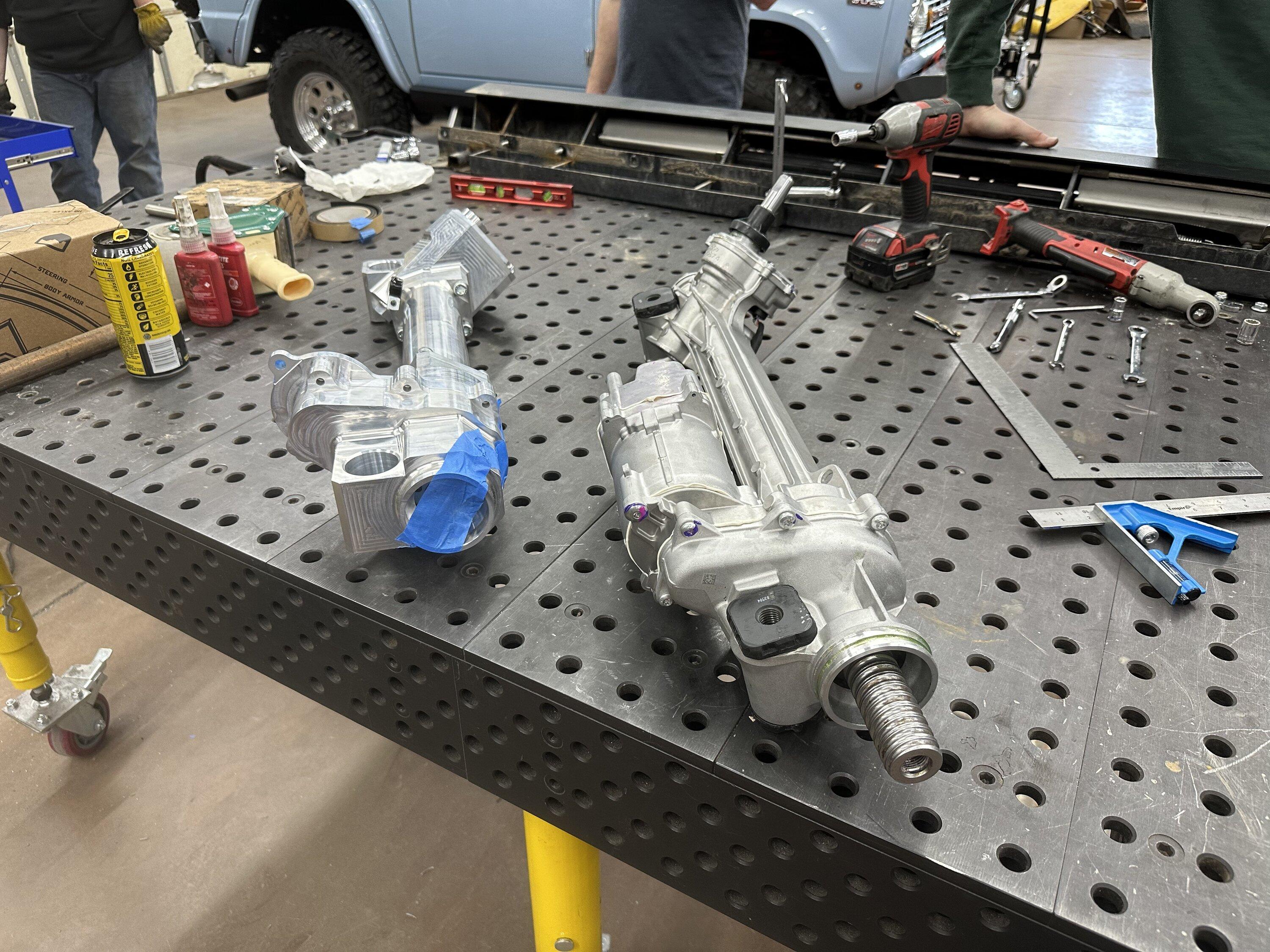

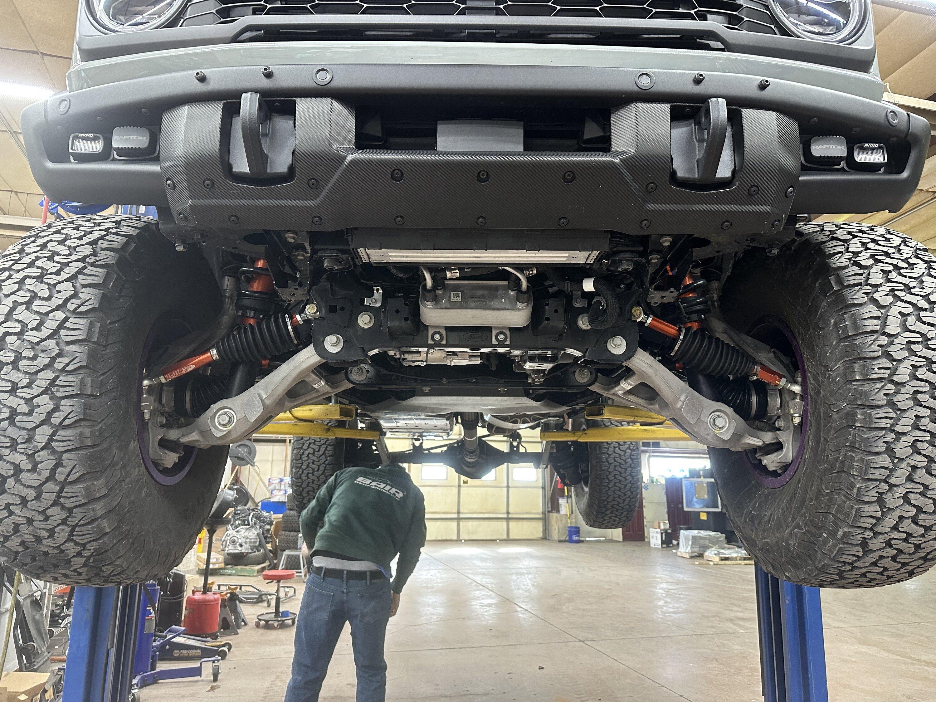

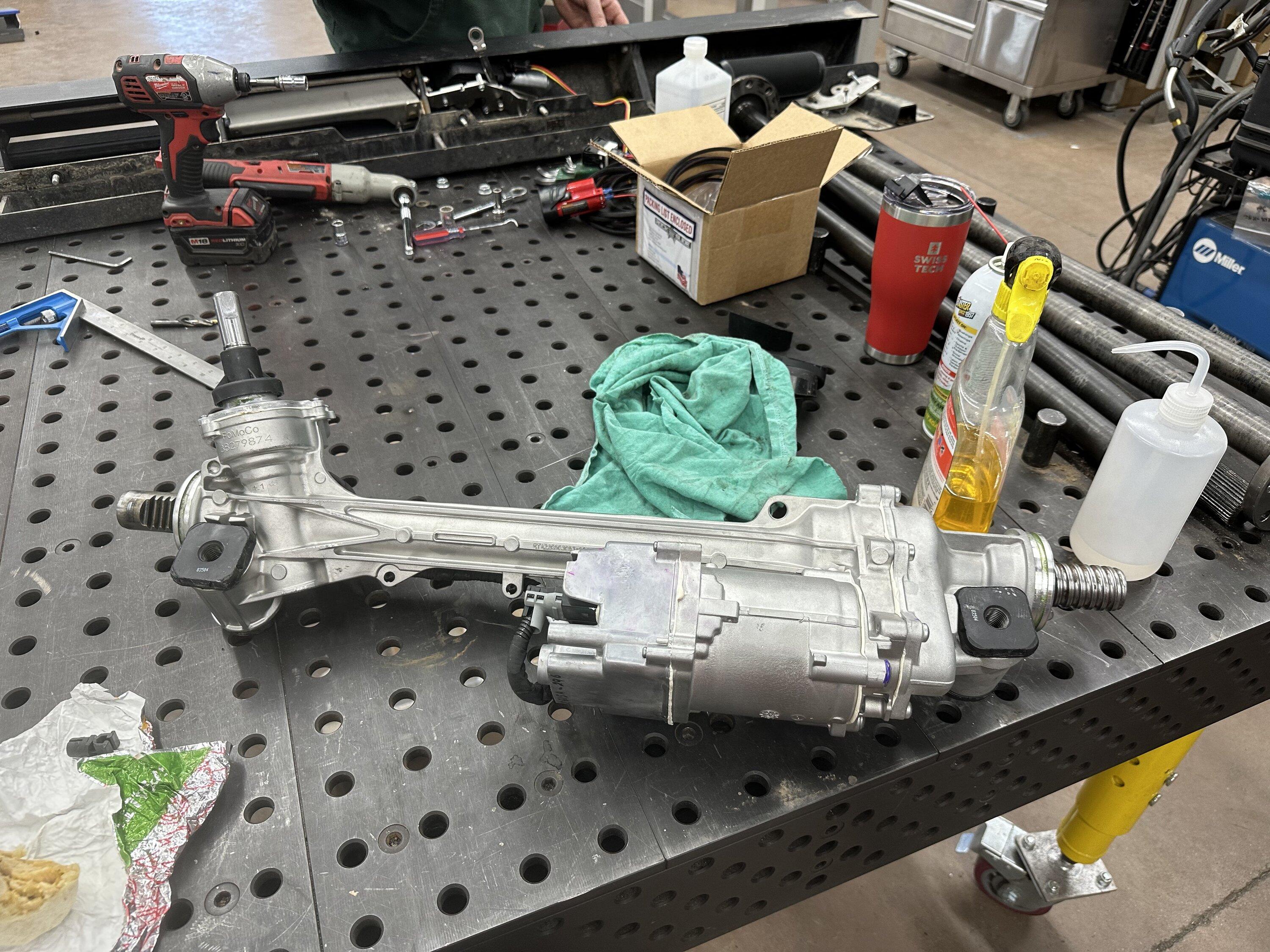

Last week we installed a 74WELD steering rack in my Bronco Raptor. I am not going to go into too much into detail on the install since these will have to be installed by 74WELD or an authorized dealer. My steering set up is as follows: 74WELD steering rack with RPG's Bronco Raptor Steering Tie Rod Kit.
I have spent the last 7 days in Moab wheeling trails and trying out the rack. I wheeled in Area BFE, Hells Revenge, Metal Masher, Poison Spyder, Flat Iron Mesa and Top of the World. I will be back there in a few weeks for Bronco Safari.
If you're looking for a steering rack that can solve the problem of weak factory steering racks and want to be worry free offroad, you will want to get the 74WELD steering rack. This rack improved the steering drastically, it can withstand the extreme forces and vibrations of off-road driving. This steering rack is built to handle the toughest terrain, from rock crawling to bombing in the desert. It took everything I threw at it, and it held up when it should have broken. It has custom-designed internals, which reduce play and improve steering feel. When I pointed the tires, they went without any deflection in the steering. The only thing I can compare this rack to is a Howe rack that is found in race trucks. I turned against rocks, I shock loaded it and drove it like I had full hydro steering. This rack took it, and any worries I had about breaking another rack went away. If you plan on really using your Raptor I recommend getting this rack.

Great that somebody has gotten it installed! I'm taking the series of pics to mean that they removed your original unit, disassembled it, then built the 74weld shell with your original internals? Reason I ask is the major stumbling block for most non-Raptor and non Wildtrak 3.0 owners ATM is that there is a sales hold on wt3.0/Raptor rack currently, however I would assume that any Bronco that has already had that mod could be upgraded currently?

Yeah I took out my rack and swapped the internals into 74weld unit. I broke my original rack and it took over 5 weeks to get the new one into the dealer. The same day I got it back I pulled it out and put in the 74Weld rack.
