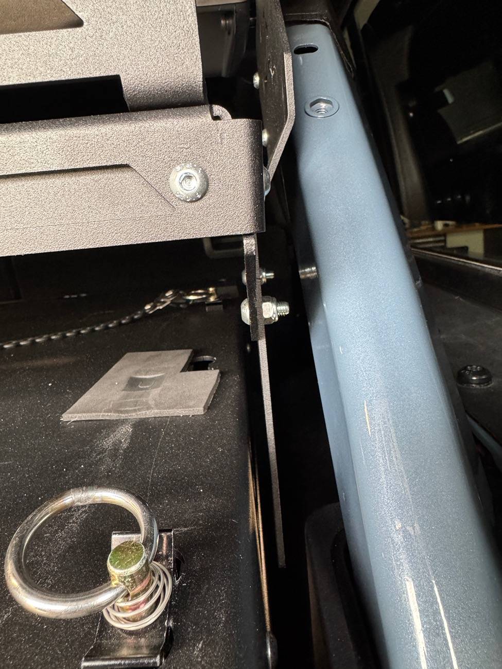

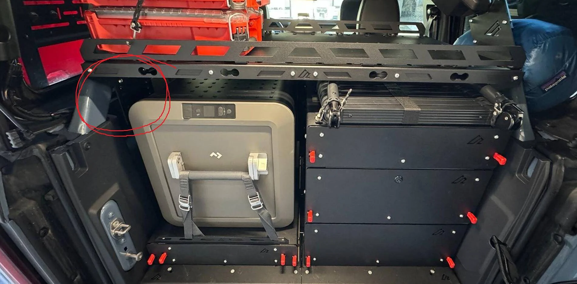

Would you be able to snap a pic for me? Looking to see how the bracket lines up where the top drawer meets underneath the cargo shelf. I'm looking to add a 3rd drawer to my 2 door, but it doesn't look like it will fit. It's this bracket, but on the right side.

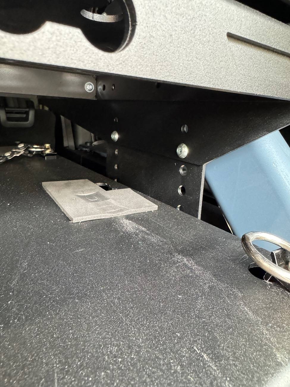

Hi here’s 2 photos of the bracket on the right. As you can see, it extends below my top most drawer. If it’s an American adventure lab drawer you’re installing, there should be enough room. You can always cut the bracket shorter using a dremel or sawzaw if it’s too long. Let me know if you need different angles of photos

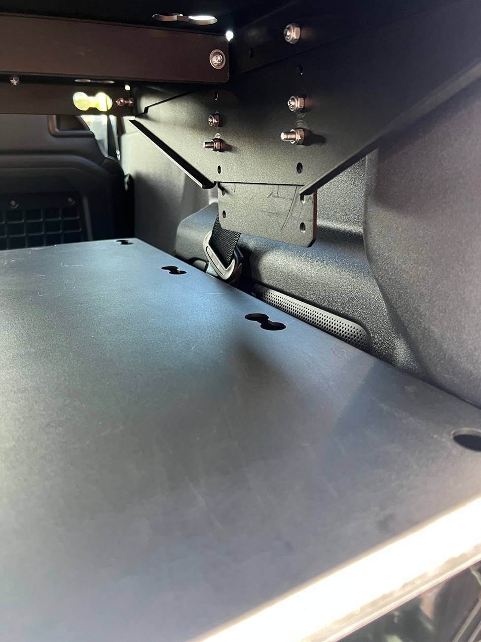

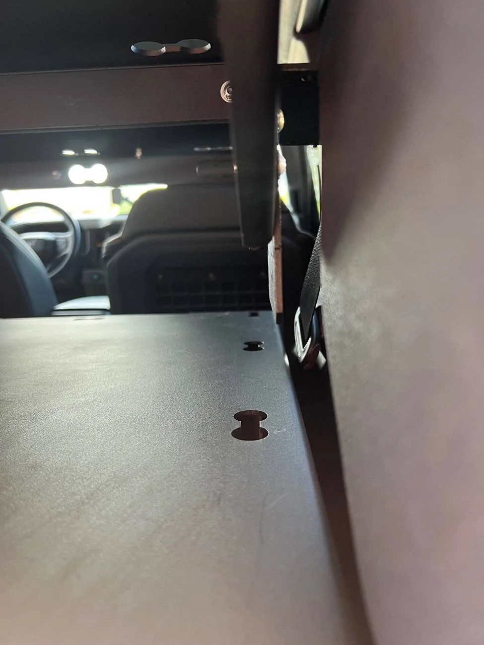

Thanks. Doesn’t look like I have that room. The bracket is in the way.
Huh, y’all have a different design for the shelf for the 2 door. Sorry didn’t realize. Alternative idea is to mount a Milwaukee pack out there or use those accessory rings and strap down a bag on top of the shelf
