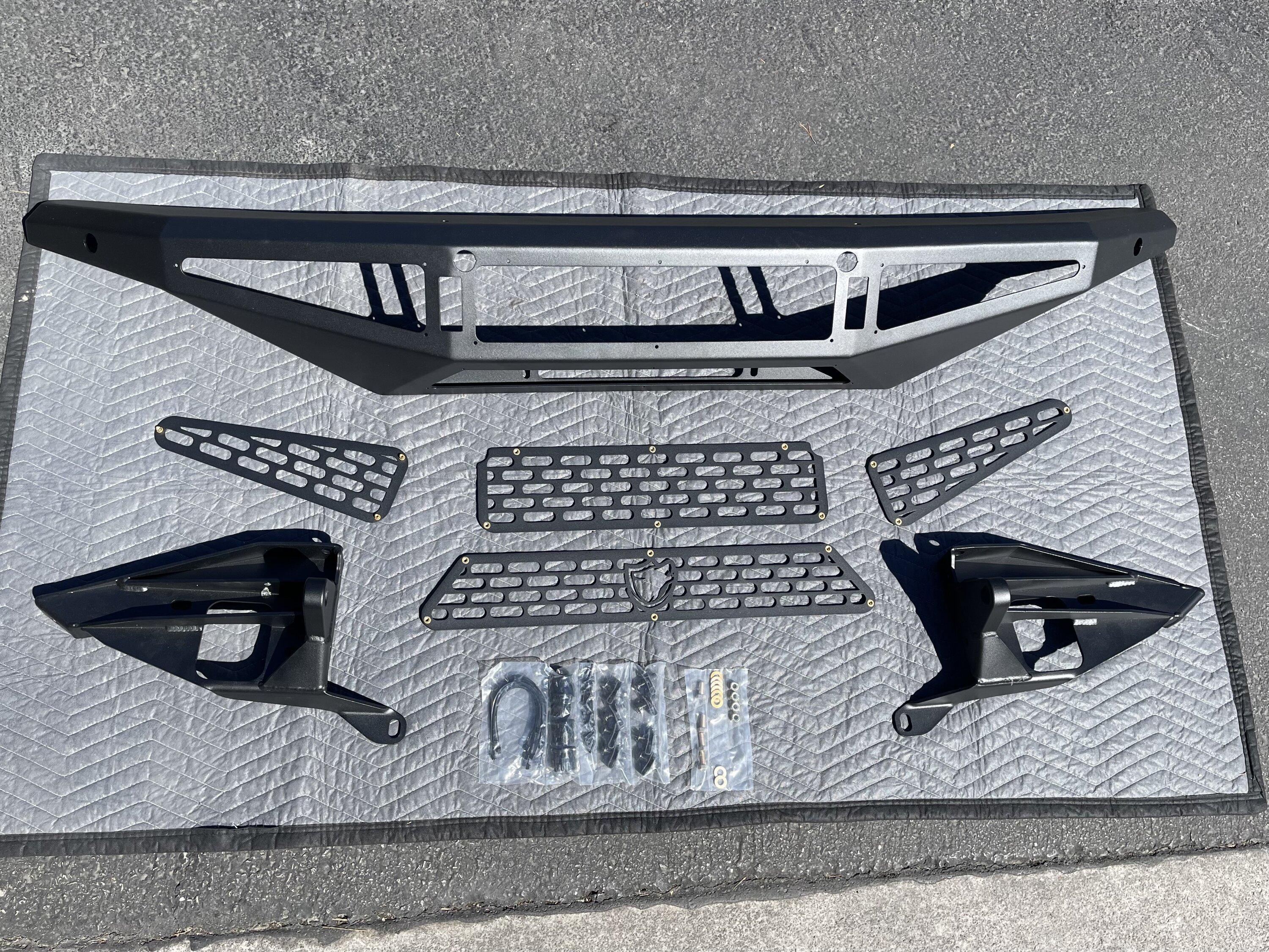

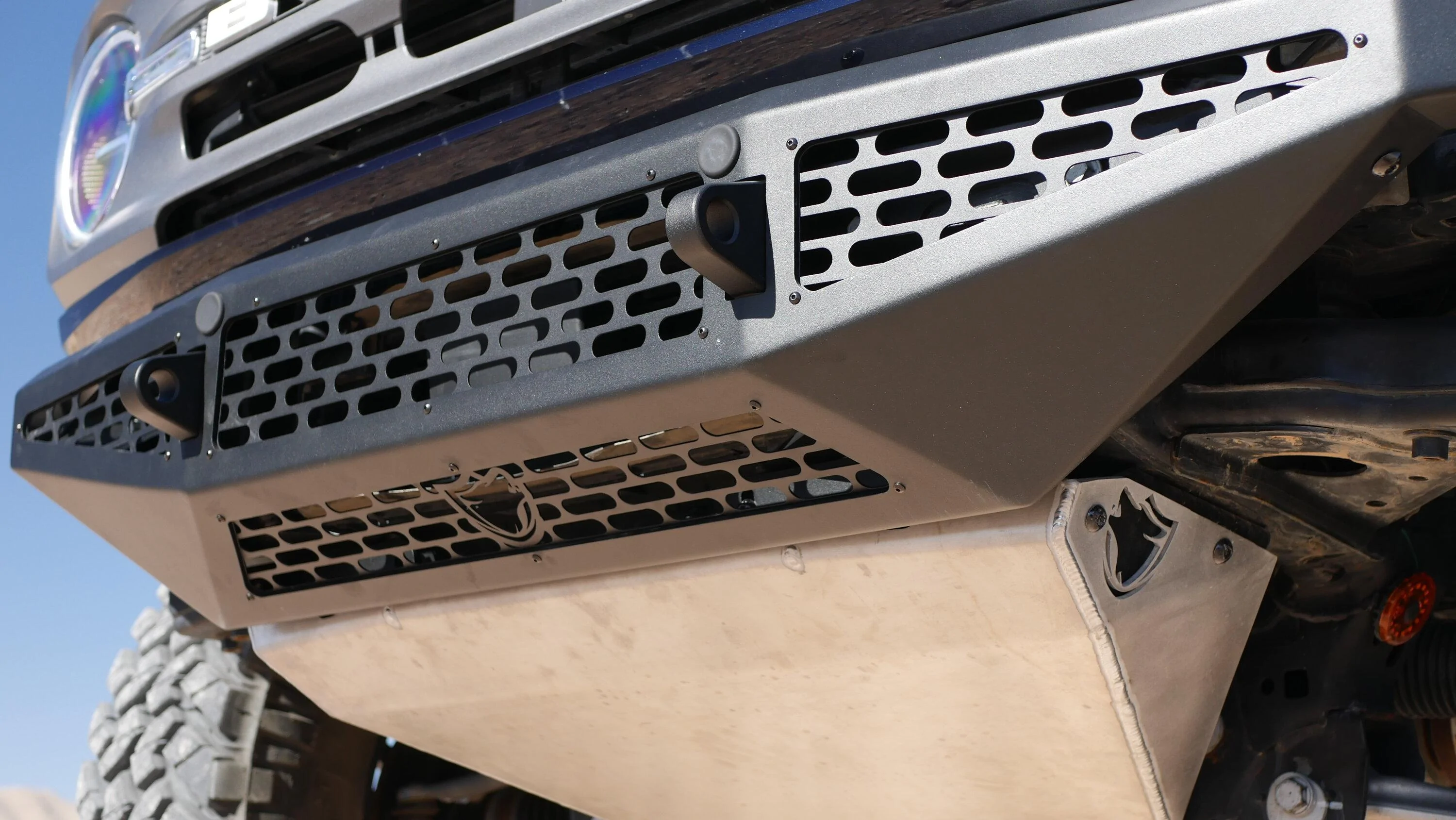

I just got done installing the LOBO Off-road Front Bumper. First off I'm very impressed with the fit and finish when compared to a lot of the other aftermarket options I've seen in person. Even compared to my expensive RTR rear bumper the LOBO bumper blows it out of the water in weld quality, coating and weight. Speaking of weight, I took the time to weigh the LOBO Front Bumper versus the OEM Modular Bumper that I was replacing. I was blown away that I was able to save 25LBs just by switching to the LOBO bumper and that's not including the weight savings you would also get if you opted for LOBO's Front Aluminum Skid Plate. The Install went pretty easy and is obviously well thought out (No hard to reach bolts). The bumper uses a similar concept that I've seen on race rigs, that the substructure is designed to be the stronger support and the outer layer being the lighter shell. I'm sure that comes from LOBO's competition background. Overall Im happy with the outcome. What are your guys thoughts?
OEM Modular Front Bumper - 75lbs
LOBO Off-road Front Bumper - 50lbs
The bumpers backbone/substructure is made out of 3/16th steel while the bumper outer shell is made out of 1/8th steel.
Ford Bronco A Lightweight Steel Front Bumper? - LOBO Off-Road Front Bumper: Installed Photos & Review IMG_4419

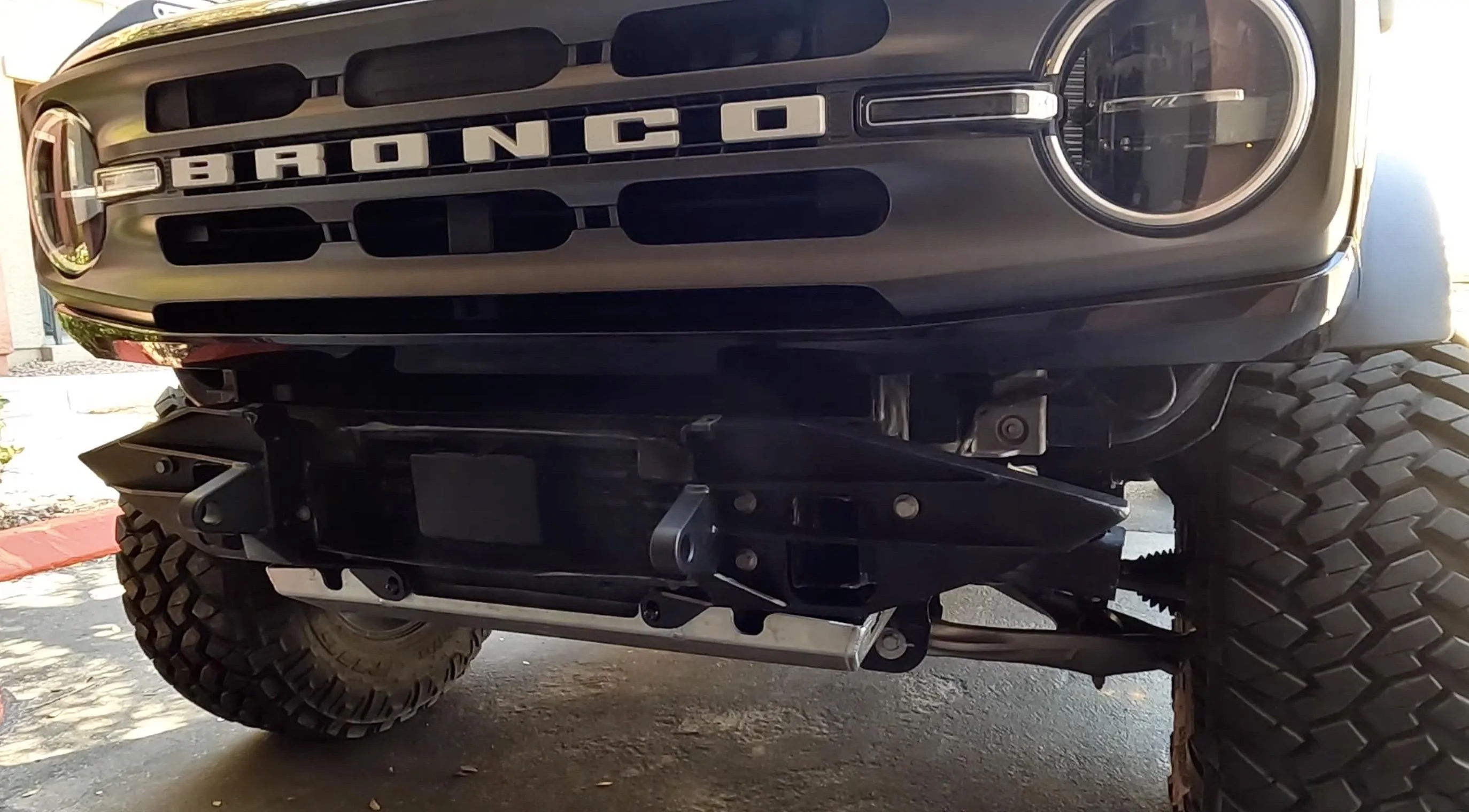

You can see here how the bumper mounts to the backbones and the skid plate to combine all three layers for add rigidity.

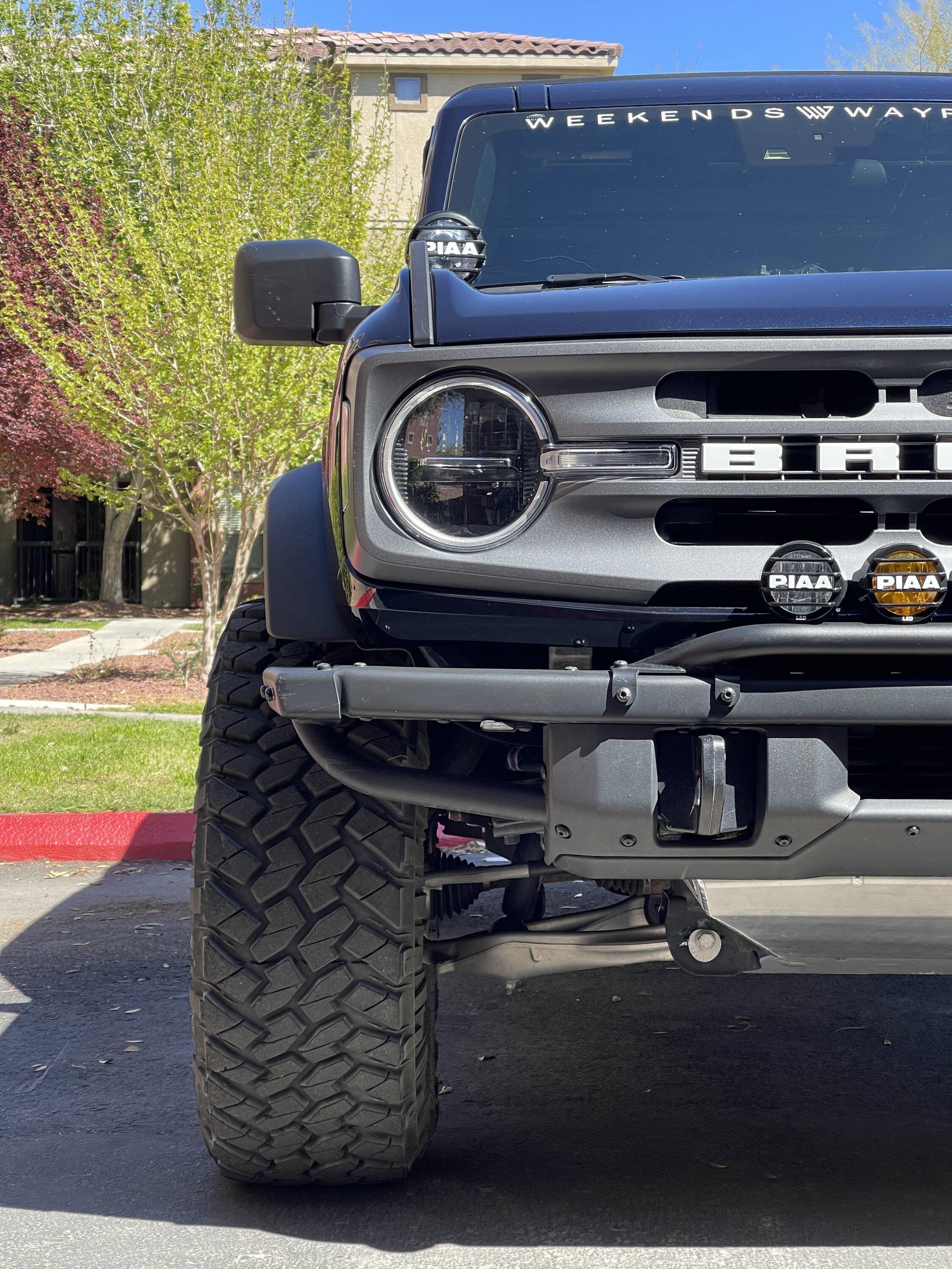

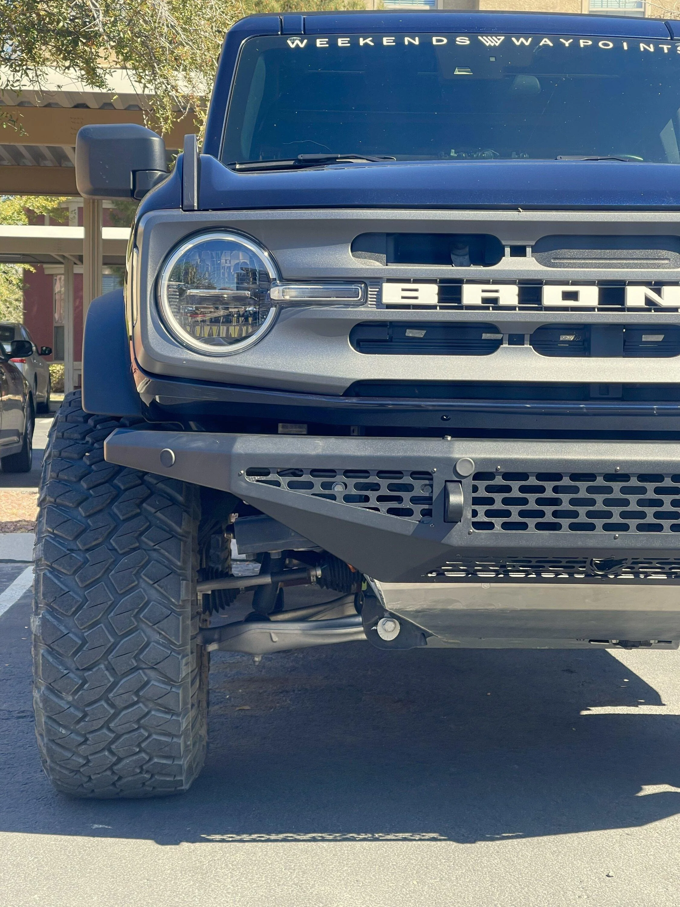

Here are comparison shots for the added front end clearance.

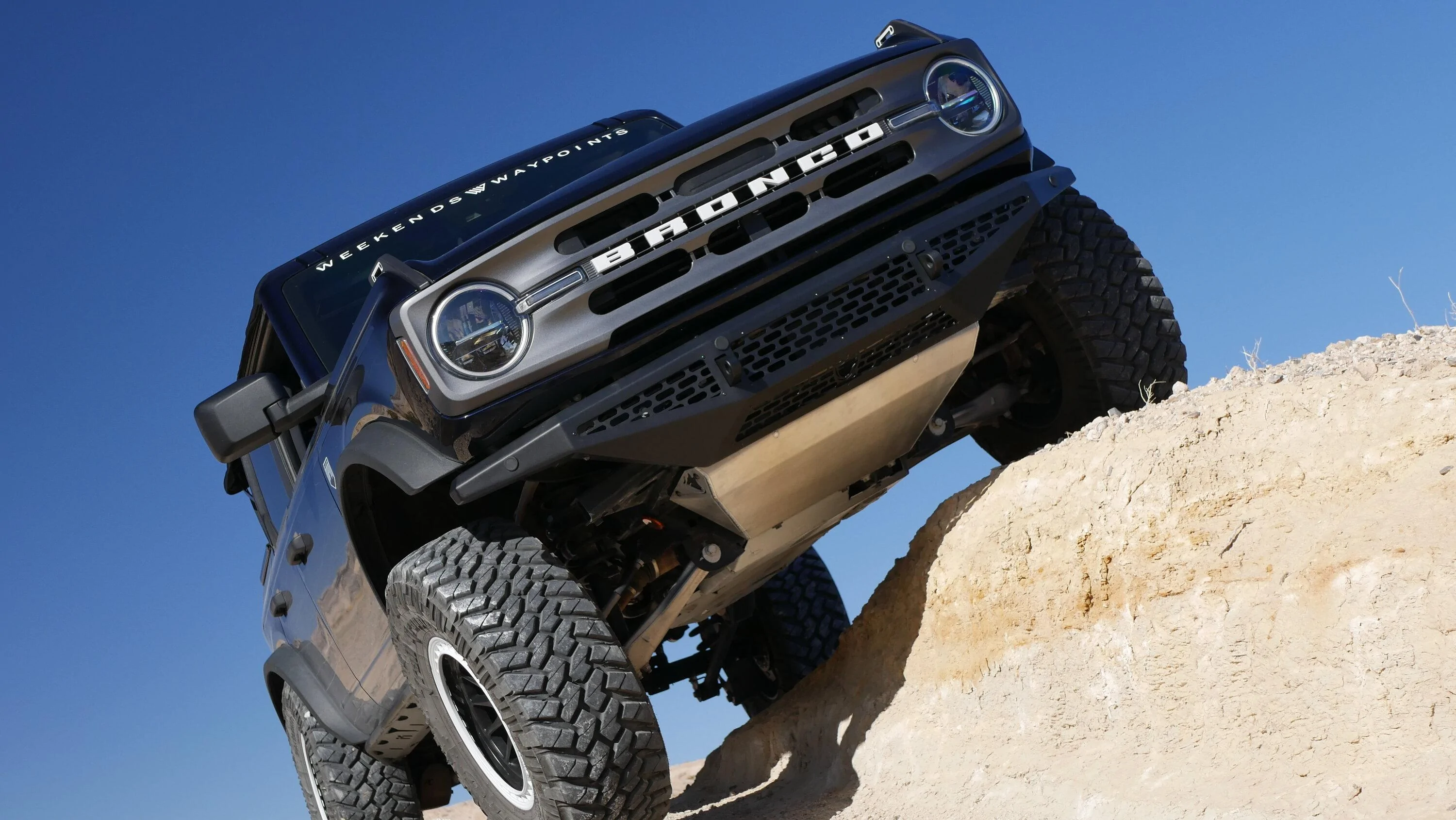

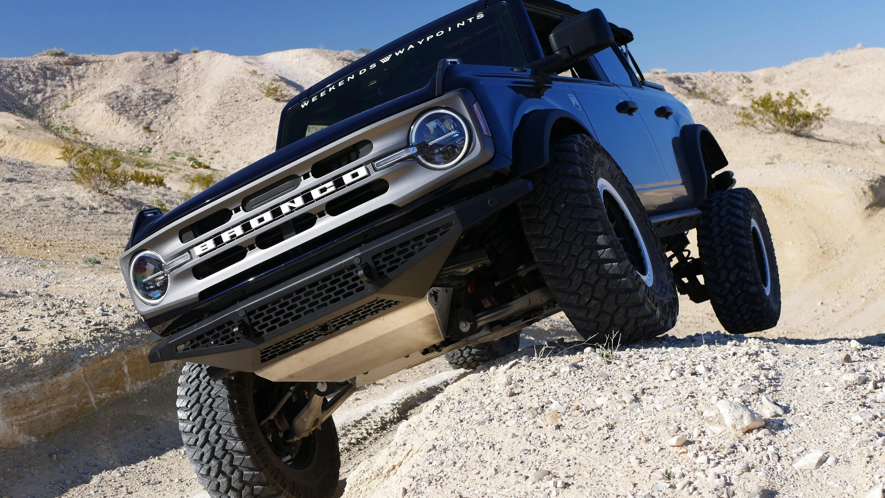

Enjoy the final product!

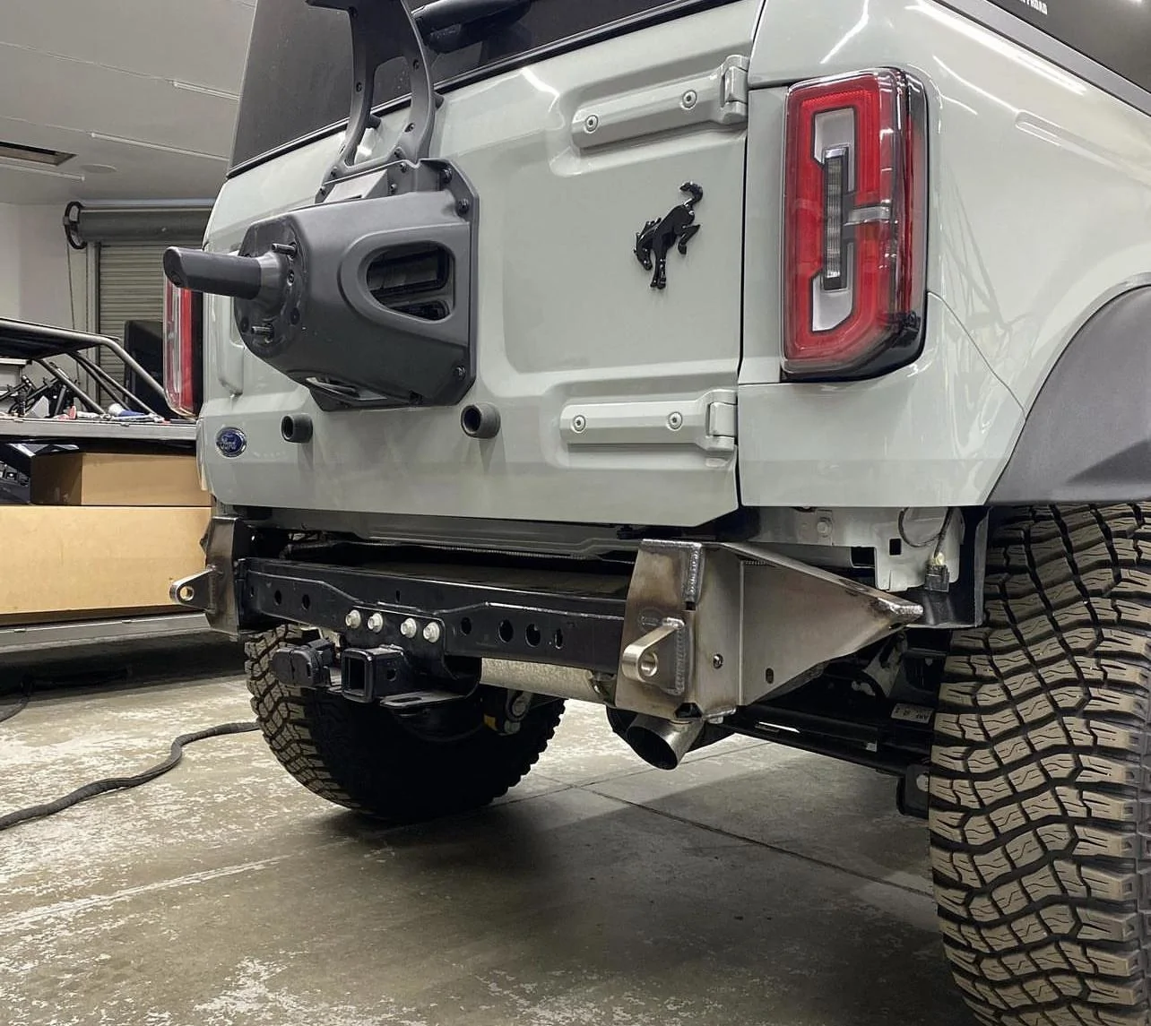

LOBO does have a rear bumber just like the this front bumper and from what I can tell it uses the same concept as the front. Check out the picture I found on their Instagram and the link to it.
Link - LOBO HNT Rear Bumper

As @Weekends & Waypoints has stated as well, I do offer a HNT rear bumper, that follows the same concept as the front HNT modular design. Below I attached links to the forum as well as the link to the product on my website.
