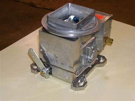

One more question, do you think I will be able to adapt a predator carb on these engines? :ROFLMAO: :ROFLMAO: :ROFLMAO: :ROFLMAO:
