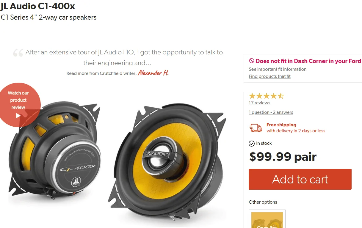

I recently posted on another thread that I was looking at replacing my B&O kick panel, front, and rear pod speakers with some better quality aftermarket speakers. I will be honest, usually the B&O is fine for regular driving but when taking top/doors off i found you have to push the volume up to near max to get over the road/wind noise and its there where the B&O starts to distort. However, we have one small problem with the B&O system, which is starting to become typical with other modern car systems. It's how to replace the third speaker (center channel) with matching left and right speakers.
After spending a couple of hours reading over and listening to Crutchfield's compare sound software online, I called them with a couple of final questions. I was already leaning at getting the 4" JL Audio C1-400x for all three dash and rear pod locations and the JL Audio C1-650 component speakers for the kick panel (will experiment where to mount the external tweeter). All sounded very good using the sound comparison test, had great reviews, and were decently priced for mid range speakers. I do want to give a shout out to Seth at Crutchfield for answering all my questions to ensure I was going in the right direction, even though these are not listed as fitting in the Bronco. In the end, they are so close that only slight modifications should be needed, if any. However, the one big takeaway was they only sell these speakers in pairs and did not have a competitor that sold individually either. Seth explained this is becoming a common question/request since many new cars are coming out with center channel systems. Basically, the only way to get a matching set in the dash is to order another pair and keep one as a spare....
For now, I ordered a pair for left and right and will keep my OEM center channel. Updating the other speakers may overcompensate that center channel and one may not even notice it's missing. Then again, I cant help but wonder what it would be like with all three matching in place, as that center channel does seem to put out quite a bit of sound in surround sound mode.
However, there is another way :)..... If one of you fellow Bronco6G members wanted to go in together to split the cost and therefore split the pair, then we would each have one speaker at normal value! Just a thought. Obviously the one forking out the initial order would have to be trusting the other guy would go through with it, and then vice versa. Long story short, if someone here is interested in these same speakers for the dash, I would be game putting in the order and then sending one out for 50% payment (paypal, etc.). The pair is only $100 so $50 for each to have a center channel.
I do want to install them in my dash first to ensure they fit and would even test out the center channel at that time. I can report back here the findings.

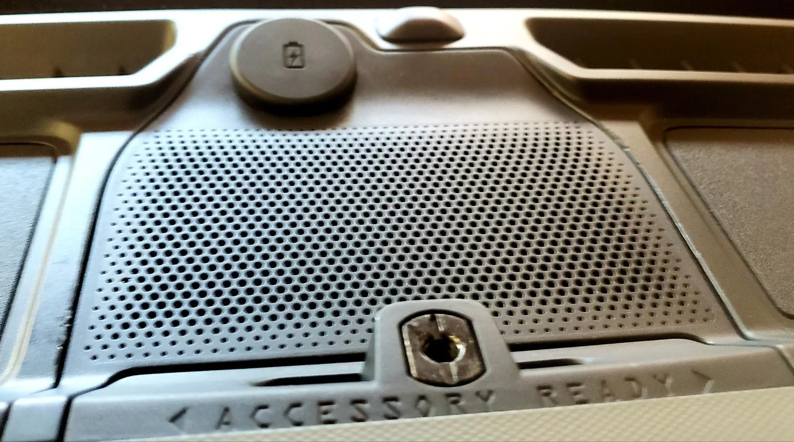

Update to those following this thread. All I can say is sorry and that I failed to test out the center speaker with my new JL Audio C1-400x speakers. Below are a few pictures why. I looked all over this forum, youtube, googled it, etc. and could not find anywhere where someone showed how they opened up that center channel grill. So I thought, what the heck, can't be that bad... got to be similar to the left and right dash speakers! Thus, I went to try to do so myself and stopped after a frustrating 10 minutes of not being confident enough to remove without breaking.
Ford Bronco A Solution to Replace the "third" B&O Ctr Dash Speaker with 3 Matching Upgrades 20220123_225336
Messing up the center channel grill/panel would be super noticeable. Plus the charge port and the dash mount bolt thingy are all right there too (almost looks like a hinge there). I did pry it up enough to see the speaker and it does look to be the same size/type as the 4" speakers in the rear pods. The left and right dash speakers have a special mesh over them for the tweeter, which I couldn't see on the center channel.

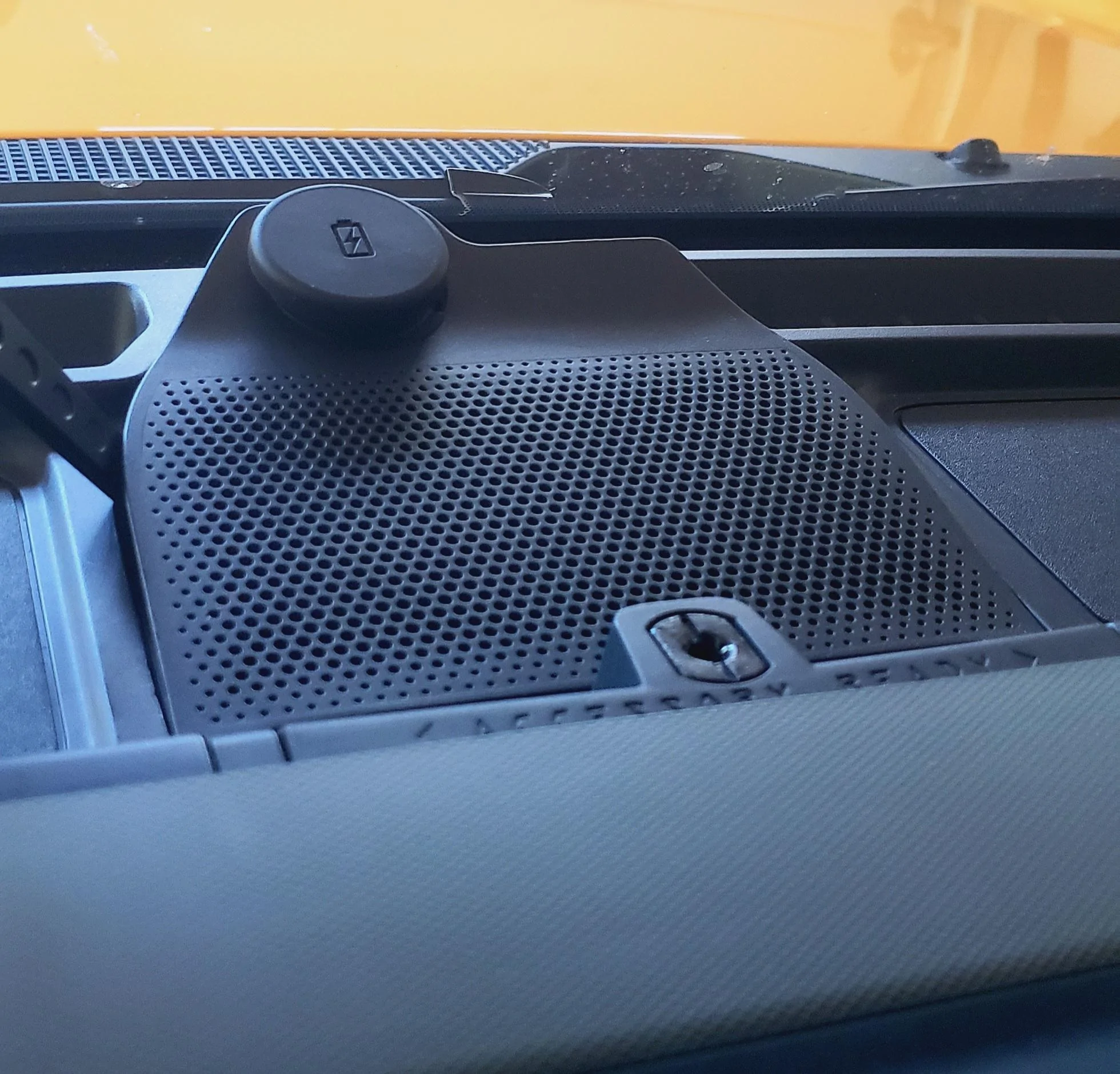

Ford Bronco A Solution to Replace the "third" B&O Ctr Dash Speaker with 3 Matching Upgrades 20220123_225357_resized
If you look from my photos, I tried to pry up the two sides and rear which put a lot of stress on the front hinge area, almost bending it. You may also note I marred the plastic a bit with a failed attempt and was worried what it would look like if I tried harder.

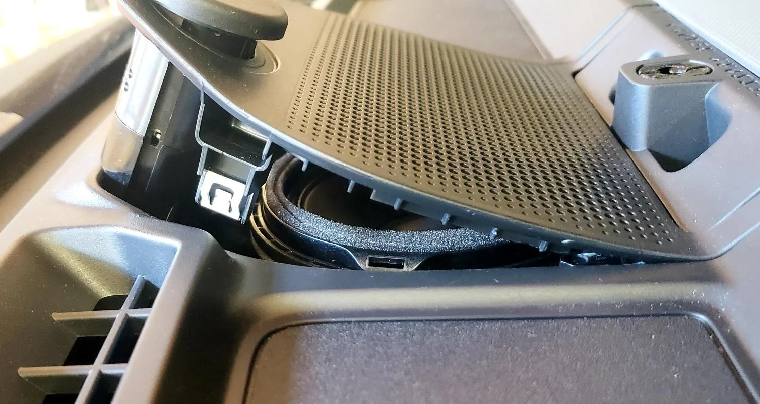

Ford Bronco A Solution to Replace the "third" B&O Ctr Dash Speaker with 3 Matching Upgrades 20220123_225430_resized
I have heard many other folks (including some famous youtubers, :D ) talk about replacing all the B&O speakers for a future project. To me, that needs to include this center channel. SO at this point I will wait for someone more experienced to post how this panel comes off. Then I may be back in the market for a split replacement. For now I will continue to enjoy my new speakers, which I will post in another thread tomorrow, including more details on how to replace the 6.5" kick panels as I found a lack of information out there on how to remove them. Maybe my writeup and pics can help someone, or atleast get one through it faster than I!

Did you ever figure out the center channel panel? You have to remove the part labeled "Accessory Ready", there are screws in each channel next to the accessory mount. Pop that part off then the speaker cover comes out.
