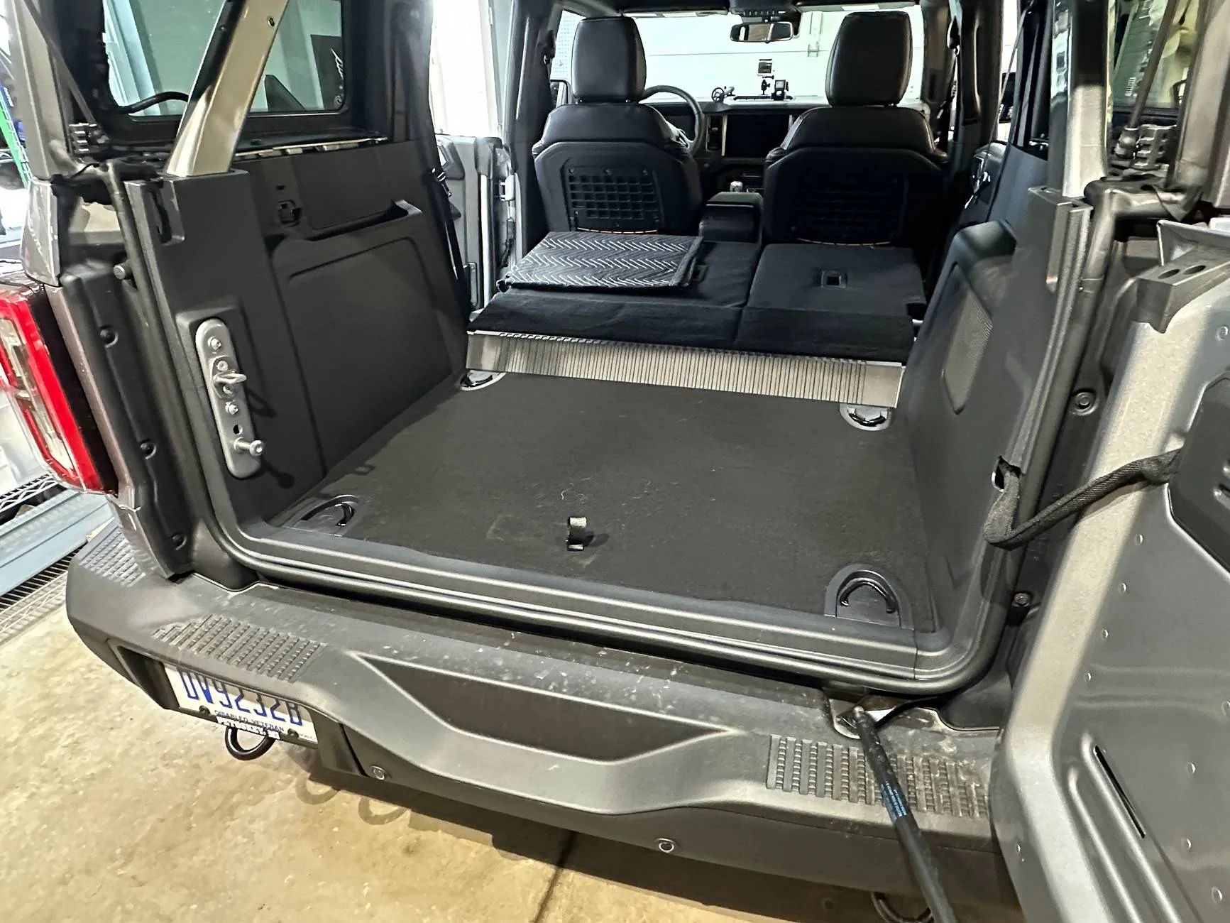

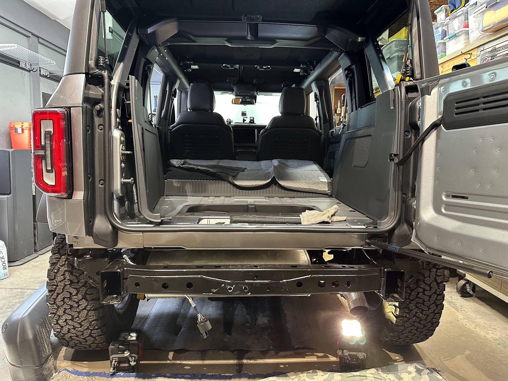

So what started as me going about installing the Ford Factory Hitch VP2DZ-15A416-B trailer tow kit morphed into more things SINCE I was there. I pulled the factory bumper off my 24’ Badlands w/hilux package. Removing the six bolts was fairly easy. Once I had that removed. I cleaned up all around the area on the frame. Watching many many car restoration shows. I figured. Why not add a couple coats of primer/paint to the frame since it’s exposed. Additionally take a look deep inside the two frame ends. I cleaned that out. And wiped it down really good with isopropyl alcohol. And let it dry. Blew it out with air. Then I sprayed undercoating all inside the frame. I let that dry for two days. Then I top coated it with satin paint to add more protection. I can just see pockets of dirt and sand get here and difficult to clean out. So rust proofing it more. The bracket was taken off that houses the factory harness for the 4/7 pin adapter. Also I pulled the driver side C242 plug and found my Blue/White wire. I’m going to tap into this wiring to run a small wiring harness I’ll make that will power a small set of lights hard mounted on the top side of the bumper corners. (I’m sure in a year I’ll just upgrade the whole rear bumper but for now I’m using it as is.). I already have the headlight switch with front and rear fogs light buttons. And it’s already activated in FORScan.
Ford Bronco Adding Rear Factory Hitch, adding boom mat (sound deadening), upgrading Sub IMG_3859
Ford Bronco Adding Rear Factory Hitch, adding boom mat (sound deadening), upgrading Sub IMG_3861

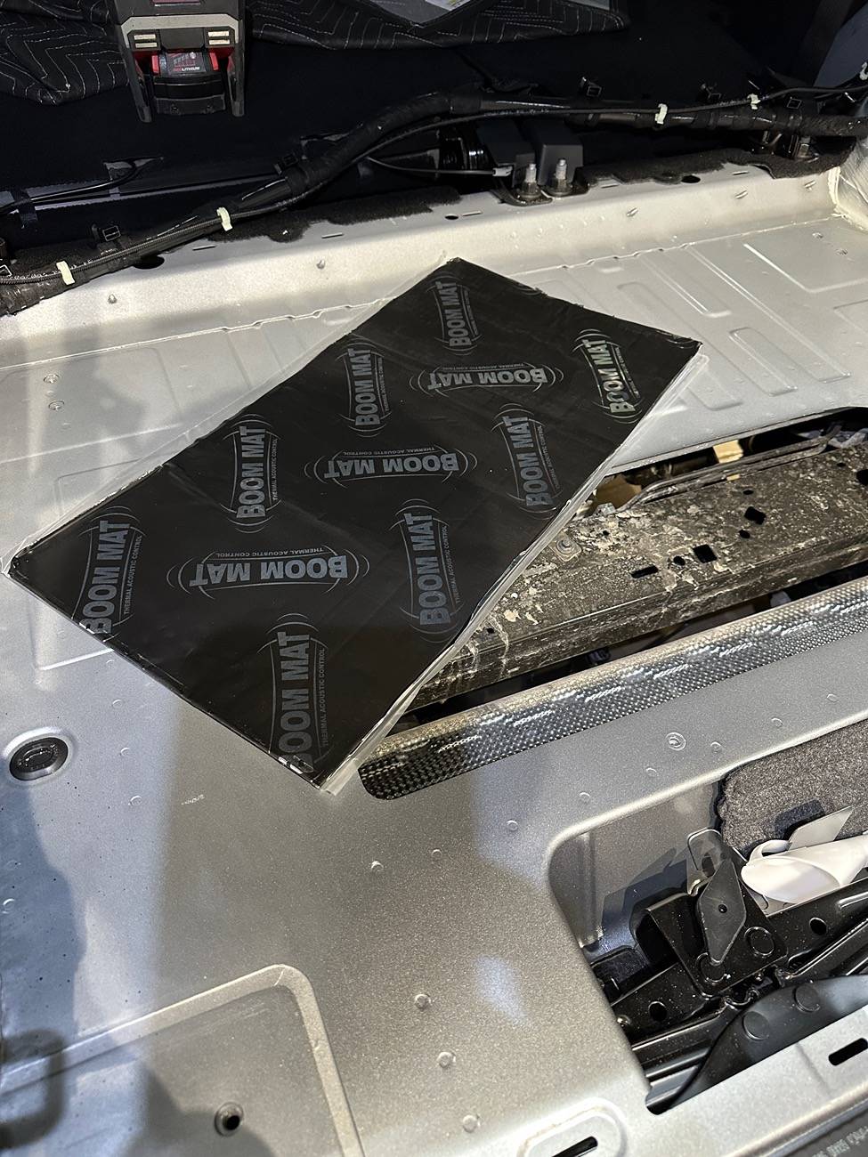

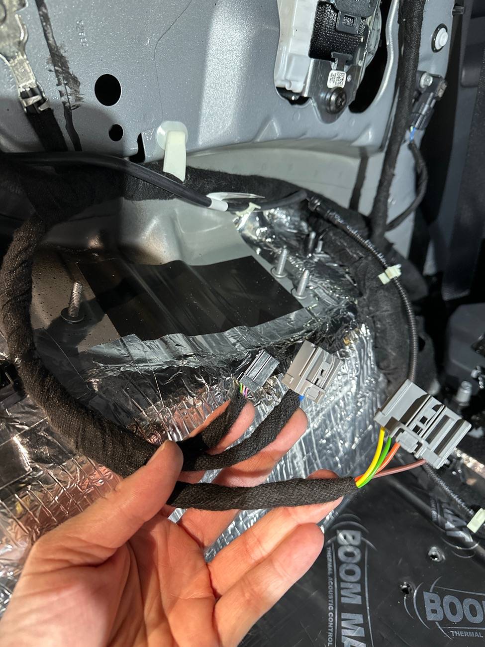

Once I started pulling the inside panels out. I started adding boom mat for better sound deadening. As well as thermal foam roll. Now this stuff we used when I was building tiny houses and wrapped ducting up to keep it quiet and insulated.
Ford Bronco Adding Rear Factory Hitch, adding boom mat (sound deadening), upgrading Sub IMG_3901
Ford Bronco Adding Rear Factory Hitch, adding boom mat (sound deadening), upgrading Sub IMG_3887
Ford Bronco Adding Rear Factory Hitch, adding boom mat (sound deadening), upgrading Sub IMG_3900
Ford Bronco Adding Rear Factory Hitch, adding boom mat (sound deadening), upgrading Sub IMG_3891

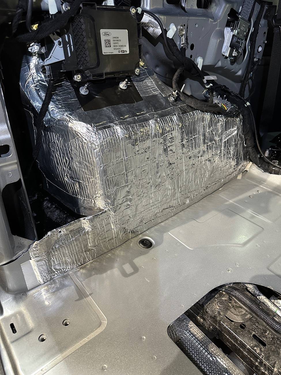

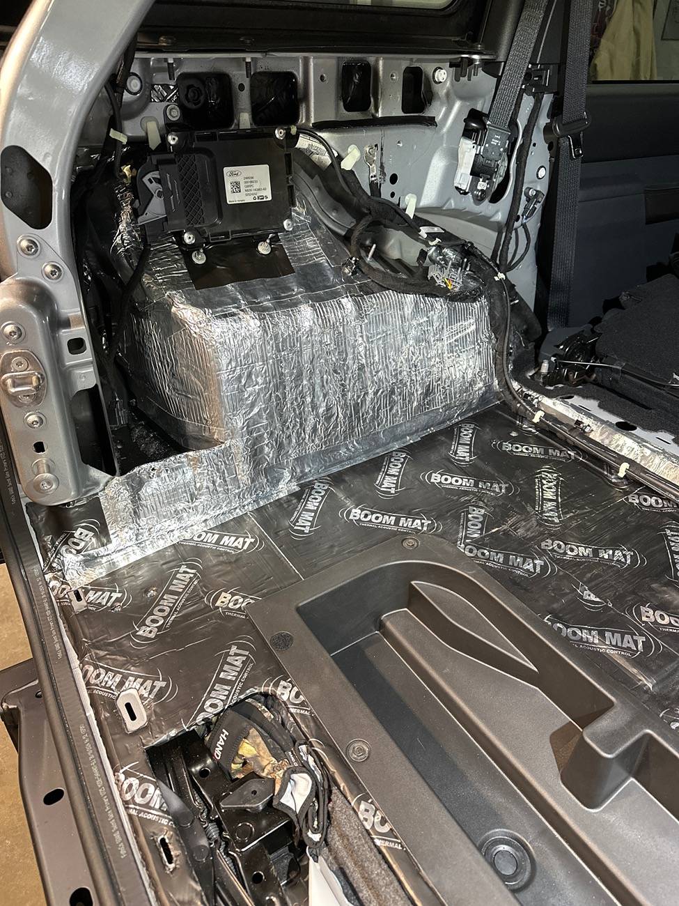

The foam roll is really sticky. On a clean surface this stuff works great for knocking down the noise. And provides a heat barrier. Putting it over the wheel wells I imagine it to reduce tire road noise. I removed all the modules bolted to the wall so I can get as much in as possible. I also used special Nashua tape products to add adhesion on the seems and sides.

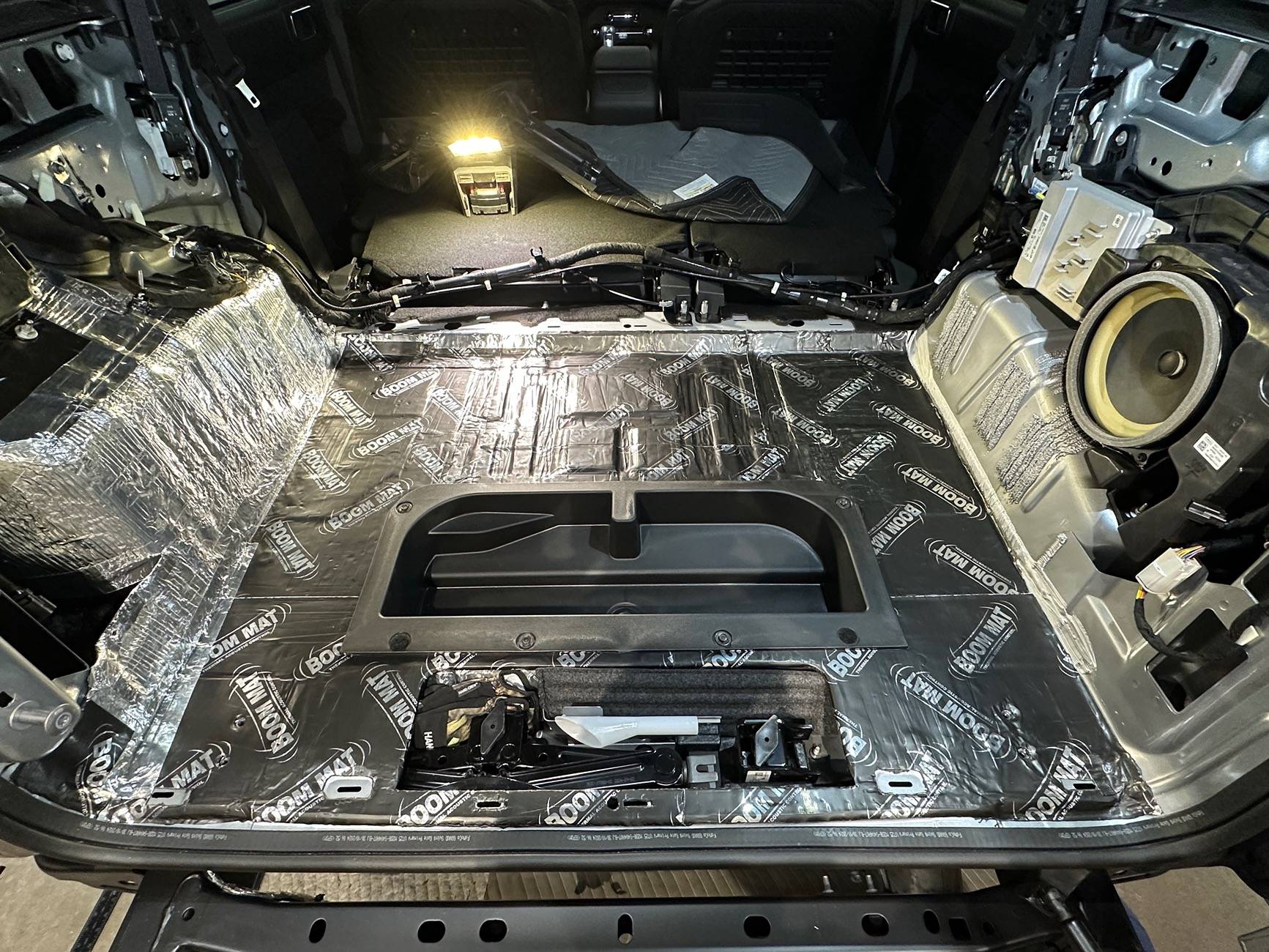

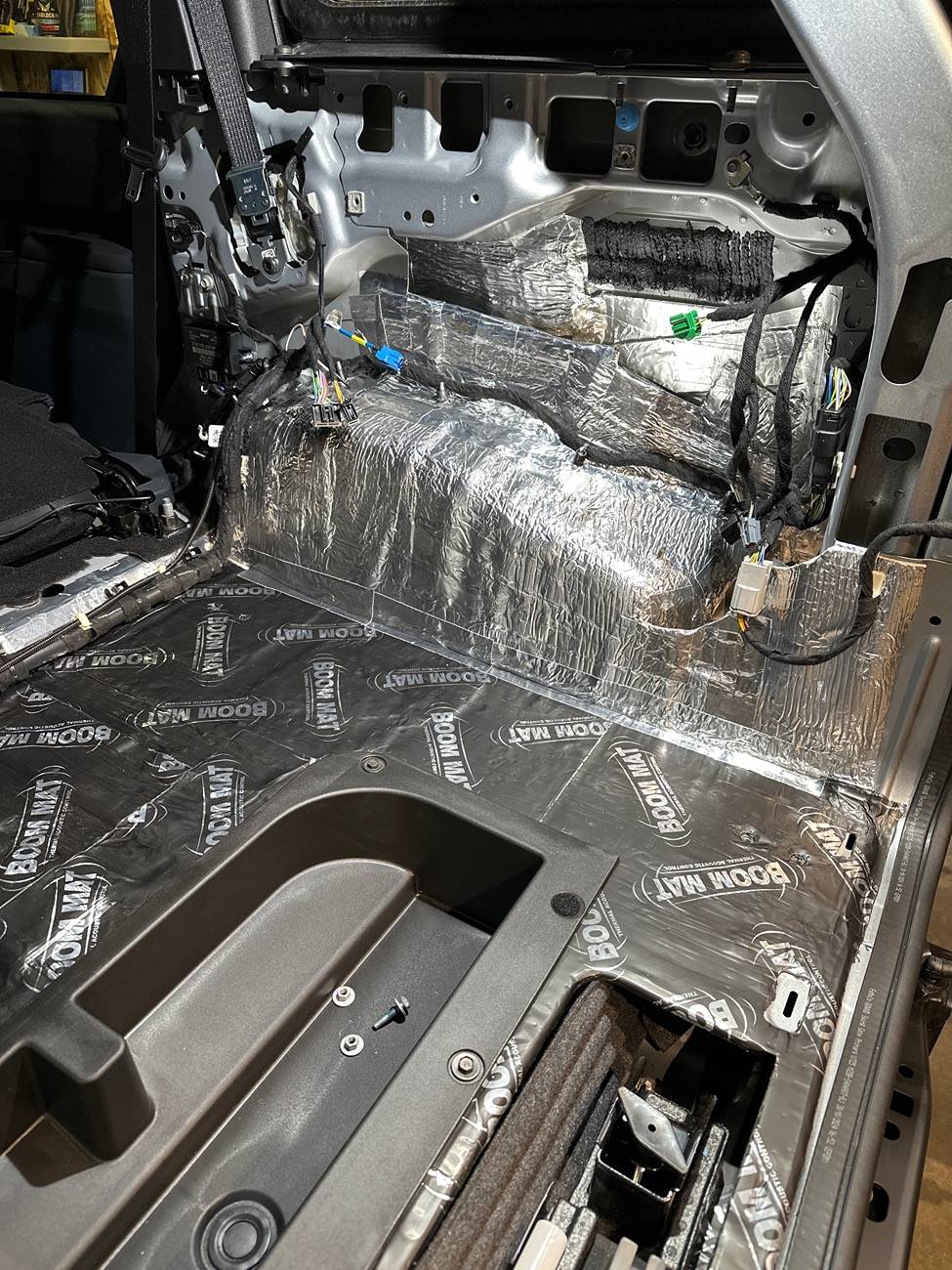

Here you can see it applied. I get it at HVAC supply places. I’ve used it on the floor board of my 1980 C3 vette under the carpet and it works great again for noise and temp control.

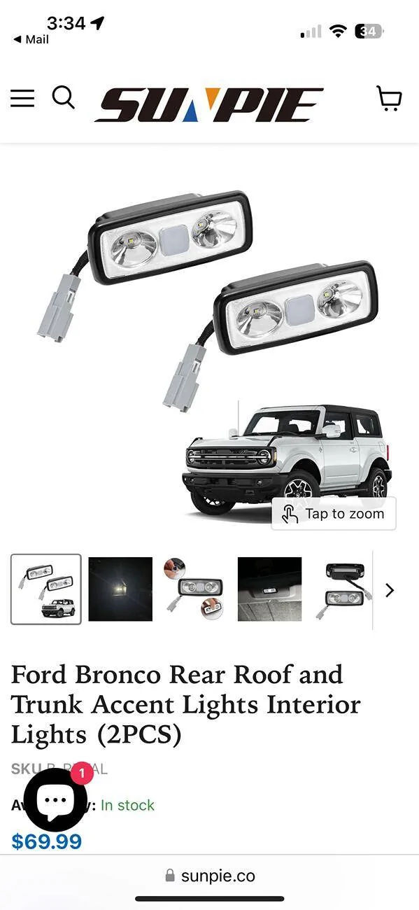

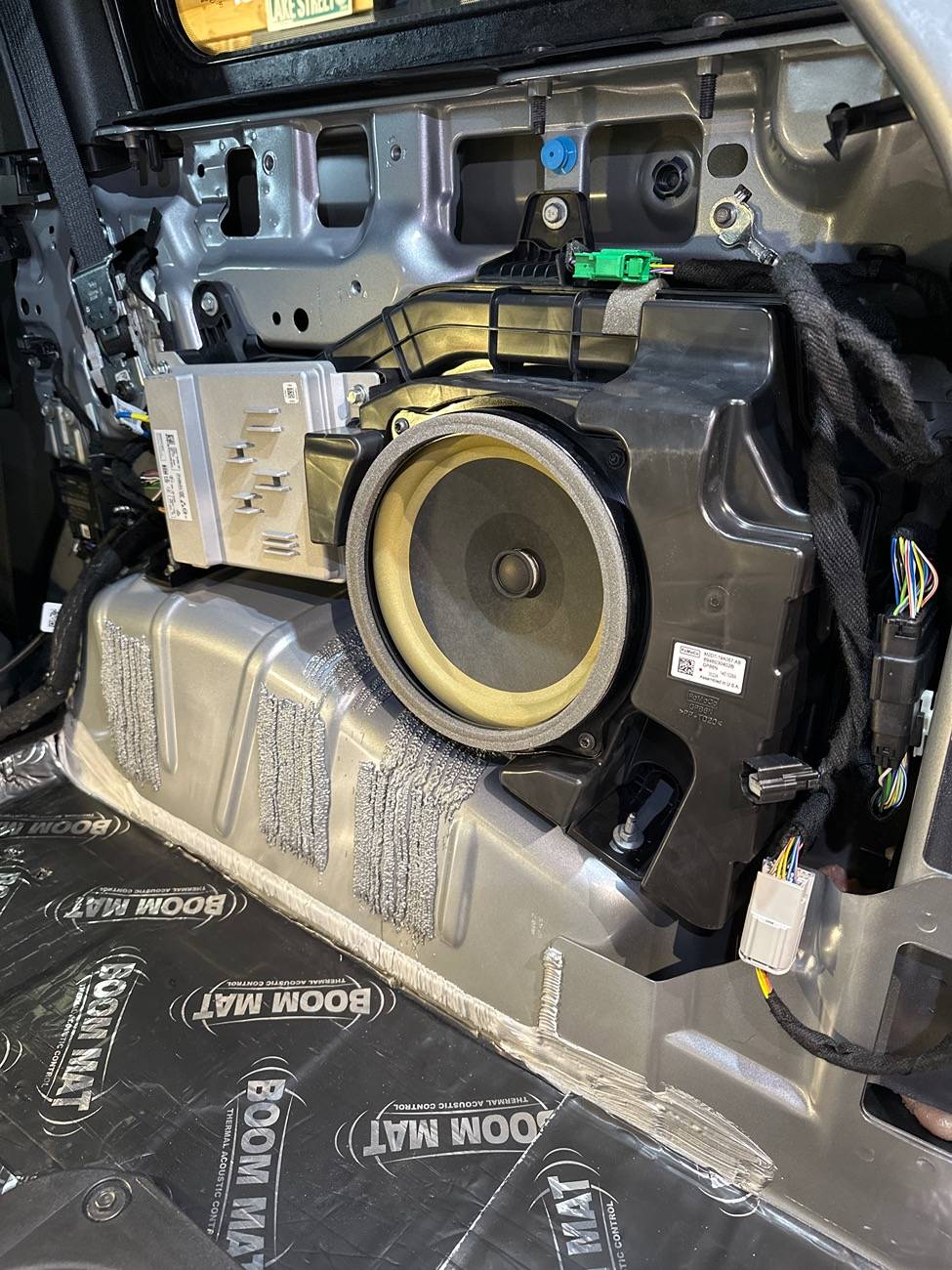

Additionally since I’m pulling wires apart I am going to upgrade the two interior lights and possibly figure out how to put an overhead led light with a switch.
Ford Bronco Adding Rear Factory Hitch, adding boom mat (sound deadening), upgrading Sub IMG_3904

I did order the Kicker 8” dual voice coil 4ohm sub to swap out in the BnO sup enclosure. My badlands has the BnO sound system.
Ford Bronco Adding Rear Factory Hitch, adding boom mat (sound deadening), upgrading Sub tune 7
Don't forget to plug the port!

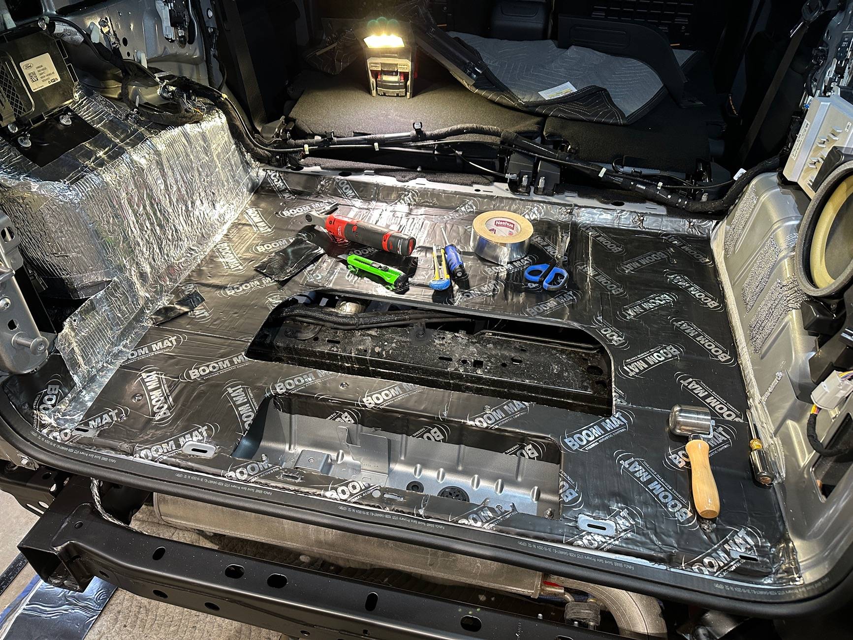

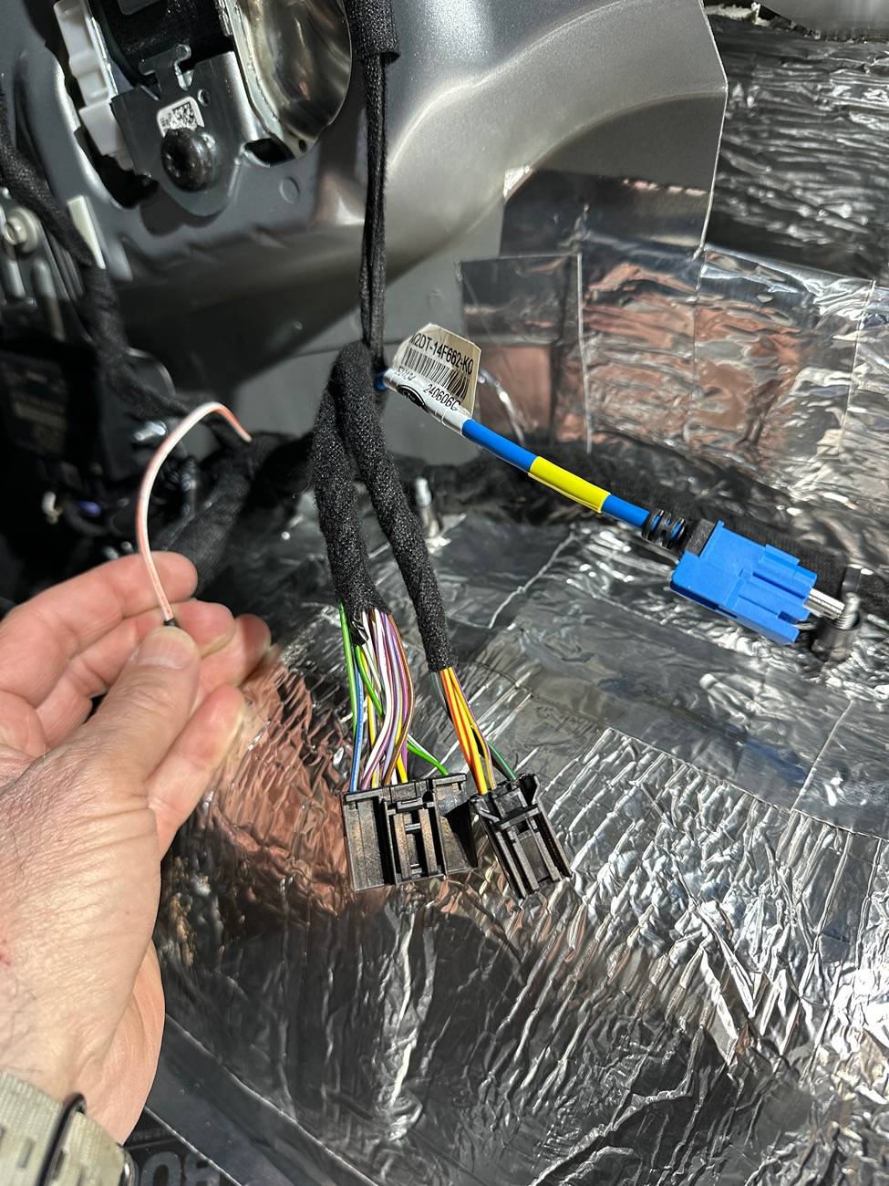

Got all the sound deadening done. Ready to install the tow control module. And I found the Orange/White tire to hook into the Aux switches.
Ford Bronco Adding Rear Factory Hitch, adding boom mat (sound deadening), upgrading Sub image
