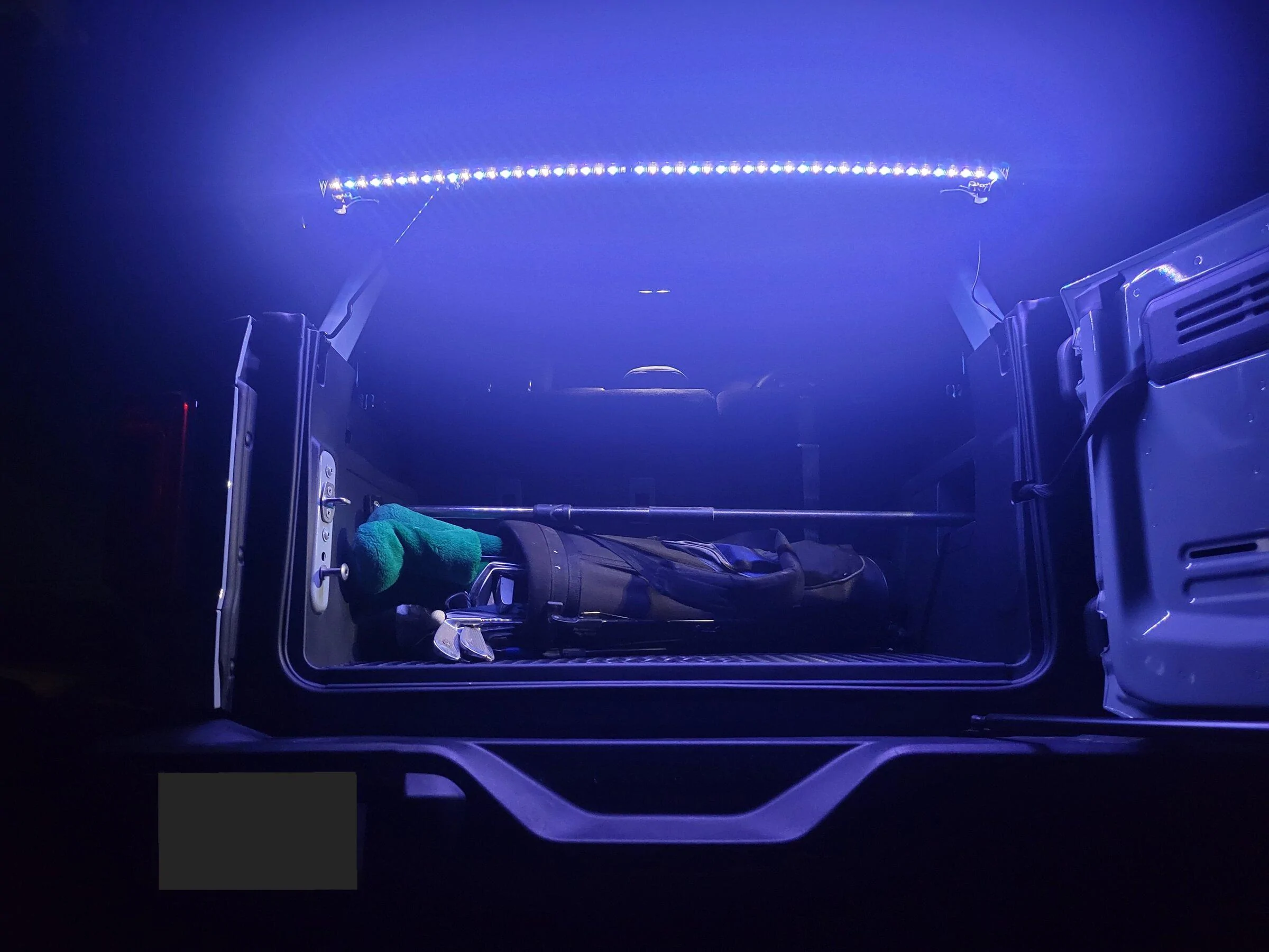

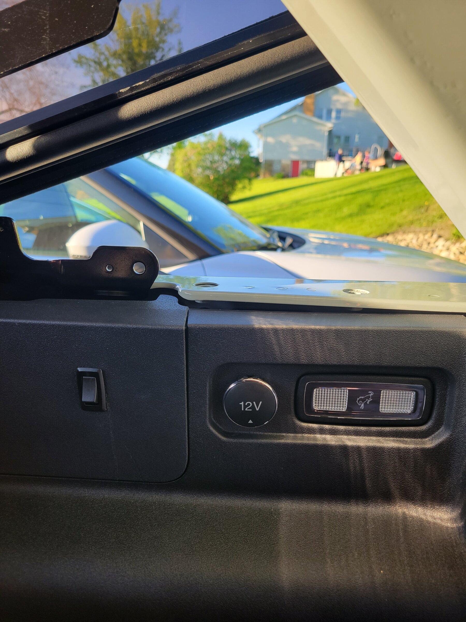

Great job. I did something similar with mine except I used a std. Usb Led light strip hardwired into the 12v outlet with a 12v-5v converter and a switch.
I like this. How did you run the wiring? Do you have links to the components you used?

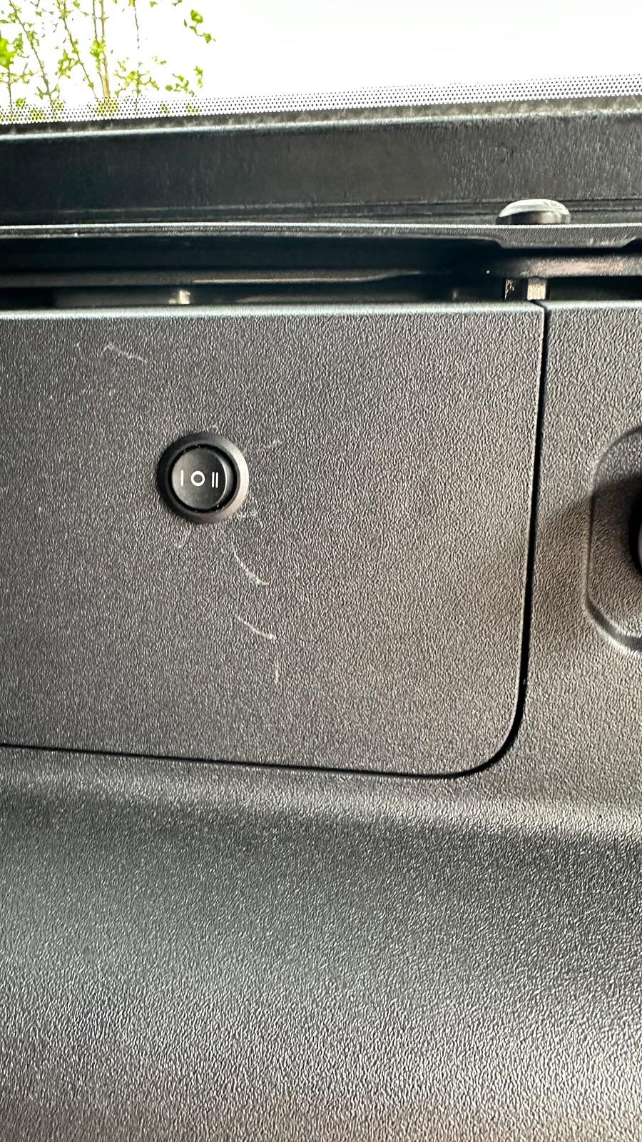

does anyone know if you can remove the light without breaking it. I want to add this extra light in my bronco, but its a 2 door and there is no panel to access the wiring.
mustanggarage
chad
Nov 13, 2021
112
367
Iowa
2018 F150, 65 mustang, 71 bronco
well I figured out how to remove the stock dome light to access the wiring on a 2 door and have my lights working now. I am not sure how satisfied I am with the solution after going through all the trouble however. that 1 hour cutoff is pretty limiting. many times when I want to get into the back of the bronco and do something the truck has been off for more than an hour. it is kind of irritating to have to go turn on the accessories in order to get my light to come on. it might be better in retrospect to wire it to my stock dome light wiring. then I could turn it on anytime I opened the door. IDK I will live with it like this for a while and see how I like it. either way I still want the light bar to be activated by a switch so it doesn't turn on everytime I open the doors.
