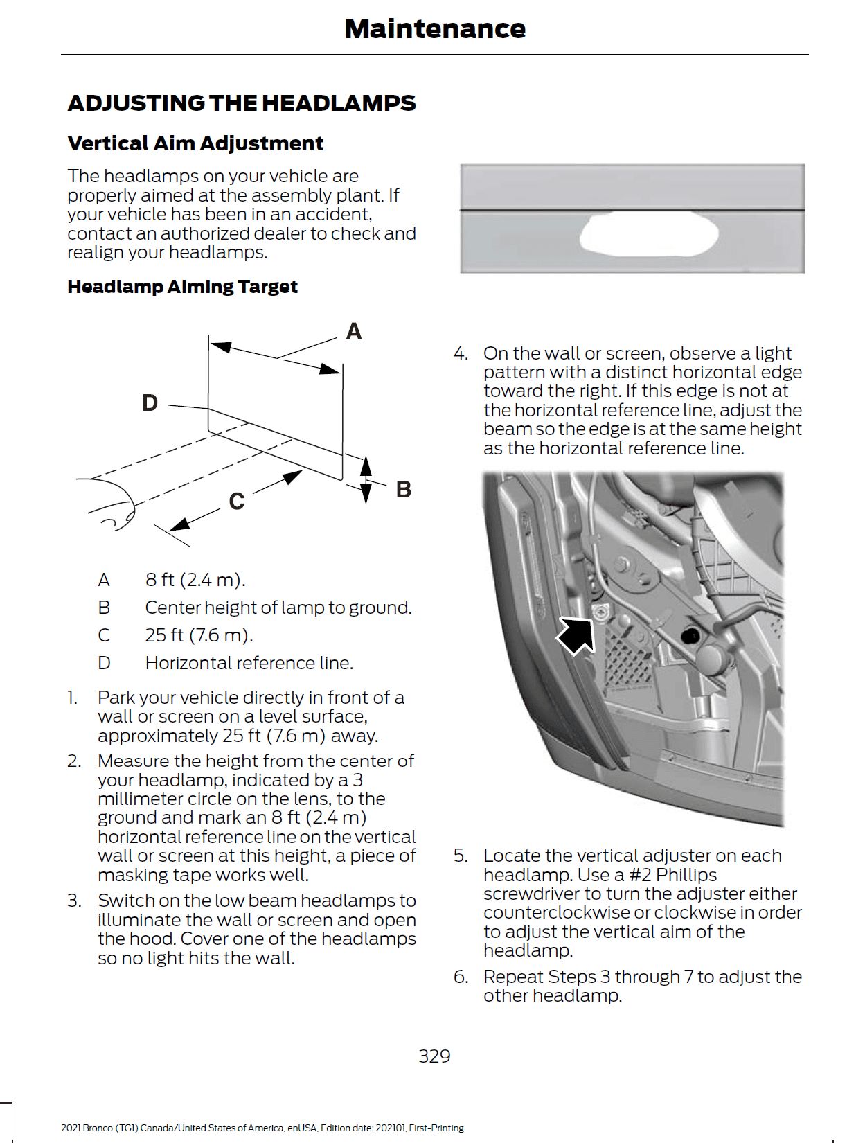

The exact procedure is on pg 329 of Bronco owners manual. 2 or 3" of lift isn't significant, but you can set it slightly lower if you are worried about it.
I don’t have a full paper owner’s manual, and I can’t find anything for adjustment on the in-vehicle owner’s manual or the html one online.
Can you please take a picture or list out the procedure? I’m getting level kit installed in a couple of weeks and would like to know how to adjust the headlamps.
Ford Bronco Adjusting headlights after a lift? What method? 1641491513830
