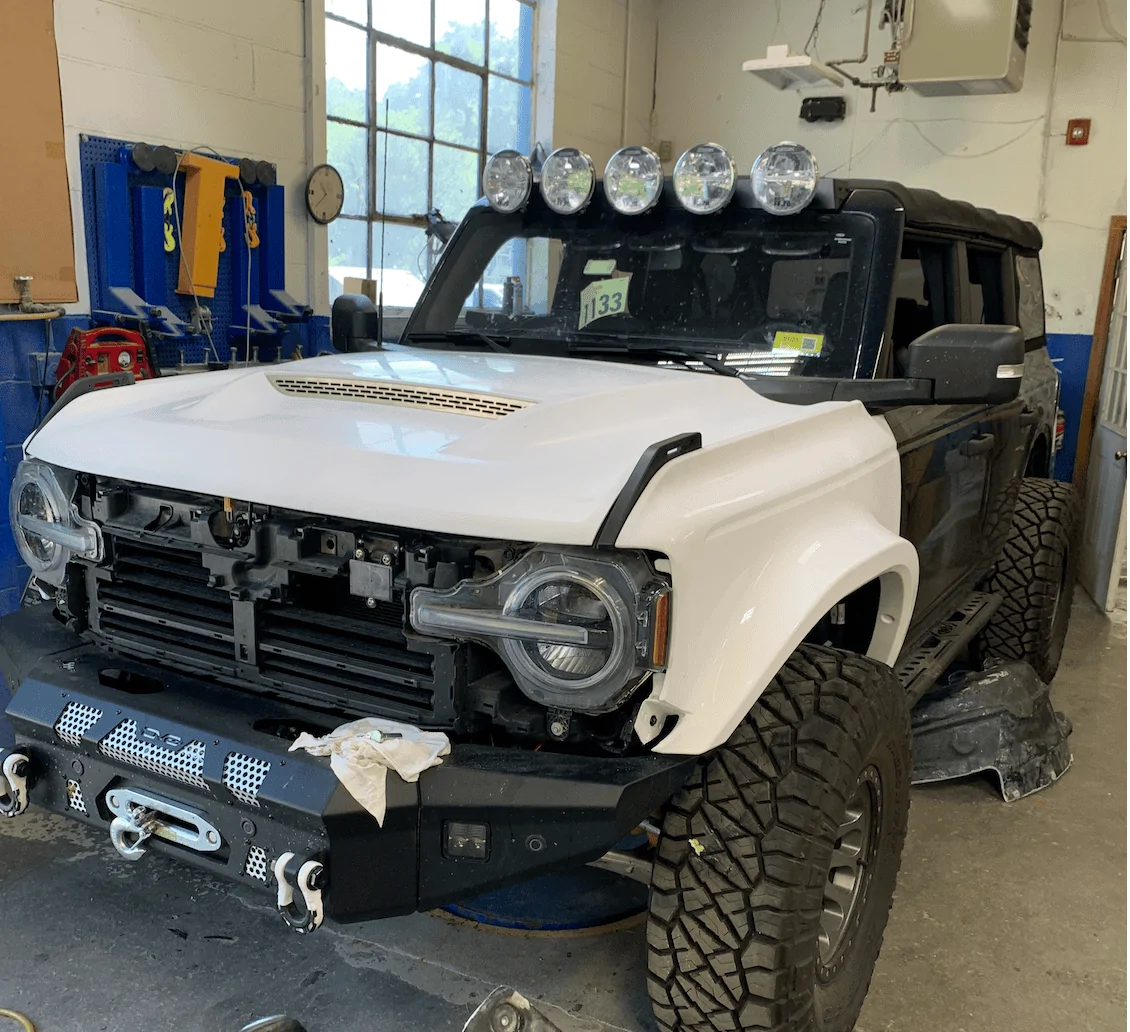

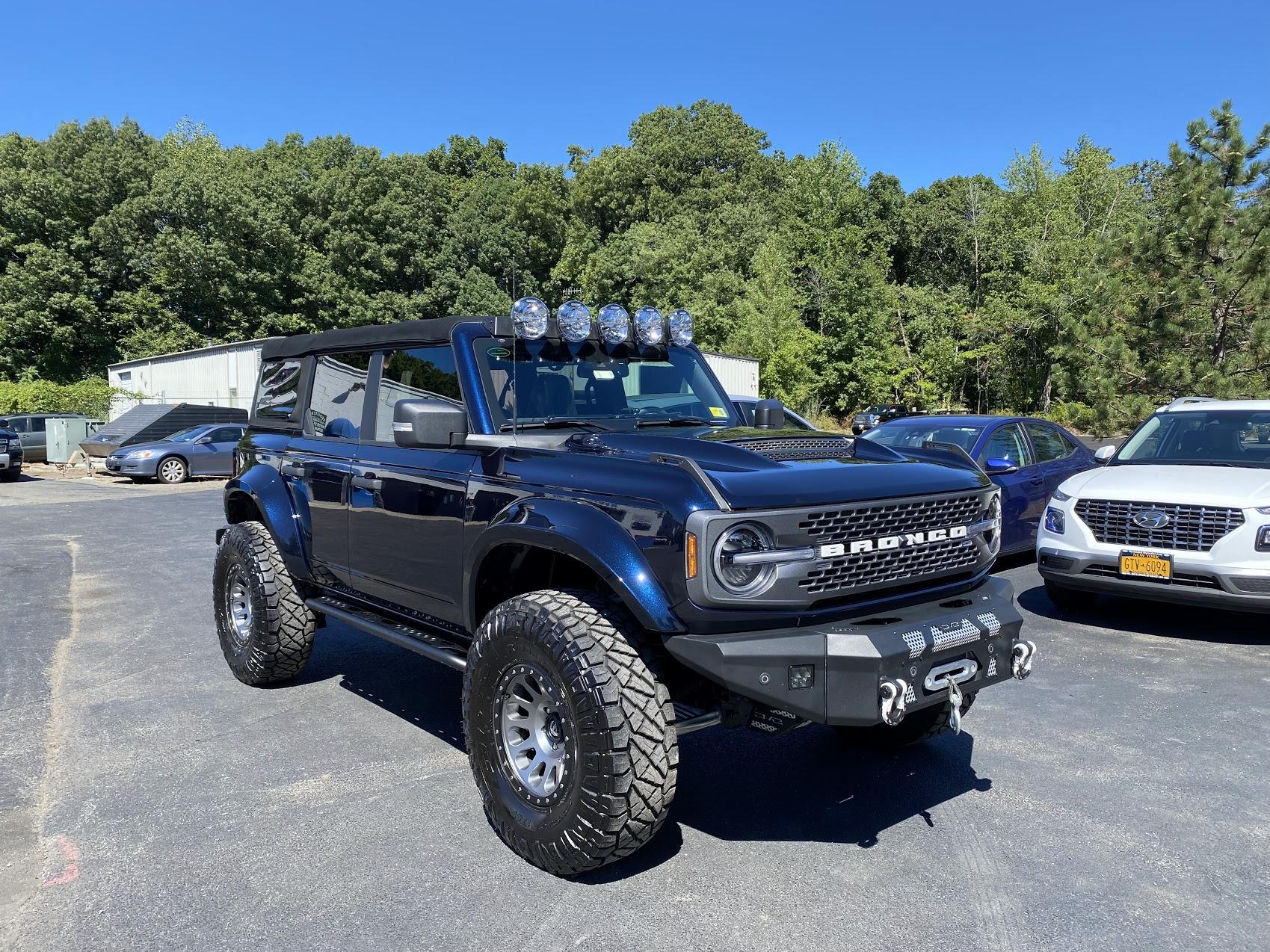

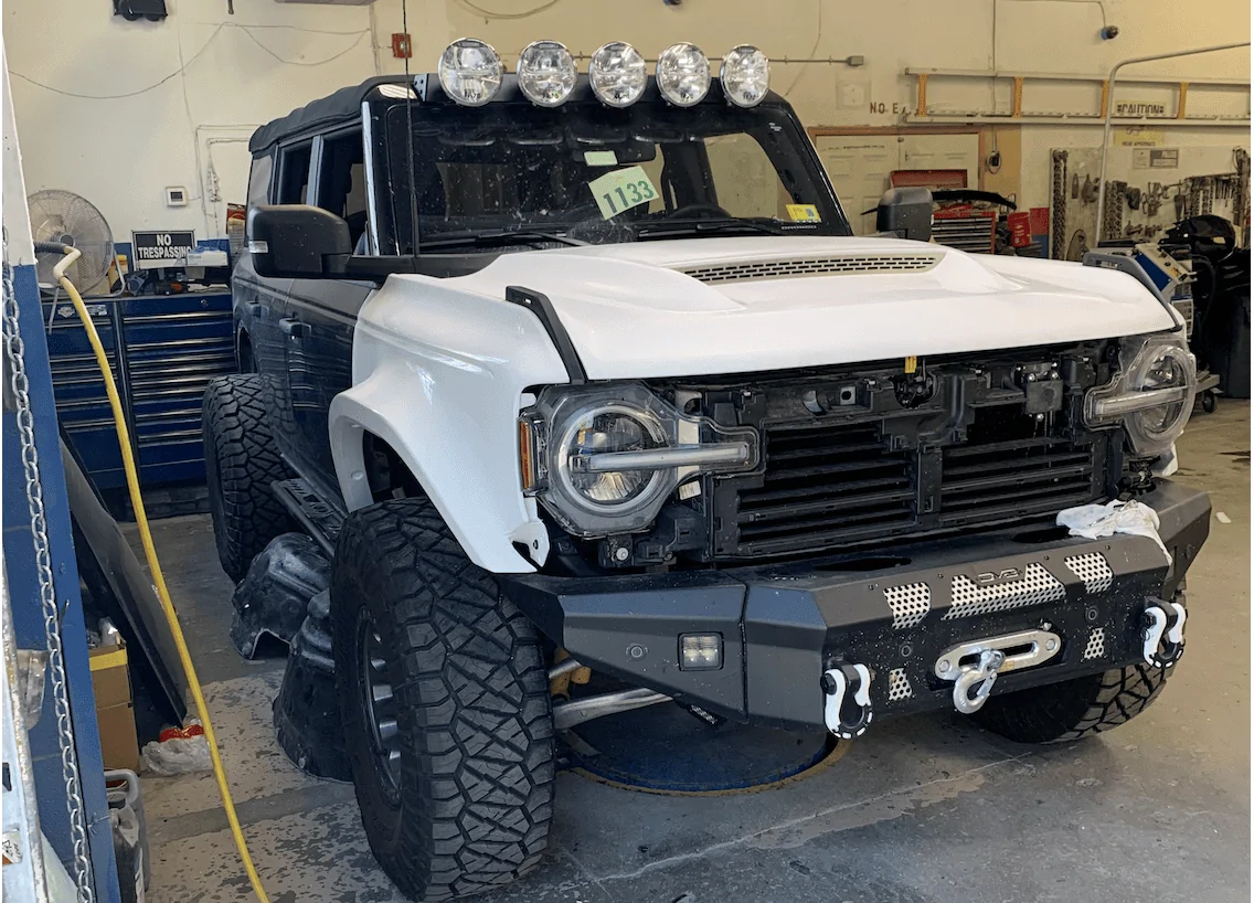

I just installed these. Can you show a final picture of that front corner with the valance panel installed. Not sure mine look correct.
i can take better one tomorrow in daylight..

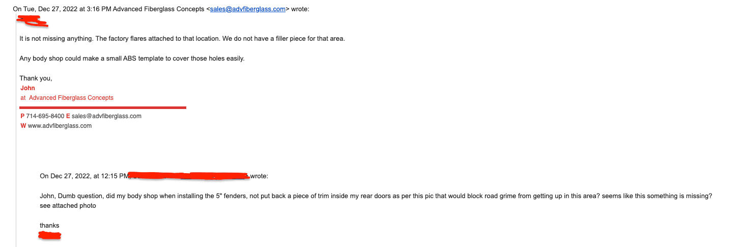

Can someone with the 5" fenders open the back passenger door and show me the jamb and the inside of the door. I have holes where the old fender mounted to the body and a gap where the small radius piece attaches to the door.
GreenMtnBronco
GreenMtnBronco
Jan 5, 2021
579
1,018
West Nyack NY & Central VT
'21 BadSquatch; 13 Wrangler JK; 04 Lifted Mini
i asked about that and this was the reply -
Ford Bronco Adv Fiberglass Fender & hood experiences? 1677600975691
