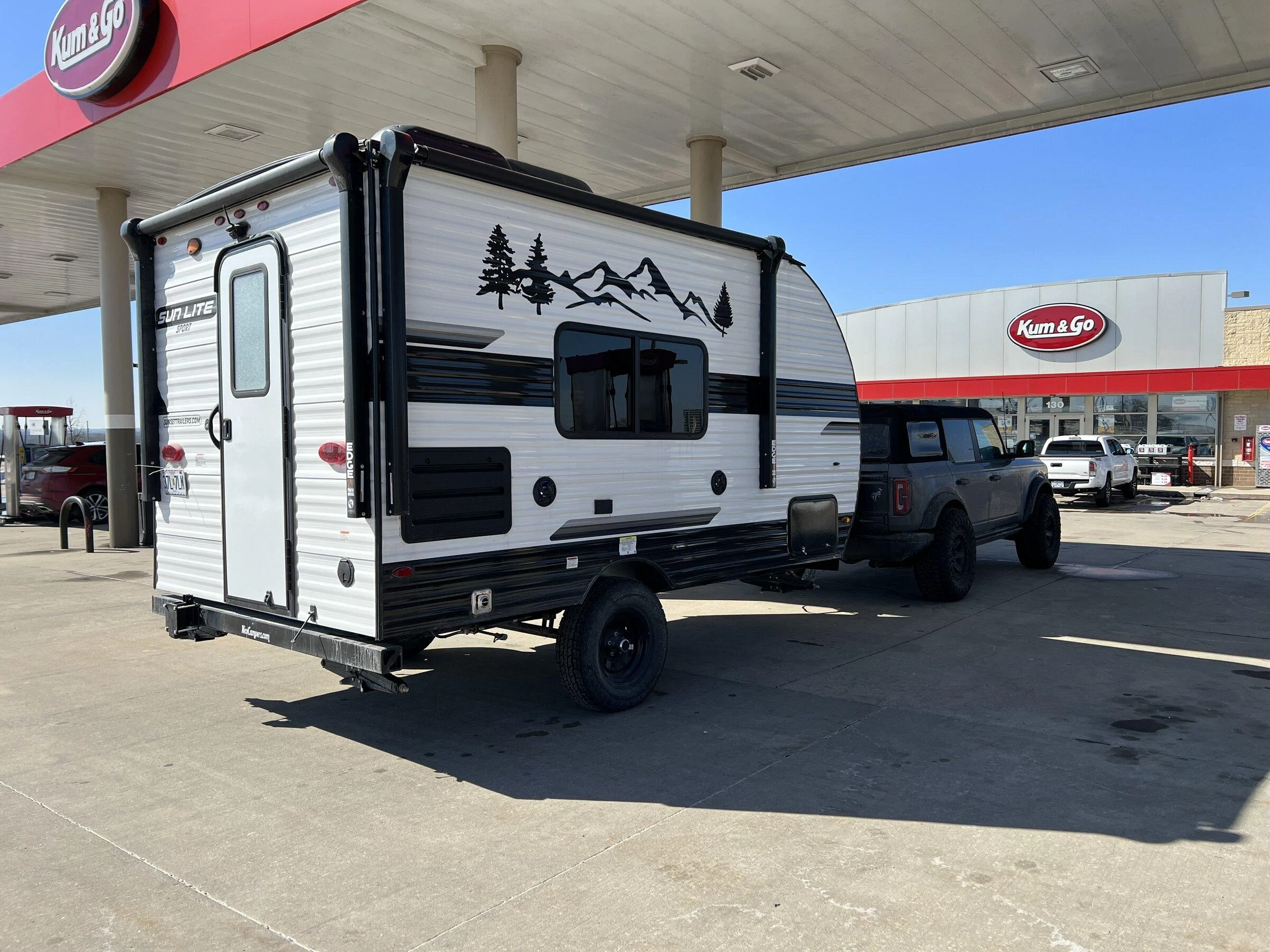

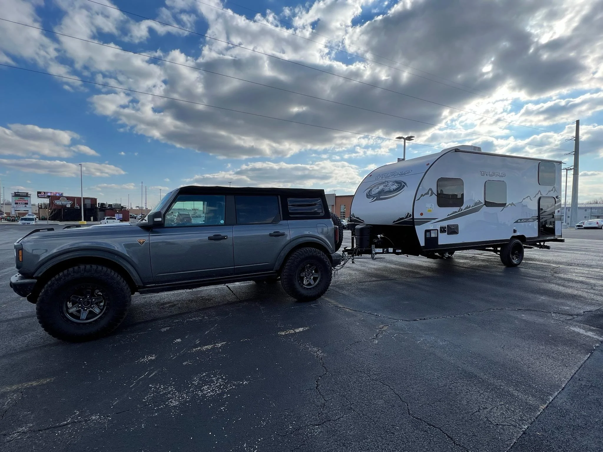

Flexing? maybe you have something wrong no issues on flexing and at 3386lbs. I do use a load distribution hitch. 4dr badlands 2.3 l auto non sasquatched (with 35x12.5 tires) one with latest trailer and one with previous trailer with 3100lbs loaded. I have done a few trips of 500 plus miles. plenty of power and no issues. just be aware and drive at reasonable speed(i did 65 even when speed limit was 70). You will have plenty who be glad to tell you cant do something( I will state it is not over my weight limit!!!!!! it is close but not exceeded so slow down and drive safe. Your Bronco will surprise you. I agree that the Bronco could very easily pull 5000 lbs safely if drive accordingly but the legal limit is 3500 lbs or slightly under.
