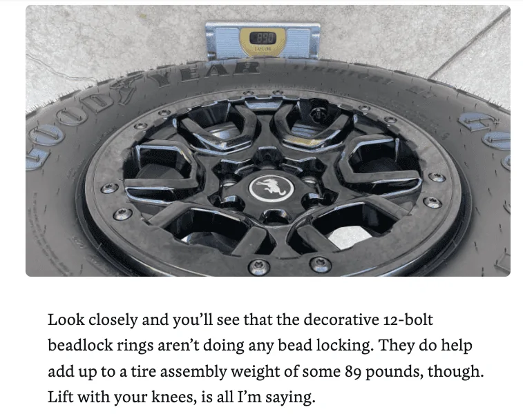

Anyone thinking about replacing the sasquatch OEM 12 bolt beadlocks beauty rings with more capable 24 bolt rings. The 12 bolt doesn't actually do much for airing down.
You cannot use the beauty rings as beadlock rings, they will not seal the tire to the rim. Go buy some true beadlock rings from Ford.

My suggestion to the OP is that if he doesn't understand how beadlocks work and what the functionality of them is, he most likely doesn't need them. If you just want them to be a different color, un-bolt your beauty rings, paint or powder coat them, and bolt them back on. Simple as that.

appreciate the info to both responders, was actually fishing for the former answer ... any idea where to find true beadlocks that Ford sells? Havent seen anything on the accessory site or any other info aftermarket solutions. My question stemmed from the screen shot below. i have an idea how beadlocks work, i air down to about 18psi on the trail, but hoping to get more grab from my wheels and an even lower psi, and add more function to the beadlocks than just "beauty"
