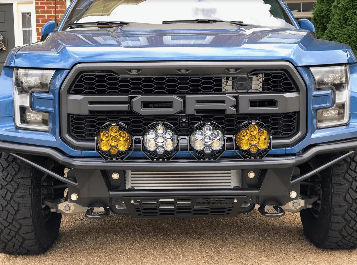

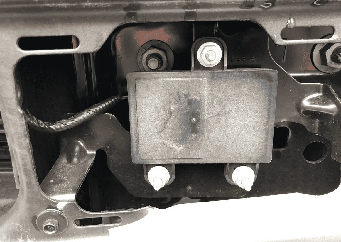

That is interesting that ADD is making a bumper that will accommodate the ACC sensor for the Ranger because they make about 10 bumpers for the Raptor and none of them will accommodate the ACC sensor. BTW, NO aftermarket Raptor bumper accommodates the ACC sensor.
And if you have a Raptor equipped with the ACC sensor then you will have to relocate it. ADD will sell you that bracket for $250+ which prob cost them $10 to make.
And the ACC sensor is very delicate. Relocate it and get it all wrong and it will not work properly. There are a few guys on the Raptor forum that have issues after relocating the ACC sensor and then visited a dealership asking for a re-calibration and was turned away as Ford will NOT re-calibrate a sensor that has been move to a new location.
BTW ... I have a 2019 Raptor running a SVC bumper and I had to relocate the sensor. I was very careful to measure and make sure all the angles were duplicated in the new location. I was fortunate as my measurements were 100% correct. See pic below. The relocated ACC sensor is above the letters "R" and "D"

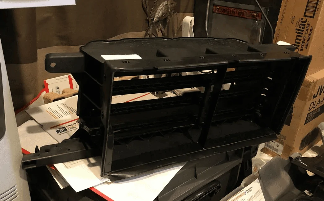

2 - Behind the bumper will be a shroud directing air into the intercooler and right in front of the intercooler are louvers that can close or open (see pic below of my Raptor shroud and louvers ... it is a 1 piece unit on the raptor which I have removed). So the aftermarket bumper will have to make room for these items.
And if you have a Raptor equipped with the ACC sensor then you will have to relocate it. ADD will sell you that bracket for $250 which prob cost them $10 to make.

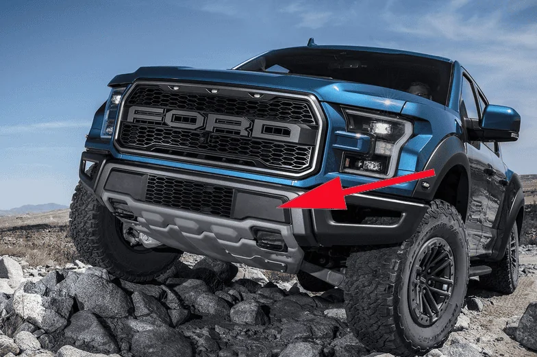

See pic below. It is located behind the plastic piece. You would think that a centered mounted sensor would be much easier to deal with as in calibrate. BUT NO Ford mounted to the side of the bumper because of this, the mount itself angles the sensor back to the center. I am certain at the factory when mounting the sensor they must have some process where they calibrate the sensor.

@Raptor911 Where was the sensore before you relocated it? Was it front and center of the original bumper or somewhere else? I am wondering if you went up and over with the relocation or maybe just up? Seems like the less difference in original location the better of getting everything lined up correctly. All the times I have crawled under my F150 I never thought to look for the location of the sensor, guess I know what I am doing this afternoon.
