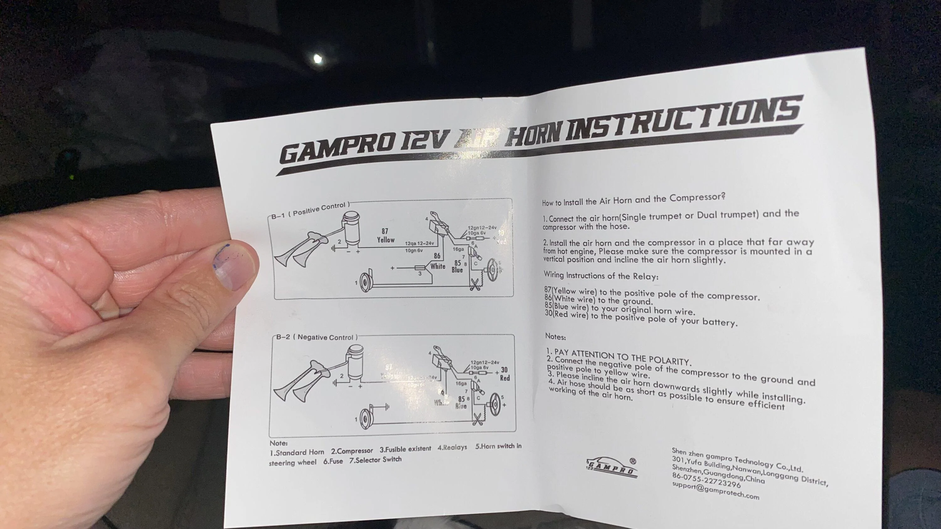

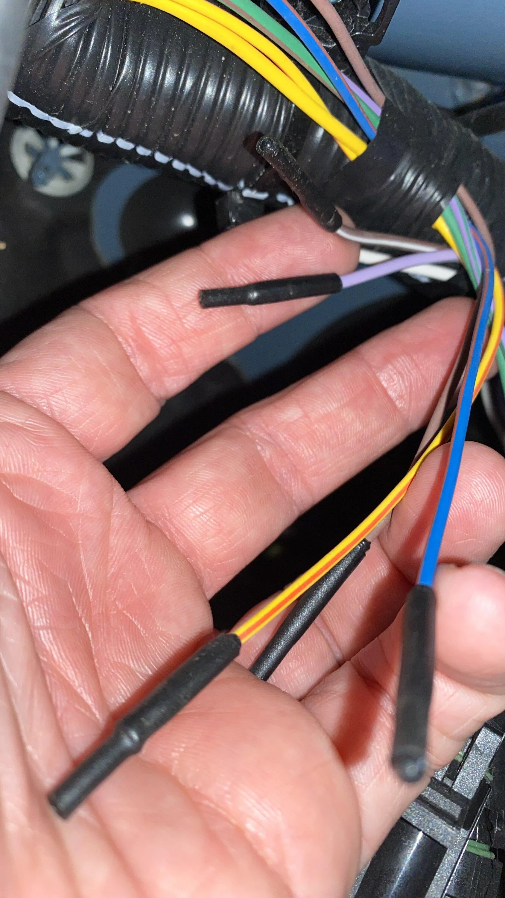

So I’ll start with I’m not the brightest and I have also bought an air horn for fun with the kids ( they are 8 and 10 and they, with their fiends, love to give the honk signal to cars so I thought I would surprise/maybe scare them! Worth 60 bucks and 15 mins in my opinion)…. However, I don’t know how to wire with the aux switches, maybe… I would like to wire to an unused aux switch until it is needed for lights. I already have 3 lights that I have wired up so I kinda get it, but I want to check with folks that are smarter than I… Attached is the the instruction. And some pics… I am thinking I should follow the b-1 positive control as I am not replacing the existing horn as I plan to leave that in tact for normal us and only use the air horn for fun/when I am really mad😂🤪.
so here are my questions…please confirm.
  1. I have a black wire that is not noted on the wiring instructions, which is weird. why not note that… but black directly to neg battery term.
  2. Got yellow figured out
  3. White to one of the many ground screws points?
  4. Blue to an aux switch pre ran wire?
  5. Red to battery term
Also, I just noticed two extra wires (next to my index finger) beside the 6 pre run aux switch (or at least that is what I believe) what are those for?
Last question, if I want to do more than one horn can I just wire all this to the same aux switch? Any overload issue?
Thanks for any help!

Wire it all except the blue and then tap the blue on the battery positive terminal. If that works, then wire that blue to an aux switch.

All set, thank you! It was great seeing the smile on my boy’s face!! Even better when he said glowingly “it’s like the horn on grampa’s old fashion car”. It is too bad there are such dicks on this world that want to give people a hard time about something that is not there business at all. Thanks to those that offered help!

Your pic is of the uplifter switch wires. Pic the right color to amps needed. Connect your ground and blow all the people and wildlife you like...
