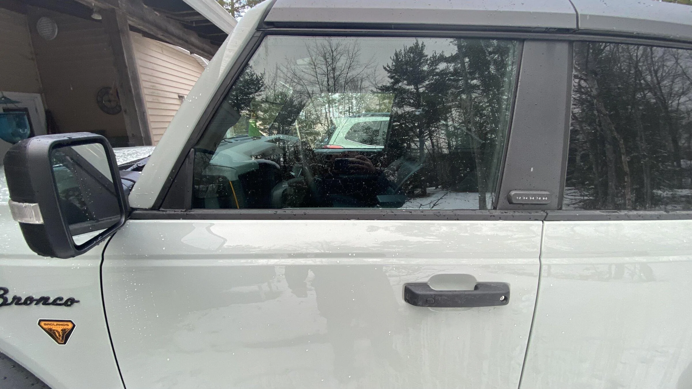

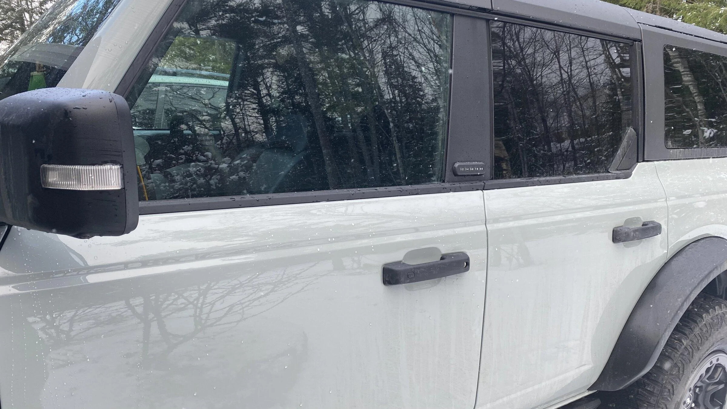

I removed the keypad with a little heat from a hair dryer and relocated it to the b pillar where it belongs…
lots if sticky left for it to adhere nicely.
(I cleaned the b pillar with alcohol)

That’s where it is on my gf’s Lincoln. The door makes no sense.

this is a big "duuuuhhhhh" now that I see it. I'm moving mine there

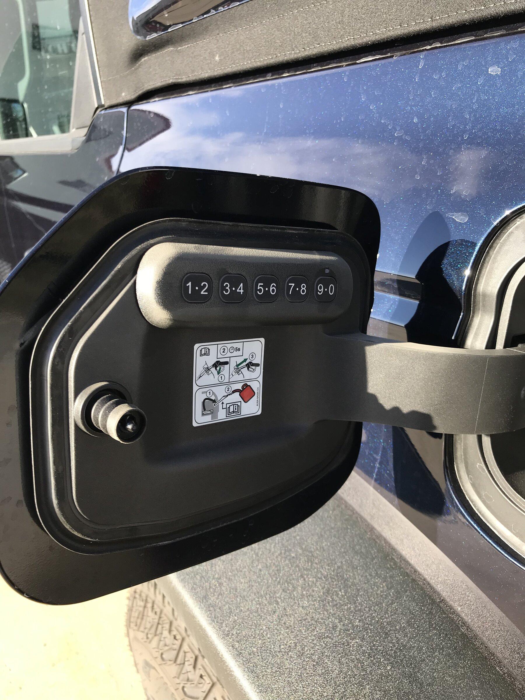

I have relocated mine to the inside of the gas door. Works great.
Ford Bronco Alternate Keypad Location AE401A27-30AE-4386-BD38-2A6074C1D97A
Although creative, I didn't really like this at first. Now that I know it's stuck on by nothing other than 3M tape, I find it more appealing. Much less likely to just fall off.
