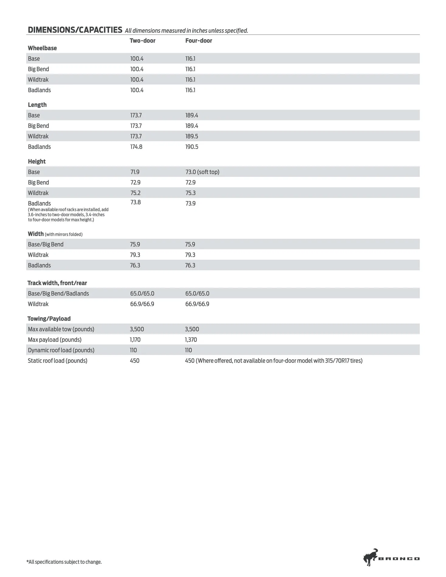

I need to be schooled, spec sheet shows Track width of all models except Wildtrak as 65". Wildtrack 66.9". There have been posts indicating the Sas would also be 2" wider (66.9ish). So how is this extra track width accomplished, wider rear axle? front control arm? spacers (God forbid)? special hubs bearings? And remember track has nothing to do with wheel width, it's measured face to face on the lug flange.
It's measured by the center of the tire's tread width.
Ford Bronco Am I missing something? Badlands vs Sasquatch option. 1600726189916
Since they all use the same wheel, my guess would be backspacing

Thanks guys, this makes sense.
So, all wheels except Wildtrack and Sas have 0 offset and Wildtrac and Sas have about an inch. My deffinition would be correct on a 0 offset wheel, but nothing else.

It is based off of the tires which are different.
No what I meant was squatch...and wt which includes squatch all use the same wheel. 1 in less backspacing...boom done!
