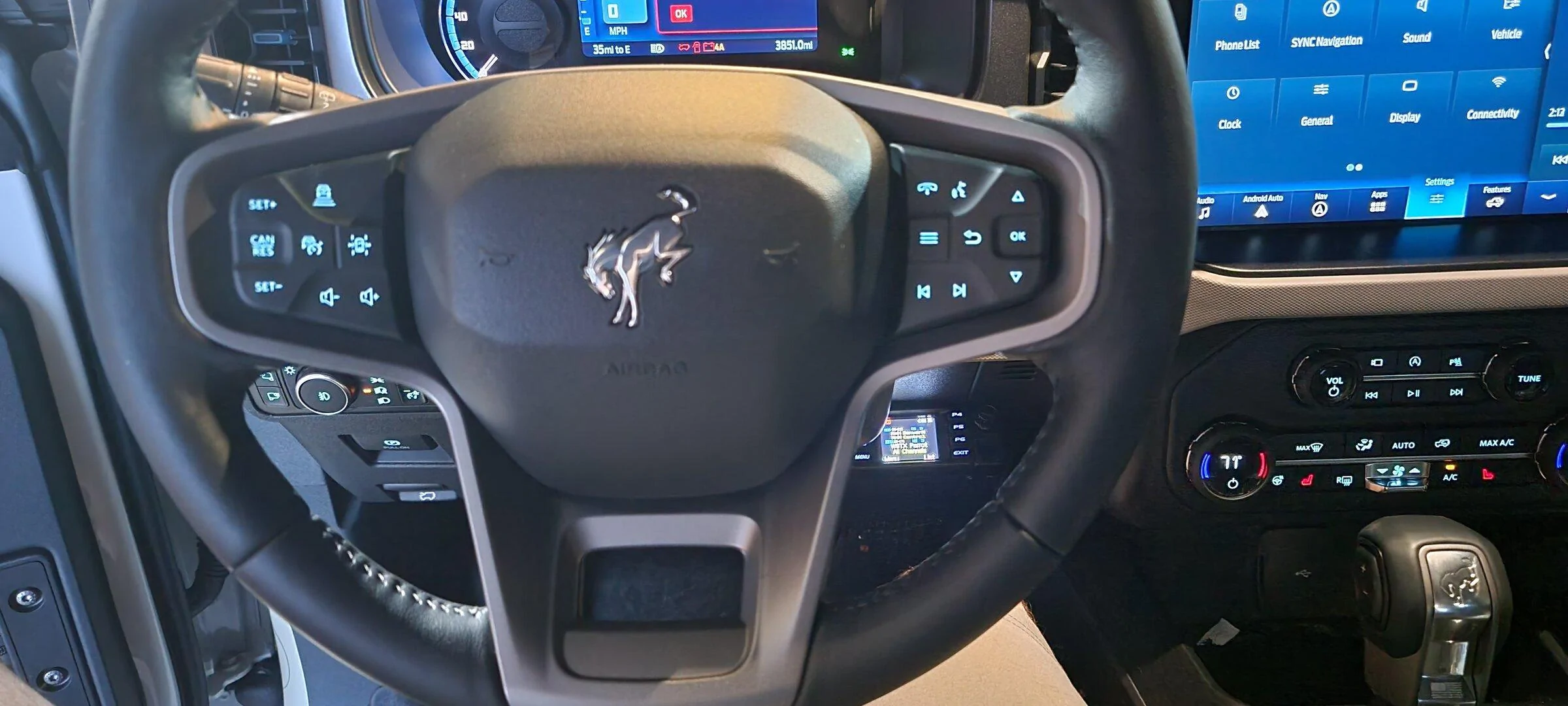

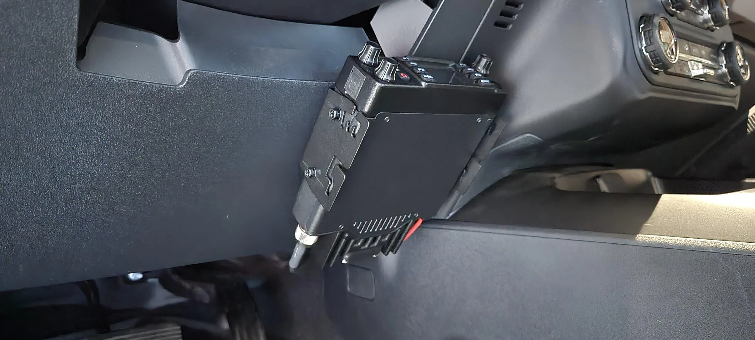

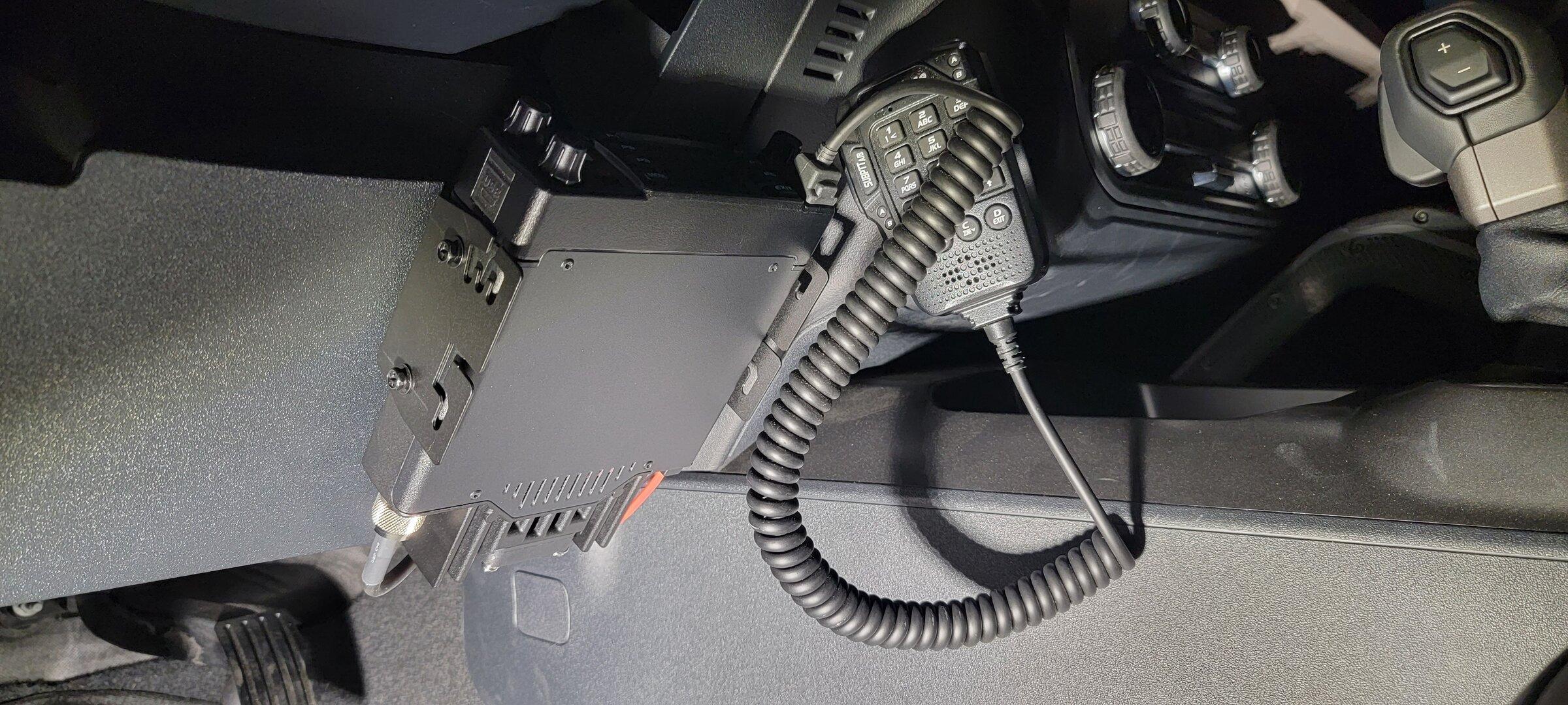

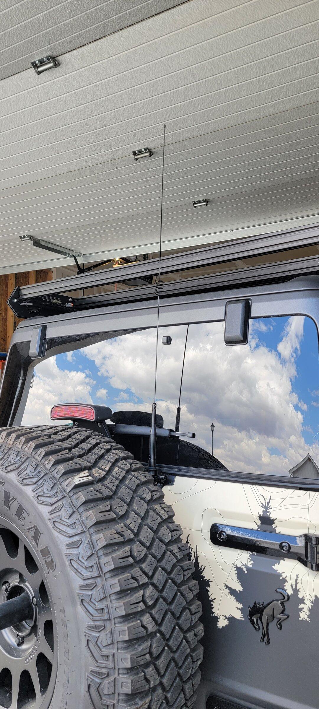

Any other HAMs in the group? Finally got my radio installed. I opted for the AnyTone radio instead of others with remote faces because of the large DMR network here in Colorado.
I lined the placement up so that I could see the screen of the radio through the hole in the steering wheel.

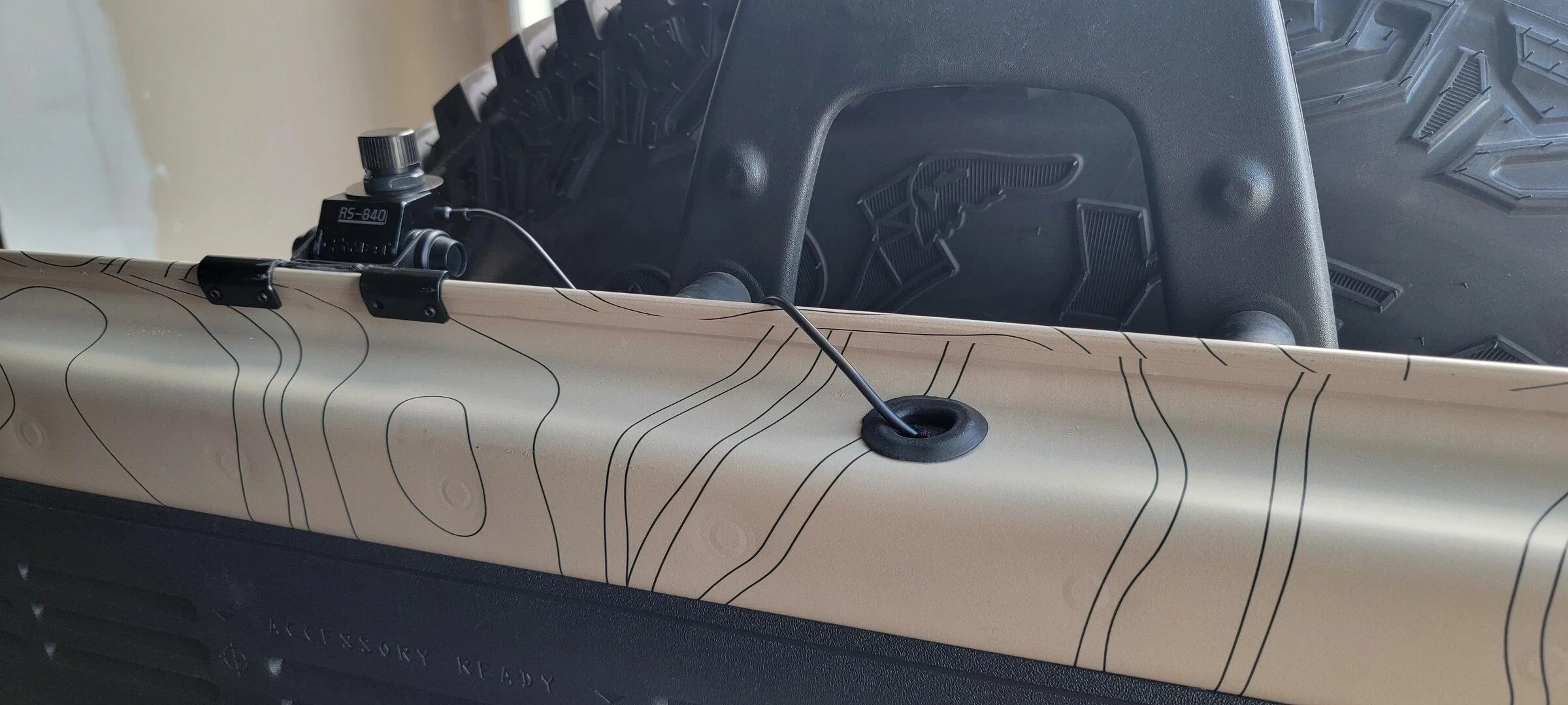

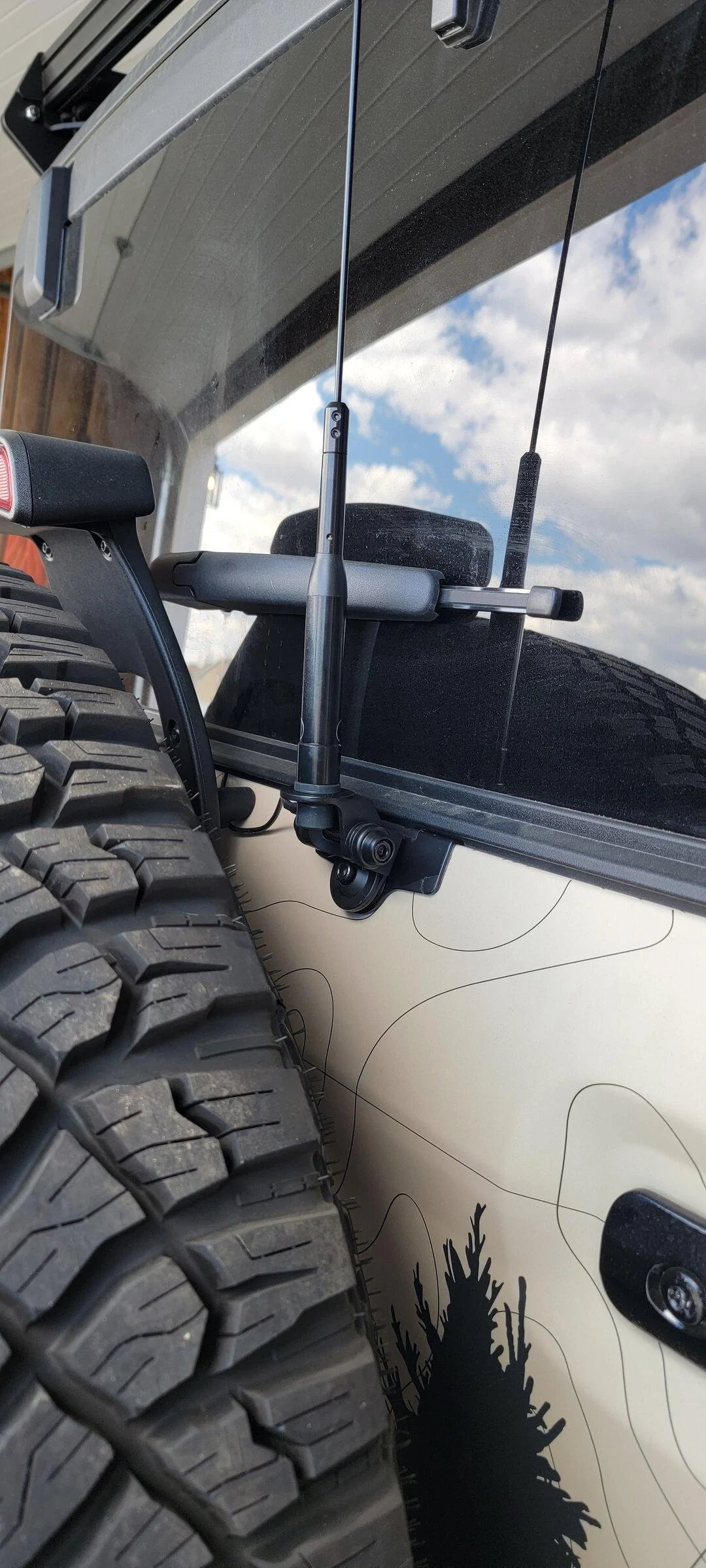

Nice install. What antennae mount did you get there?
Its a Comet lip mount. Had to trim off the tab on it so that it didn't interfere with the glass. This mount also has thinner coax for the first 12in so you can get through the weather seals easier.
