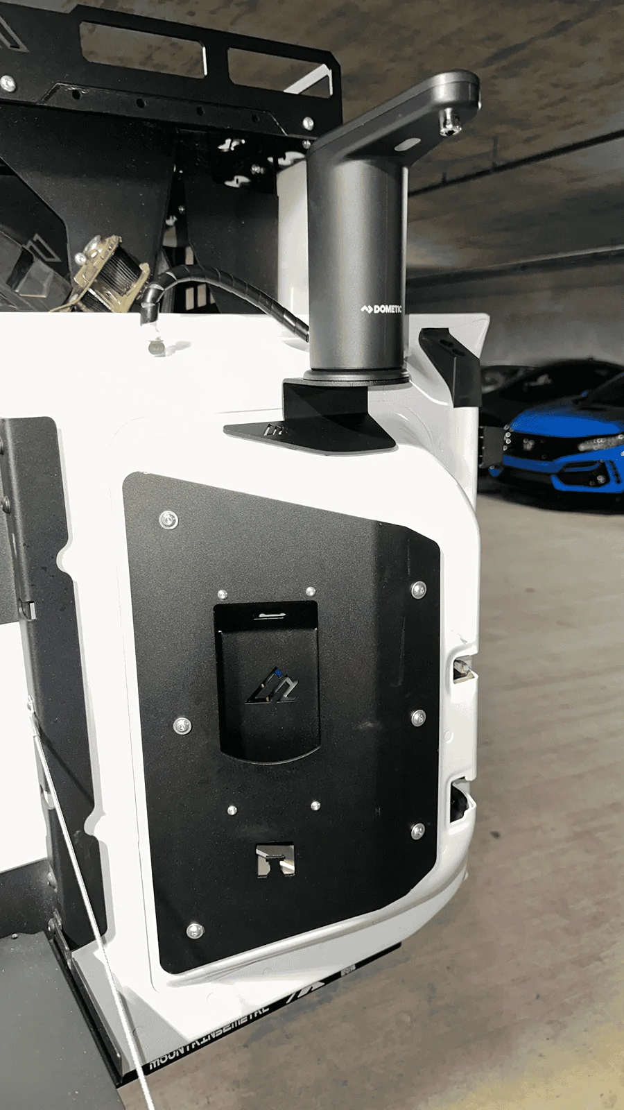

After seeing the Dometic Go Faucet in action on a previous camping trip I decided to install this on my rig. The only thing I don't like about their kit is the exposed tubing, so I decided to purchase some components from McMaster (see list at end) to keep the tubing hidden behind the tailgate.
The mount itself adheres to the tailgate with double sided tape. Not a huge fan of this, but it seems to hold well. I used a little extra on the back to make sure it is secured.

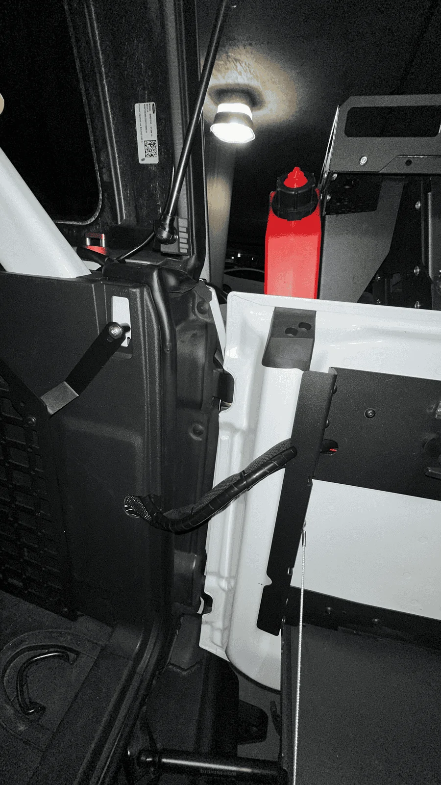

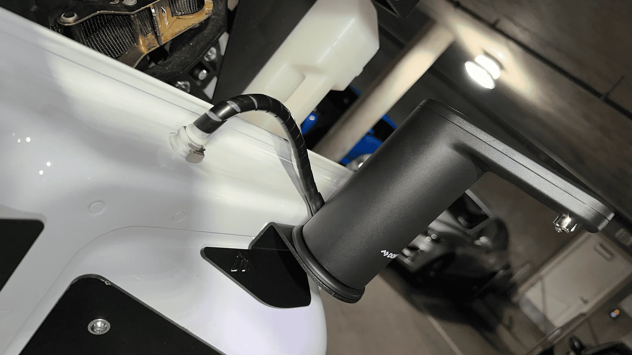

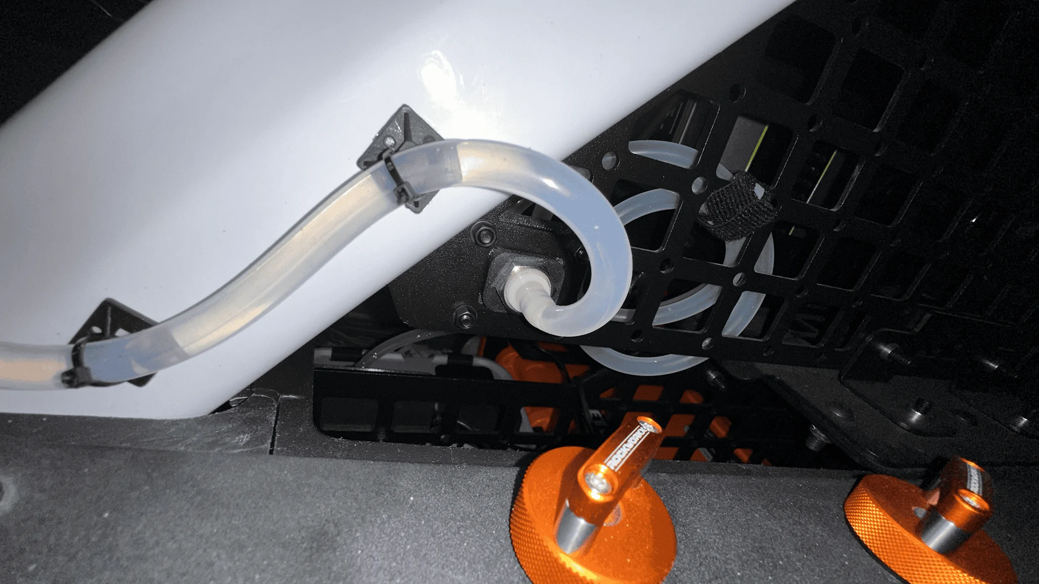

I drilled a hole through the top of the tailgate to connect a quick-disconnect fitting. I also trimmed the small trim piece that connects behind the A-pillar to the side panel to allow the tubing to pass through without pinching.

Spiral sleeving was used in areas where there could be compression or rubbing on the tubing.

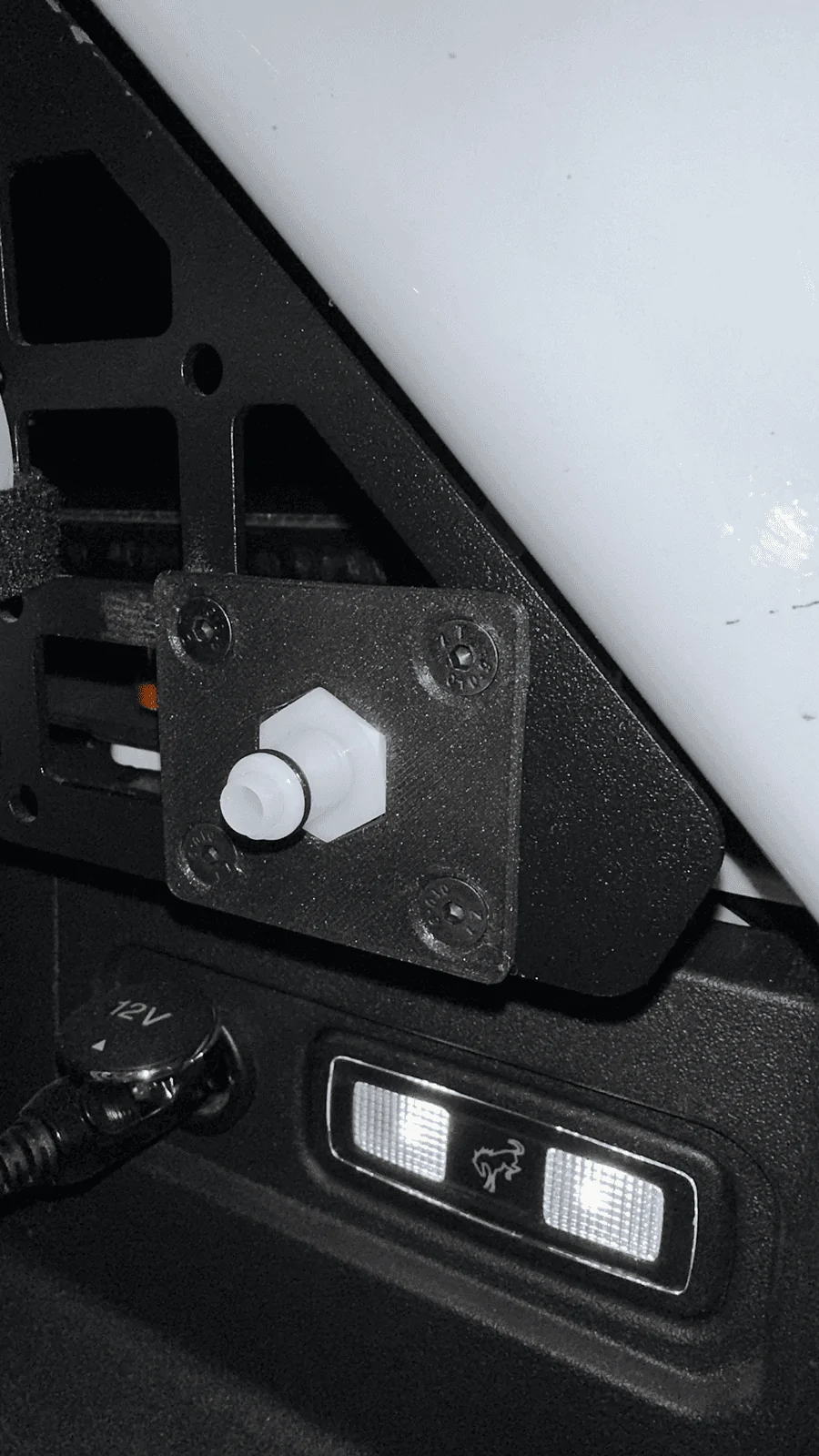

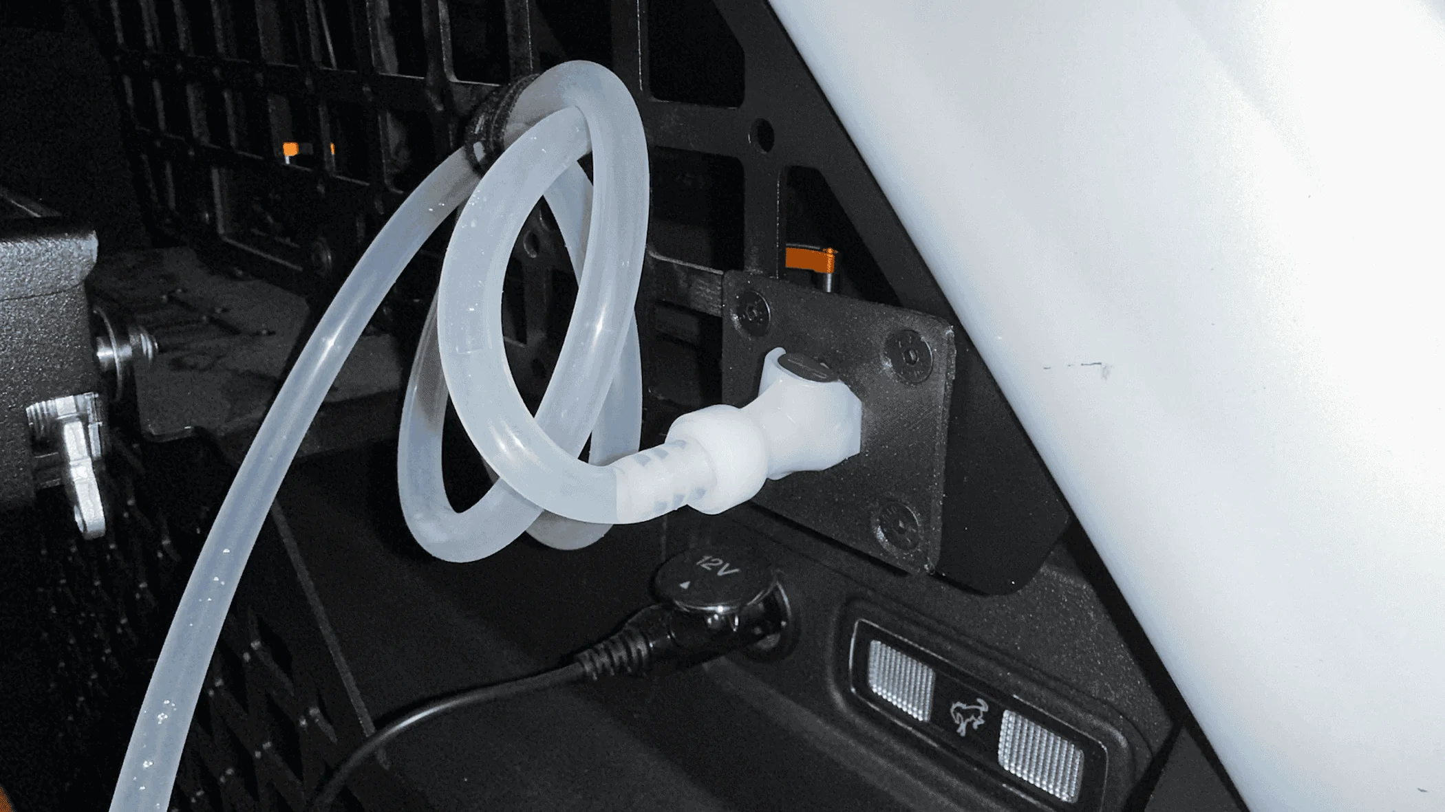

I also 3D-printed a MOLLE panel mount to attach the other end of the quick-disconnect fitting. If you're interested in it send me a message and I'll share it with you (fits M2M MOLLE panels).
