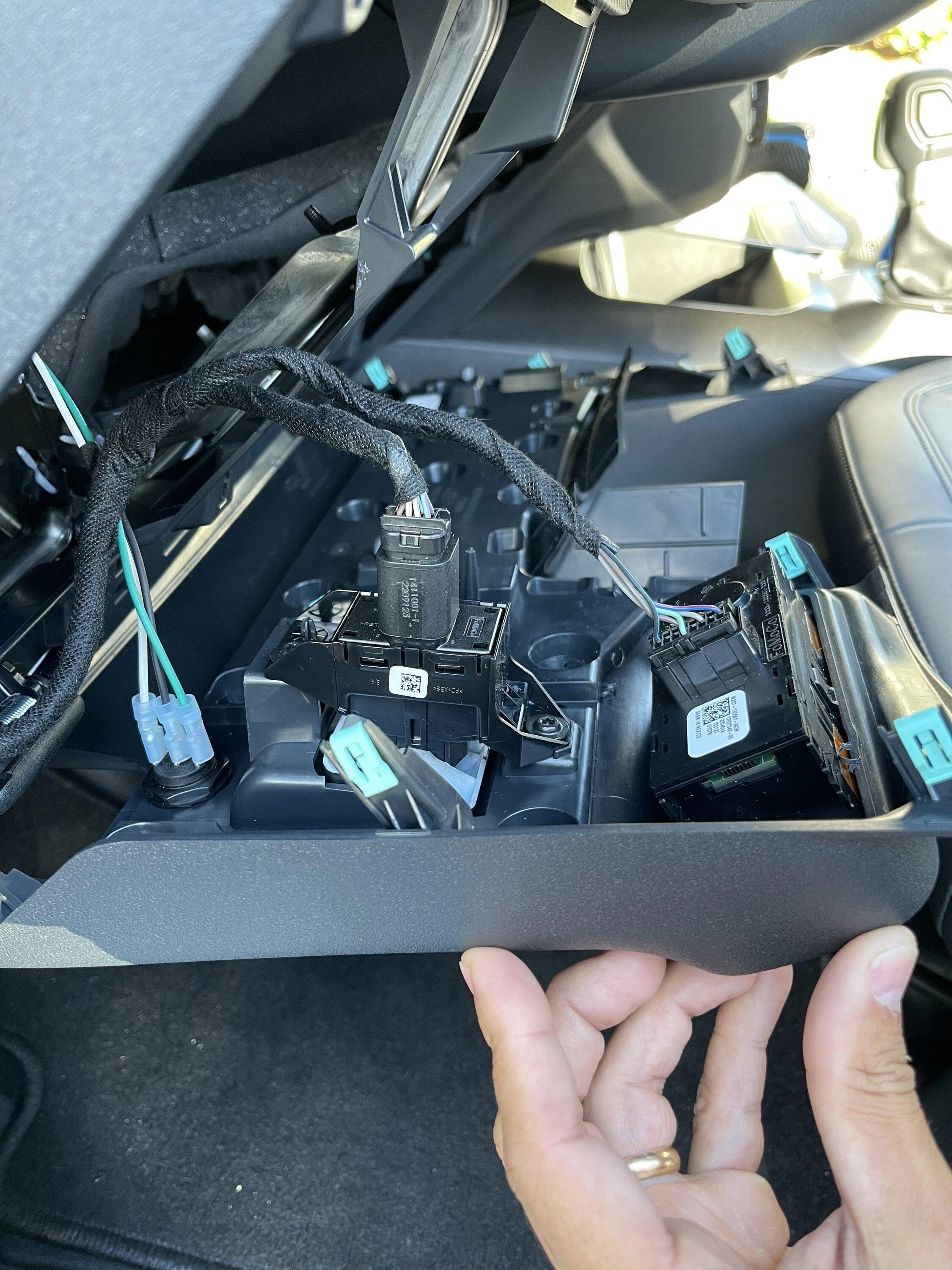

I started reviewing the instructions of both kits and all parts are exactly the same (even comes with the same "STA" controller version). I thought perhaps there was a software difference in the controller but after looking into it, there's only three different controllers they use across all makes/models. I even reviewed a bunch of older YouTube videos for the older Ranger kit to confirm all the wiring colors/pin-outs matched the controller I saw in the videos for the Bronco install (everything matched up).
I contacted AMP and asked what the difference was between the kits. I got a vague reply that the older kit was "developed for the Ranger" while the new kit is "for both the Ranger and Bronco". Smelling some bullcrap, I pressed harder and asked, if there was an actual change in the parts or if it was a software difference in the controller? They replied and said neither, and that the change was "electrical". I couldn't see how there would be a different "electrical" component change, given there was no notable difference in components list via the instructions, videos, etc. so I presumed this may just have to do with wire lengths or some other insignificant difference.

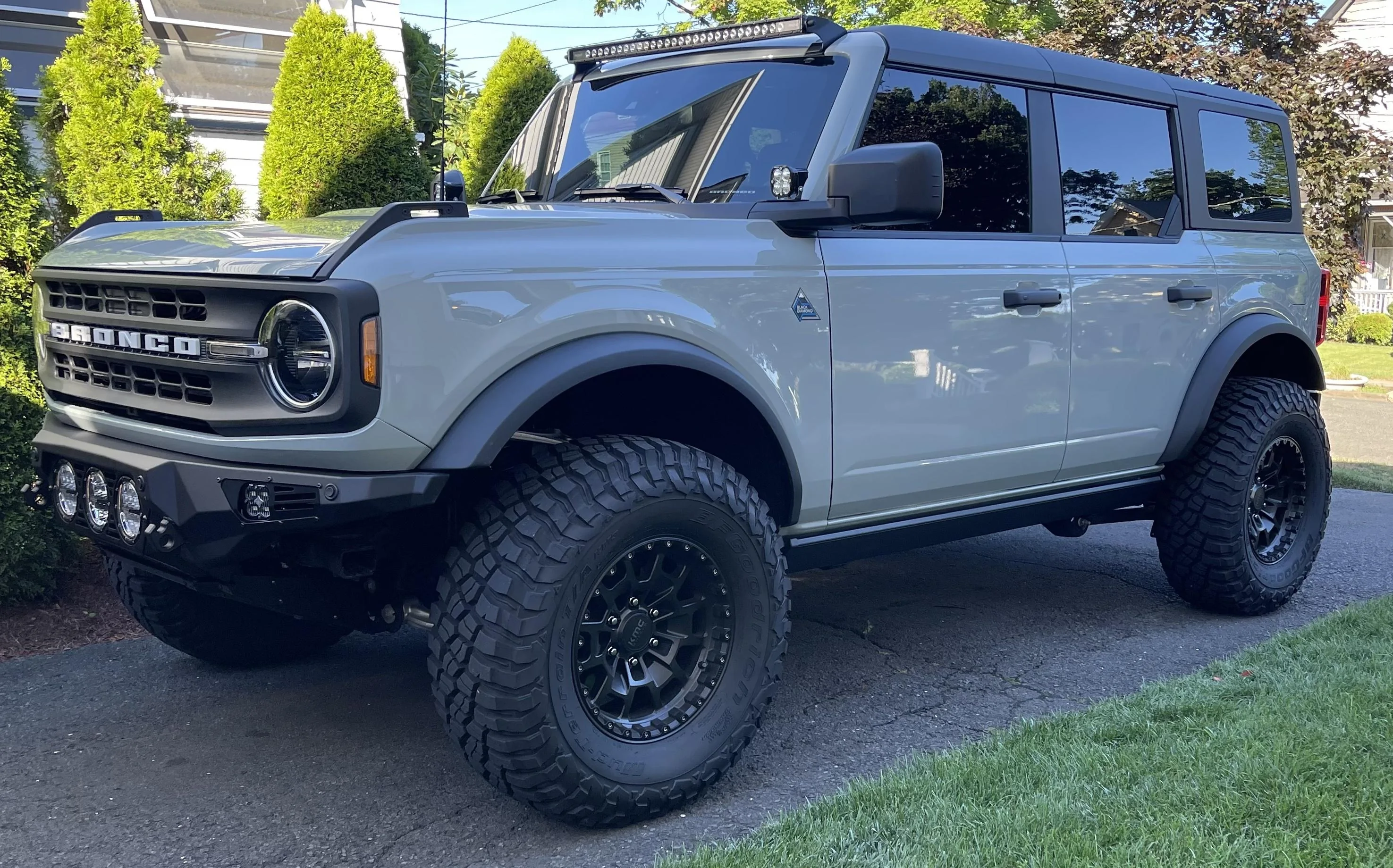

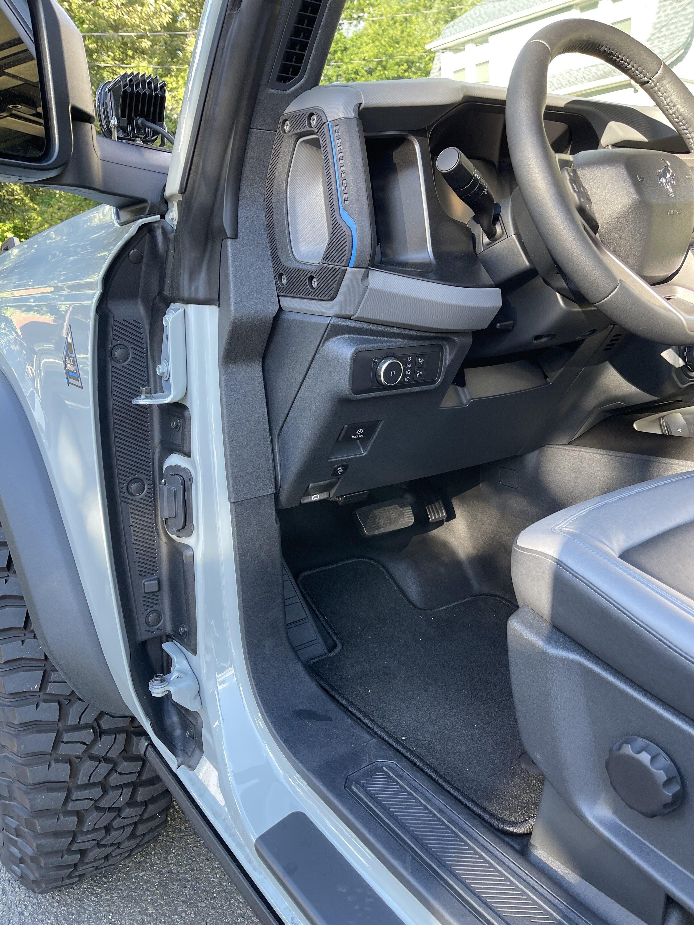

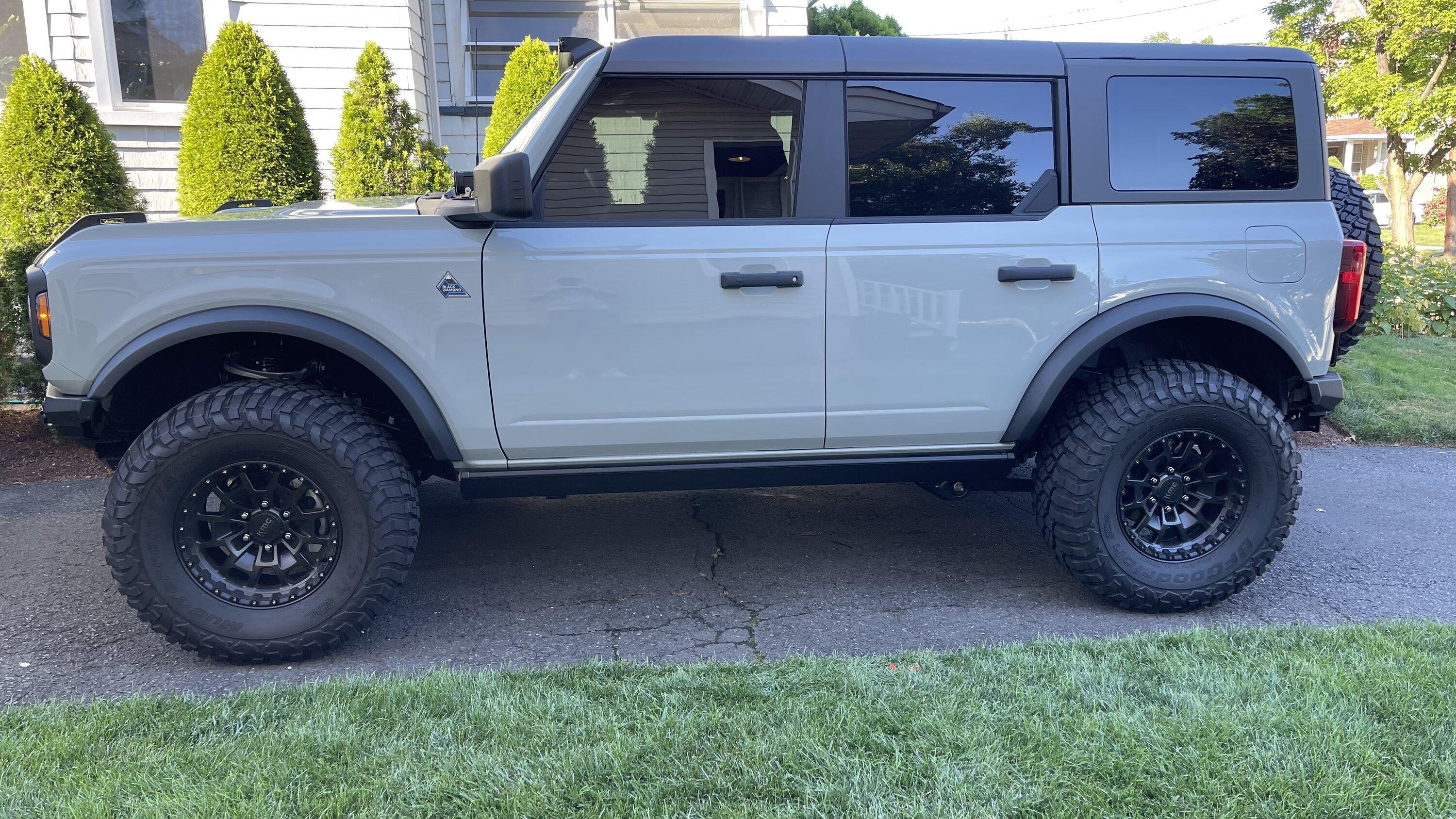

Undeterred and willing to take a gamble, I went to AutoAnything as they apparently had stock of the older kit (76136-01A). I chatted an online rep who confirmed they had around 25 units available. Even gave me 10% off + free shipping. The running boards showed up yesterday and I installed them today. I followed the instructions for the 76140-01A kit (available online) and when the moment of truth finally arrived, I thought "there's no way this is going to work and fire up". I put the fuse in at the final step of the install and sure enough, everything worked FLAWLESSLY!!!
I can't believe I got these ordered/installed in under 5 days when I had hopelessly been thinking for weeks that I couldn't get these till December.
Best I can tell, the only difference is the instructions included in the box. So if you find anywhere that has stock of the old 76136-01A... pull the trigger! You're welcome.
