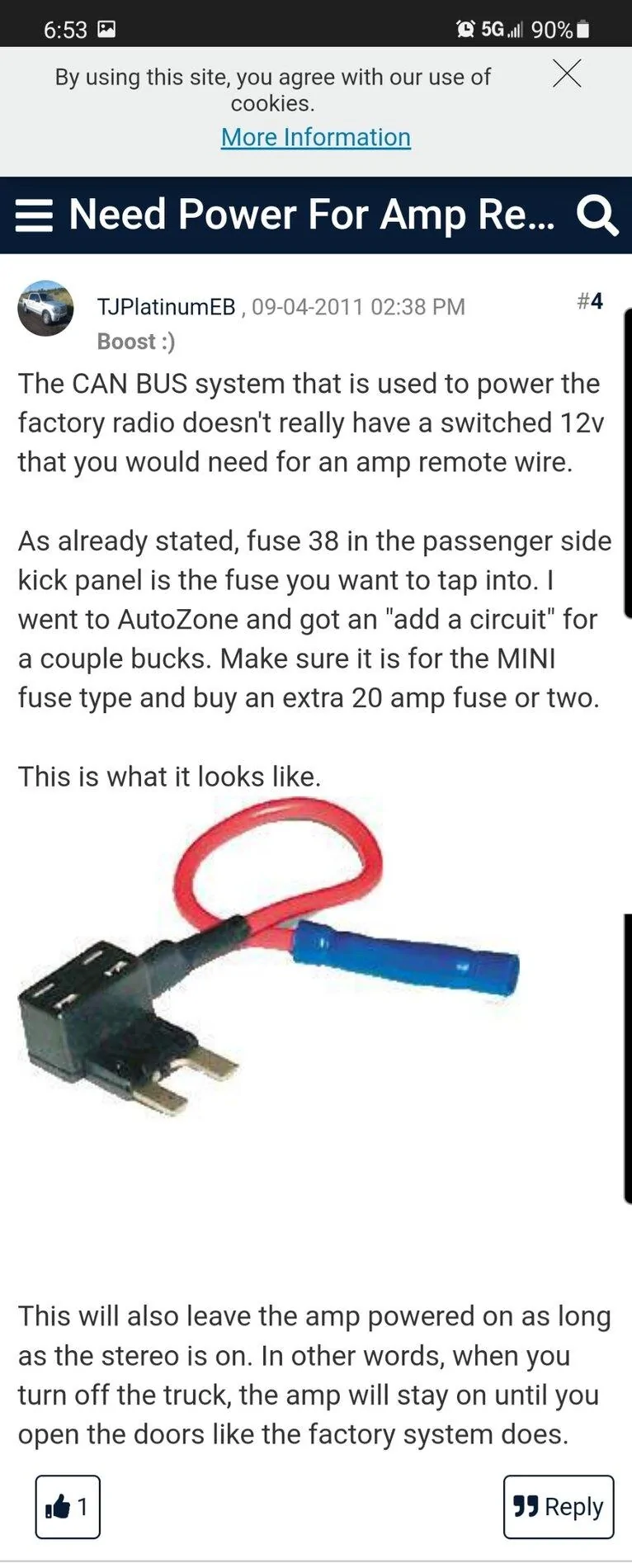

Curious, anyone find something like this for the bronco yet? There has to be a fuse with the same function in the bronco.
(From f150 forum)

You find an answer anywhere?

A quick test light and you could find out. See which fuses still have power while the radio is playing but the ignition is off, and then which of those lose power when the radio turns off.
