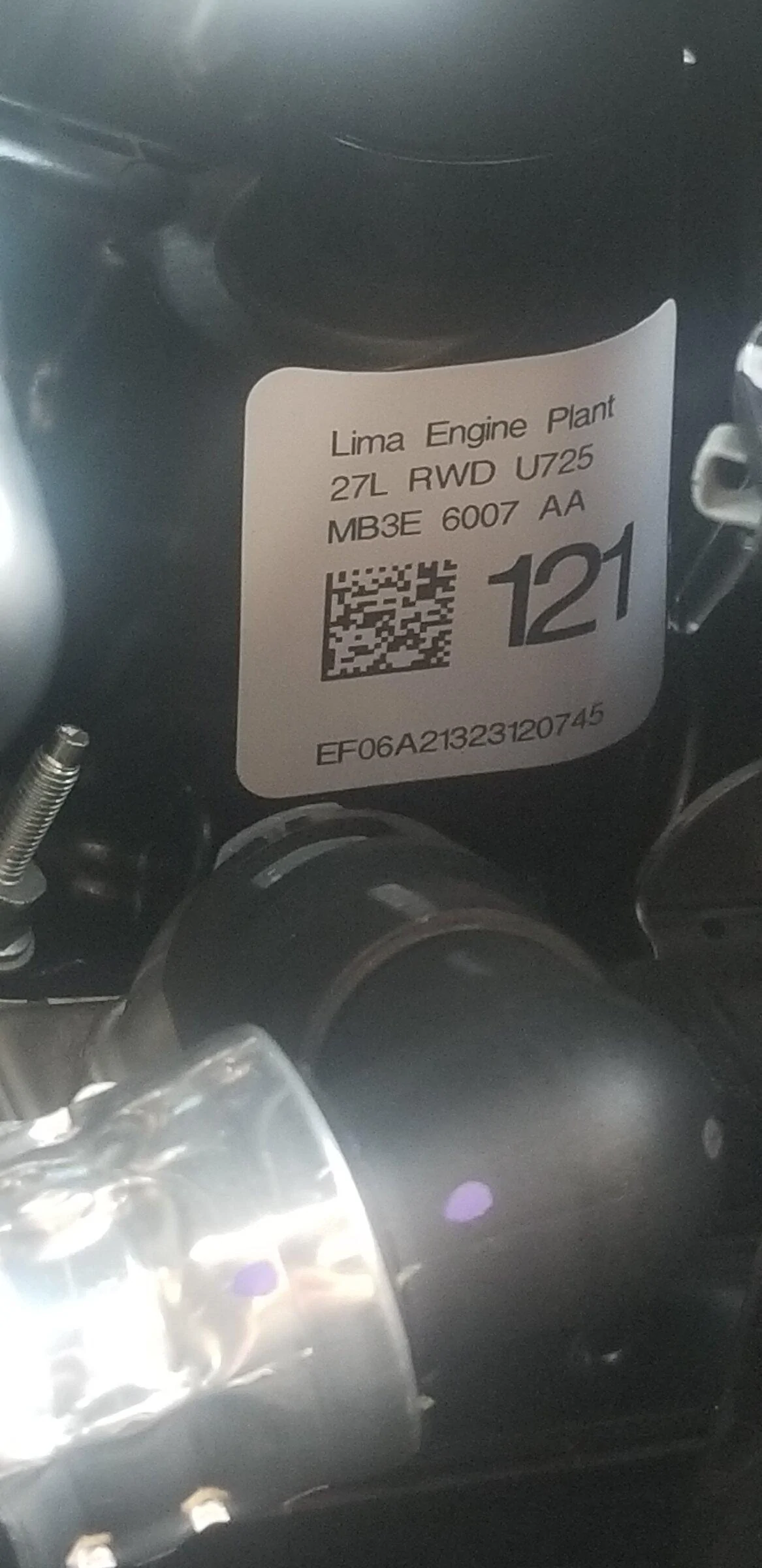

How do you read these? Can someone tell my dumb ass when my motor was built? Does this fall in the time frame when these so called bogus motors were built? Thanks
Ford Bronco Another blown 2.7 UPDATE 20220113_135050
Engine was built on Nov 19, 2021 (y)
