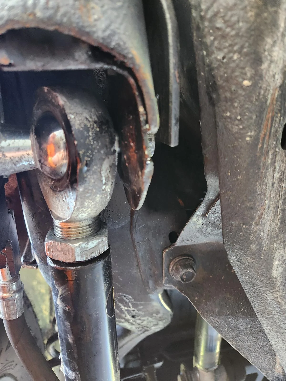

Any recommendations on how to straightened this out? Drivers is perfectly stright and I'm getting clunk which I'm 100% sure is this. Loosened the jam not and the bolt going through the mount and it won't budge.

Not too sure, but both of mine are not straight. I haven’t had any issues and I beat on mine. Did you lower the gas tank to install? Maybe that’s loose? Are both links the same length? Do you have a lift and stock track bar? Is your coil over bucket mount rusting or cracked (I saw a friend’s bronco with a broken mount and it clunked bad)?
I’d start by checking for broken mounts, measuring the links and retorquing everything.

Are you talking about the heim joint? If so, loosen jam nut, use a large Cresent wrench on the outer part of the joint and twist it straight. IT does need to be straight up and down.

If you can't move it you may have to pull the entire link and get it in a vice.
