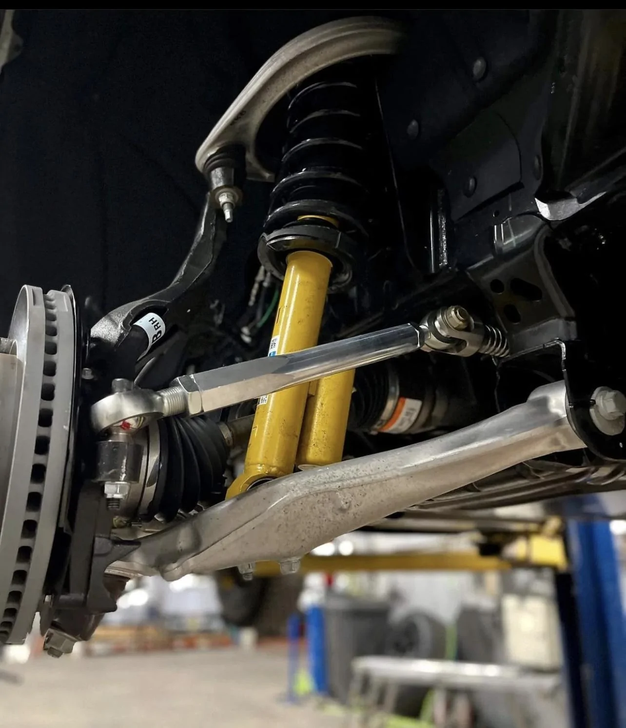

Need to see a pic w/boots installed
I doubt the boots will fit since the aluminum rod is much larger diameter than factory steel rod. It also seems like you would have to remove the boot to do the toe alignment?

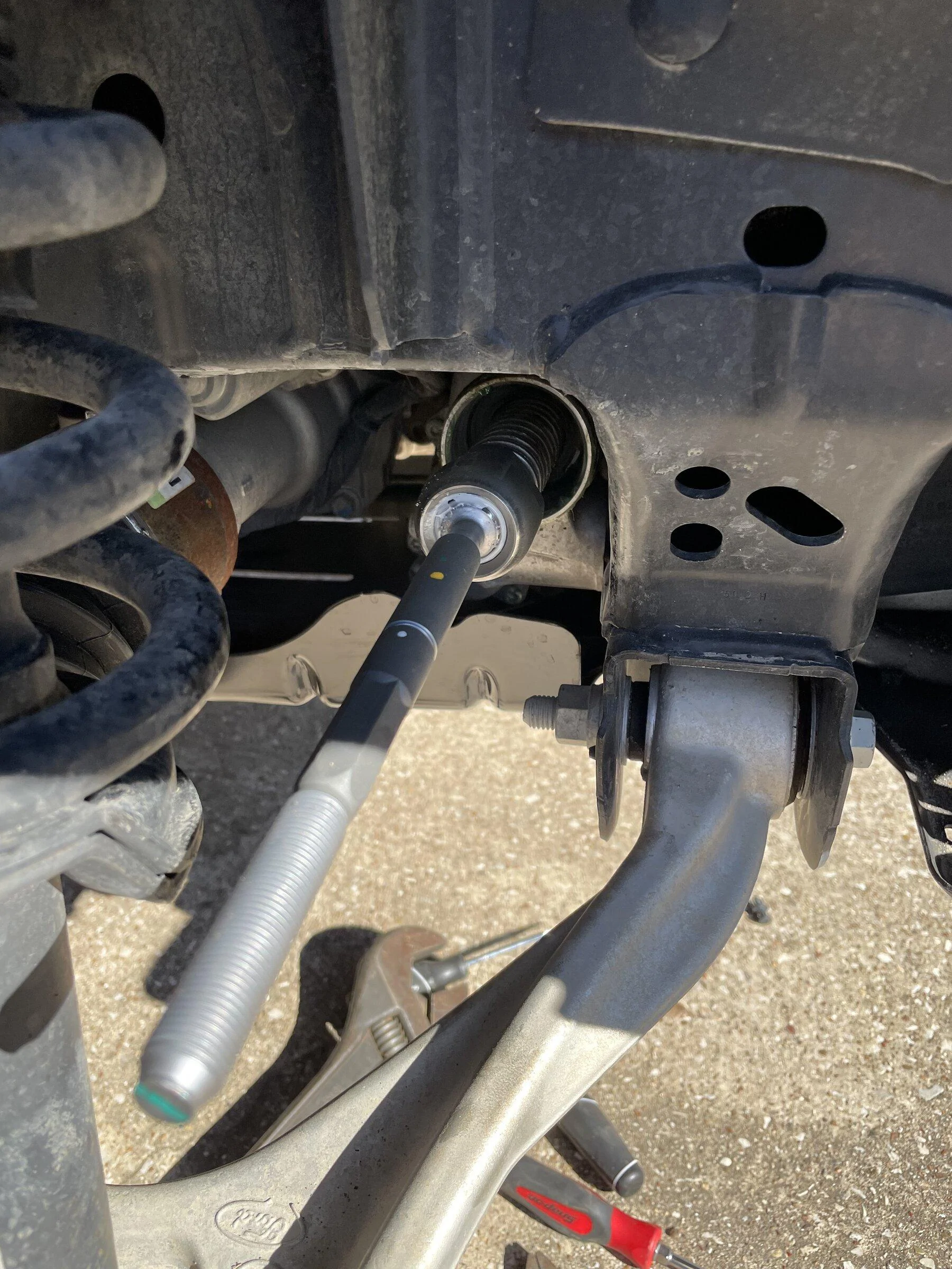

The guy that was breaking tie rods and steering racks also quickly bent the RPG joint (40" tires).

I am not a huge fan of this $398 alternative, but at least you wouldn't have to deal with the boot issues.

That's what I meant when I said that...run a bootless electric rack through mud? seems unwise to me, but what do I know? They show boots on their website. And ya the top pic, that guy has got some work to do to make the "angle of the dangle=the heat of the meat"

Also having that rod end in single shear isn't optimal (as proven by that failed RPG) but not a lot you can do there without welding a tab to the knuckle.
