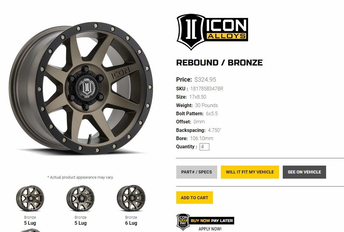

I have just got my production date for my Bronco, and have started shopping parts, because, of course. Im looking at wheels at the moment, and really like the ICON Rebound or rebound pro. But the sizing says for my fit, (2022 Badlands sasquatch) that the only sizes they have 17 X 8.5 +25ET which I assume is the offset. From what I've gathered, a 0 (zero) offset is the correct offset when buying wheels for this package. Yet I have also seen some rigs on here with the ICON wheels. Some even saying they have them in a 0 offset even though Icon does not list those as being compatible. Whats the REAL scoop here?

The offset you need will be dictated by the tires and the width of the rims. But your stock sas wheels will be +30 offset and 17x8.5. If the wheels you are looking at are really +25, then the wheels will be similar to stock.
The fitment guides might be crap for a few reasons. If the bore is bigger than your hub, they might list them as not fitting. But that would still work either with hubcentric rings or careful mounting.
Just remember this. 0 offset means the center of the wheel is on the same plane as the hub. Positive means they are tucked inside the wheel well more. Negative means they are sticking out.
If you don't want a lot of poke, your stock is +30. +20 to 0 will keep moving them out some. But once you get into the negative offsets, you are moving them way out, compared to stock. Some people like a lot of poke.
Hope i cleaned that up right.

I don't mind if they stick out a little more than the stock ones, but only a little. and inch or so. Whats with the different hub sizes mentioned? (93.1 or 95.1)? Those are also in the size options...
Ford Bronco Another wheel offset question... Screenshot (4454)
Two different answers seem relevant:
I believe that the +25 is the wheel offset that actually comes with a Sas equipped Bronco, and a standard Sas suspension; and
The "0" offset is what most upgraders choose to use, if they also plan to include other suspension upgrades.
A "0" offset puts a 12.5" wide tire, right near the edge of a Sas fender flare... and it allows for 2.5" and 3" coilovers.

The offset you need will be dictated by the tires and the width of the rims. But your stock sas wheels will be -30 offset and 17x8.5. If the wheels you are looking at are really +25, then the wheels will stick out 2.165" more than the stock wheels. That's a lot.
Just remember this. 0 offset means the center of the wheel is on the same plane as the hub. Negative means they are tucked inside the wheel well more. Positive means they are sticking out.
If you don't want a lot of poke, your stock is -30. -20 to 0 will keep moving them out some. But once you get into the positive offsets, you are moving them way out, compared to stock. Some people like a lot of poke.
This is all wrong. You switched Positive and Negative offset.
This is backwards. Negative moves out. Positive moves in
I believe stock Base, Big Bend and Black Diamond are +55mm offset. Stock Badlands, Wildtrak and Sasquatches are all +30mm offset (not -30mm)

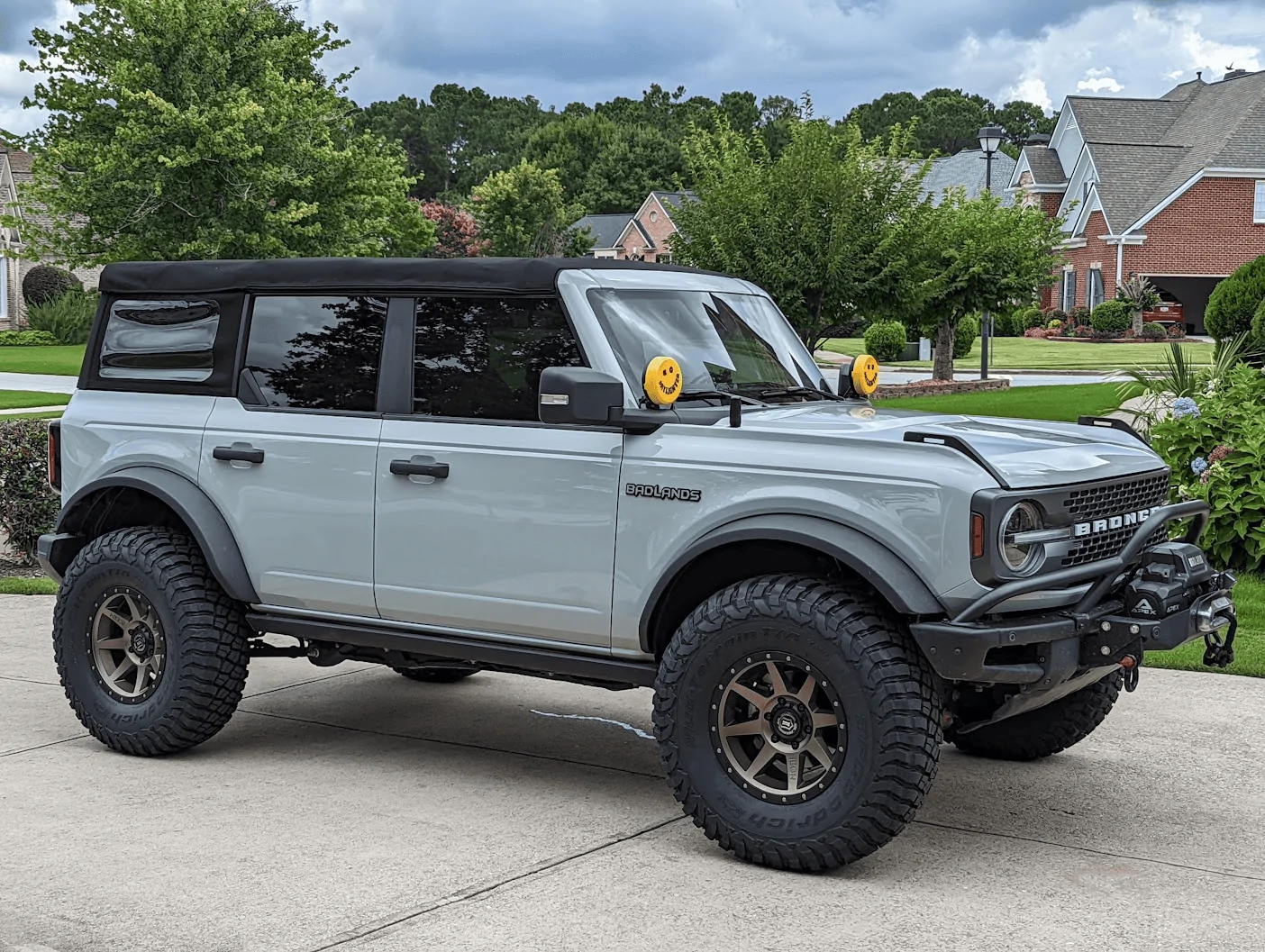

As long as the wheels hub bore is larger than the Bronco's you will be fine. I haven't had my wheels off yet but I had the same thing on my Miata with a larger hub bore on the wheel than the car. You can either get hubcenteric rings or just tighten the lug nuts properly and it will center itself.
These are the wheels I have.
Ford Bronco Another wheel offset question... 1660419869842
Ford Bronco Another wheel offset question... 1660420056032
Those are the ones I was looking to get. Either those or the Pros. Cant argue with Street legal beadlocks! I don't think the Huchinsons are available for the Bronco.
