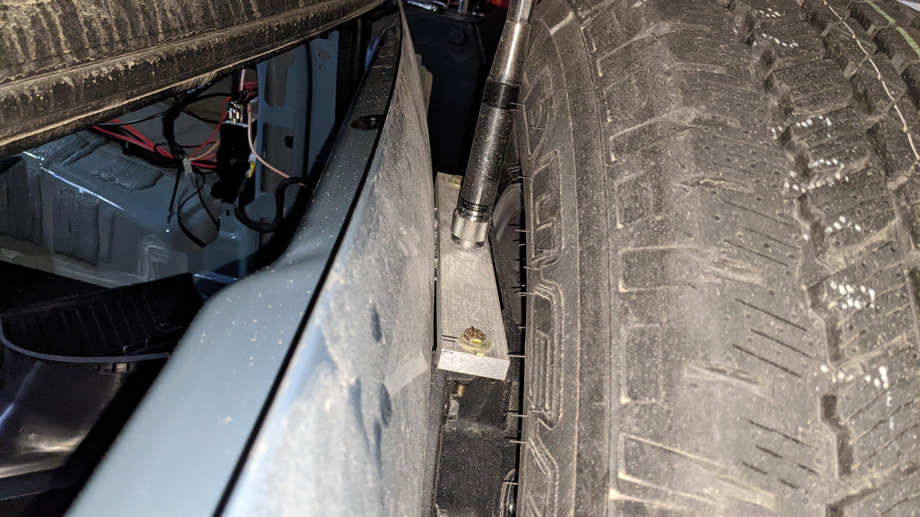

There are some threads on here that show some antenna mounts for Jeep spare tire carriers will work, sometimes just by making the mounting bolt holes a little larger.
I fabricated my own out of some steel that came out decent (first time I've ever worked w/steel - an angle grinder, a cut-off wheel, and then a couple flappy sanding discs was all I needed - under $30 from HarborF). I made a paper template to match the upper to bolt holes on the carrier, cut the steel to match the template and then cut it to an appropriate width, and then made a 90 degree bend above the spare tire where the antennas sit. I was going to make a copy of the template and upload it here - I think others have already done so as well. If I can find the template I'll upload it along w/some pics of the mount.

Thanks man! I do have one from my JK still in a closet, it utilized the tire carrier bolts. Ima look at it when I get home see if I can make it work somehow. I just assumed it wouldn’t.

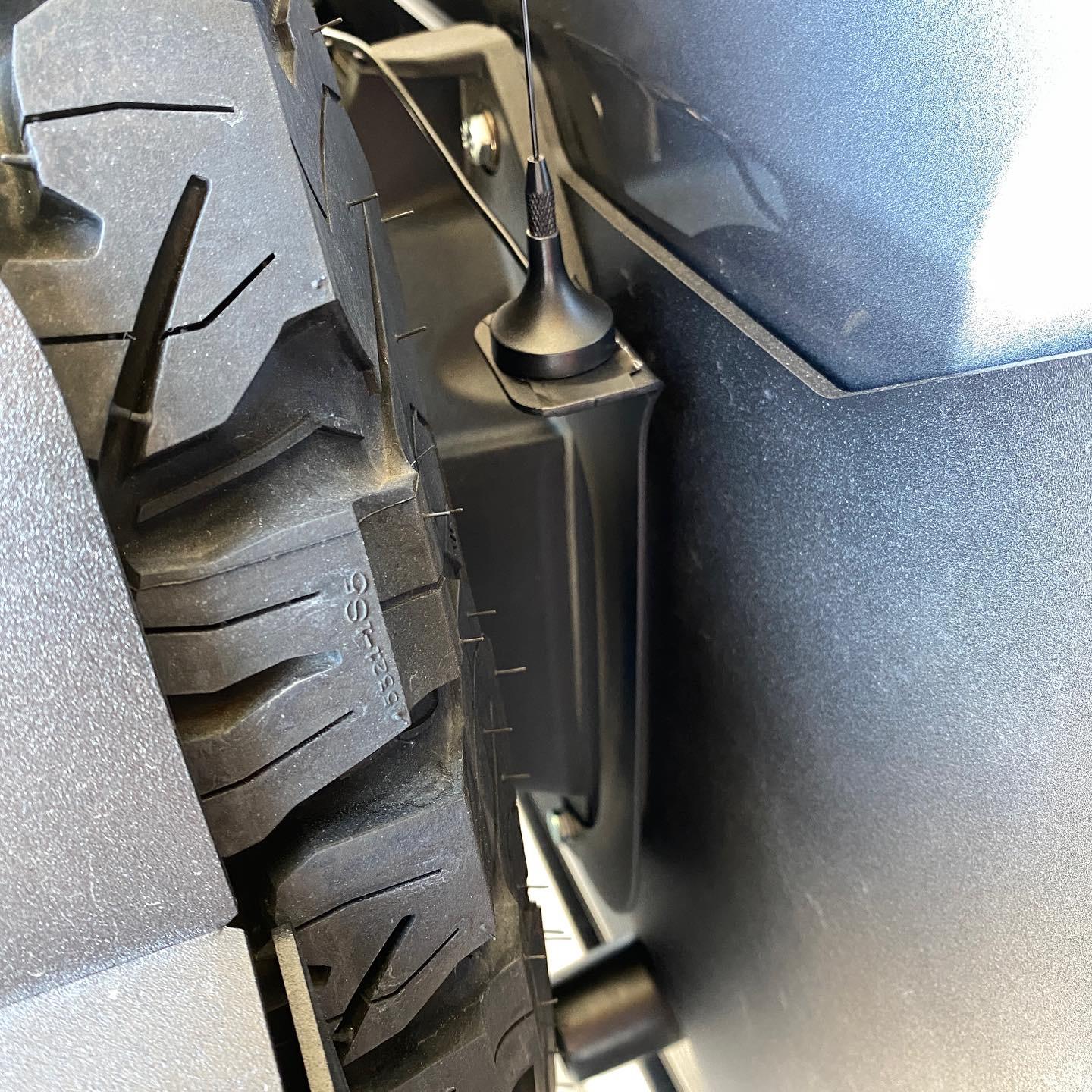

My old 40M mount:
Ford Bronco Antenna mounts - UHF/VHF, CB etc PXL_20220413_033828856

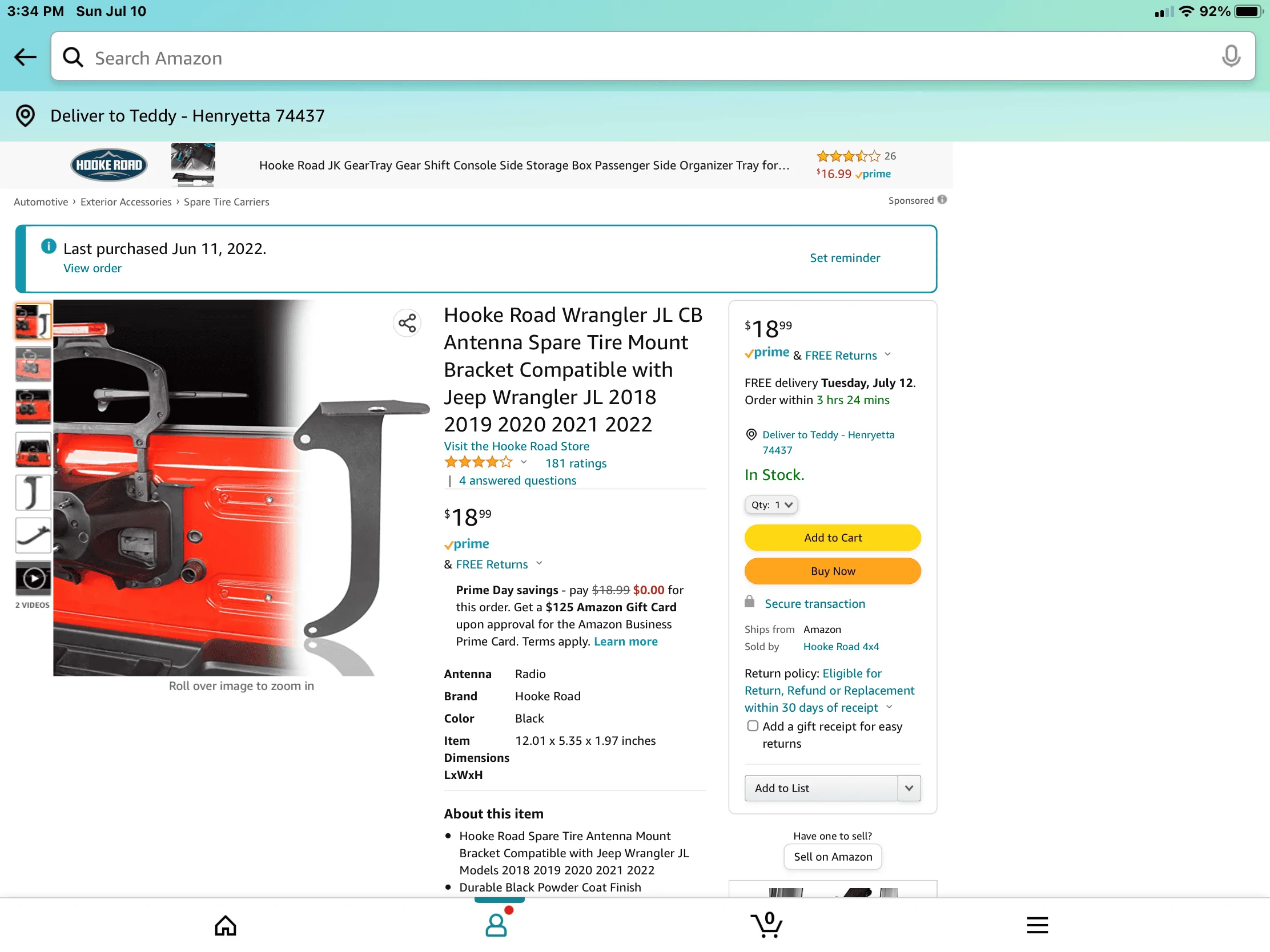

I got this one, I haven’t installed it yet
Ford Bronco Antenna mounts - UHF/VHF, CB etc A3BEA560-7D32-4F99-A11E-21AE7A9405CC
If you don’t mind respond back when you can and let me know if it fits!

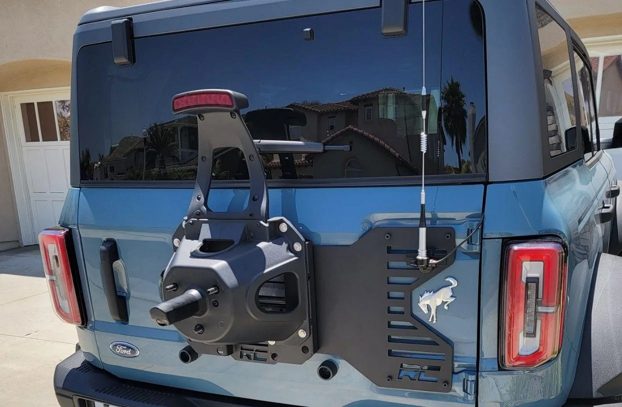

I mounted this antenna on a Rough Country tailgate reinforcement plate, working just fine so far.
I didn’t get the reinforcement plate now I feel like I’m regretting it lol. Is that a mobile mag mount or the one that fits over windows that you put in the slot?
