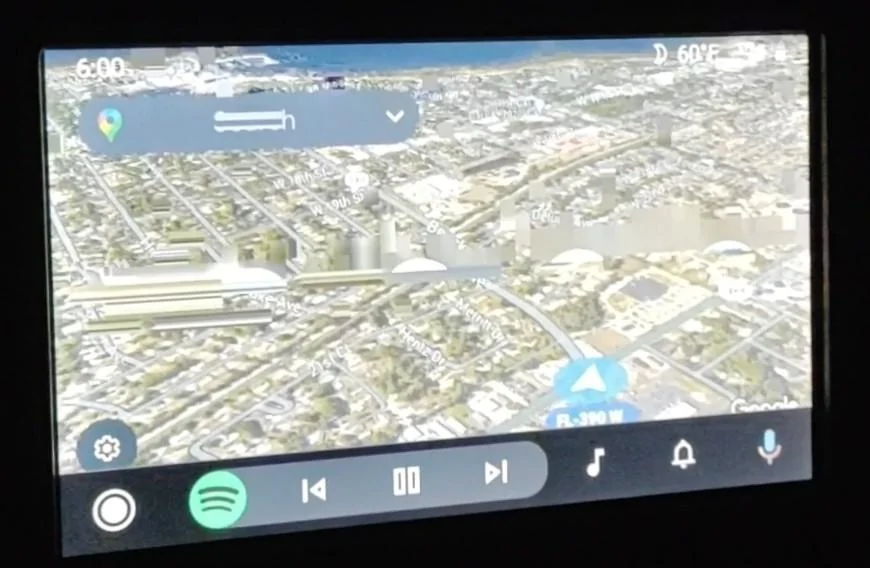

Yeap... a few times. I have to turn off the engine, open the door, restart, and that usually helps. I can't control anything on the unit when that happens, radio, nothing...

You can try to press and hold the power button plus track forward button. This should force it to restart. I read that here in another thread, and it is much easier than shutting the engine off and opening the door.

Debbie downer from IT says...in laptops that is a indicator that the graphics card is about to shit itself or the ribbon cable from the mobo to the display got messed up. It starts off random, comes and goes, gets worse, then dies one day.
