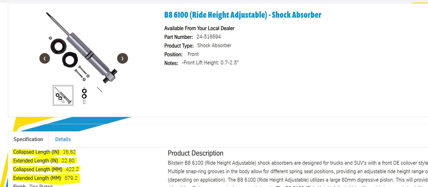

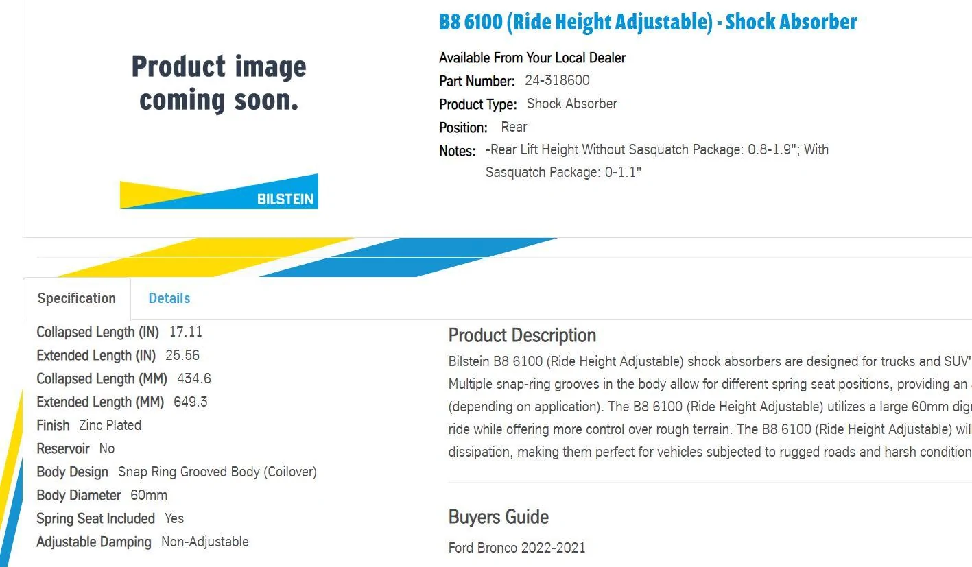

Say less. Obviously, it is hard to get an accurate measurement but I am confident these are pretty close.
ESCV FRONT:
Collapsed Length (IN) ~ 16.6"
Extended Length (IN) ~ 22.4"
ESCV Rear:
Collapsed Length (IN) ~ 17.1"
Extended Length (IN) ~ 25.3"
I don't know the exact motion ratios, but I would presume you gain less than half an inch of wheel travel in the front and probably around 0.35" more travel in the rear. If you were looking for something to carry you over with more travel, I would consider the Icon 2.5 EXPs. I do not have exact wheel travel numbers, but there was about 10.5-10.75" of the distance between my 37" tire and the fender at full droop in the front and about 12-12.5" in the rear, and they definitely hit the fender at full bump, so I am 10000% certain they cycle more travel. If you want a bit more lift, I think you can also get away with using the Eibach Pro Lift springs for Sasquatch-equipped model
