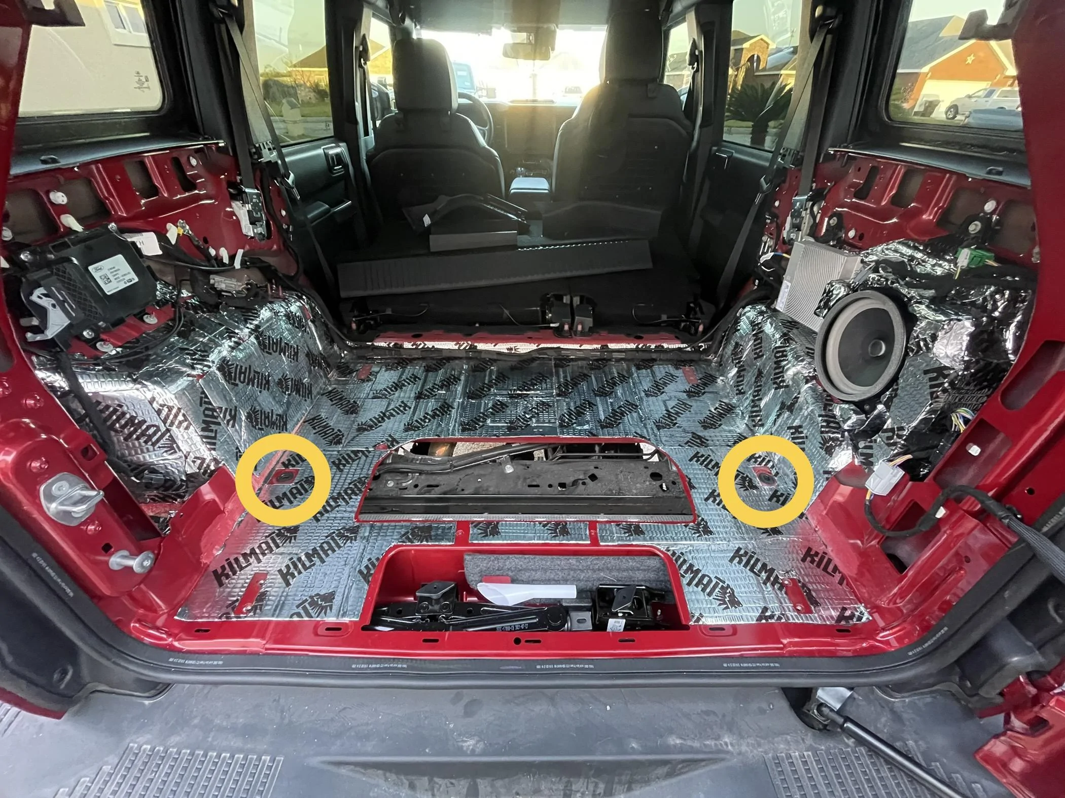

I covered nearly everything in the back (and my doors) with custom cut 80 mil kilmat, including every inch of the sub enclosure. It seemed to make a difference — I have essentially no music-caused rattles from my Kicker subwoofer (that’s in the B&O enclosure).
I also wrapped every clip in cloth tape and added rubber washers to where the sub enclosure was screwed into the body.
There are a few stereo related threads in the Electronics forum with pictures from others.
Side benefit: with reduced road noise, the wind noise in my soft top is much clearer!

There are several causes of sub rattle. But the absolute best place to start is rubber washers between sub enclosure and body, and the bolts/nuts to enclosure. Then insulate the enclosure to body panel. Best way to do that is wrap in dynomat/Kilmat as stated. Then chase from there. This precut kit will do nothing for sub rattles.
I used a $30 box of Kilmat to do what this dynomat kit will do, and much much more. It’s overpriced.

Yes, I’ve wondered if there’s anything to Dynamat that makes it better/worth the expense.
What are the deals circled in yellow in your picture? I may have covered those.

Ah those are grommets out of the cabin. I circled them in that picture in the past to show someone how to run some wiring lol.
When I looked into Dynomat vs alternatives it seemed pretty well understood they are all the same material and thickness was only difference. I use 80mil Kilmat.
