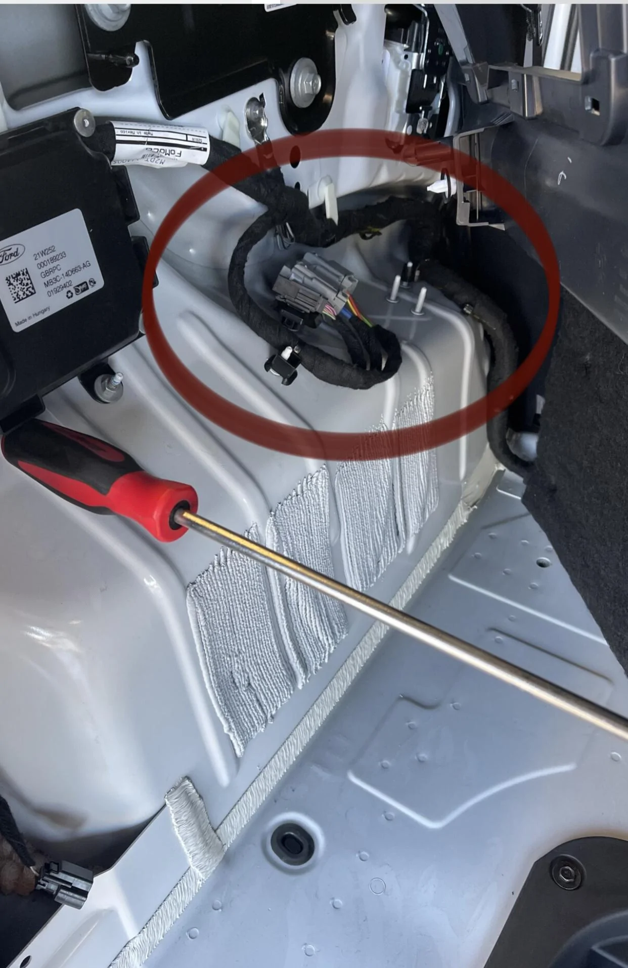

Anyone know what this 3 plug wire harness is?

Does Ford make a plug and play tow wiring harness for this module?

Curt and Tekonsha make plug-and-play harnesses. There are different ones based on LED or no LED taillights.

Yes those plug into L and R taillights.
I’m wondering if anyone including Ford makes a kit to plug directly into the factory tow module plugs in the photo.

No. You could put the Ford module there but it would require additional wiring and Forscan changes to make it work. It’s been done but not a plug and play.

So this module is not part of the trailer package from the factory?
Thats what tow module would plug into if you had the factory tow package
