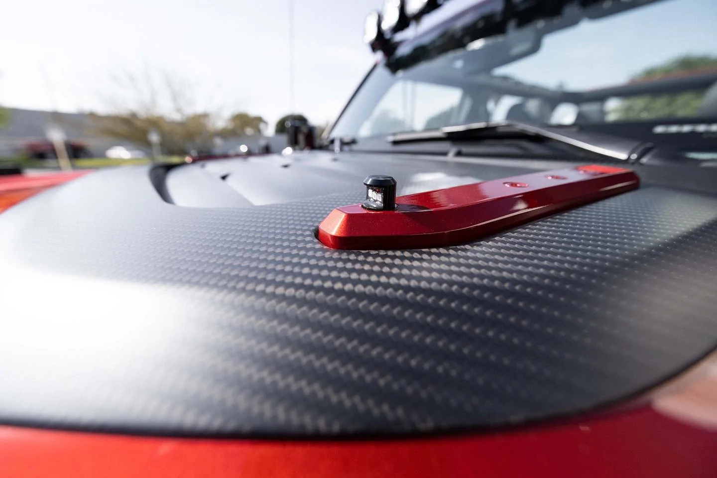

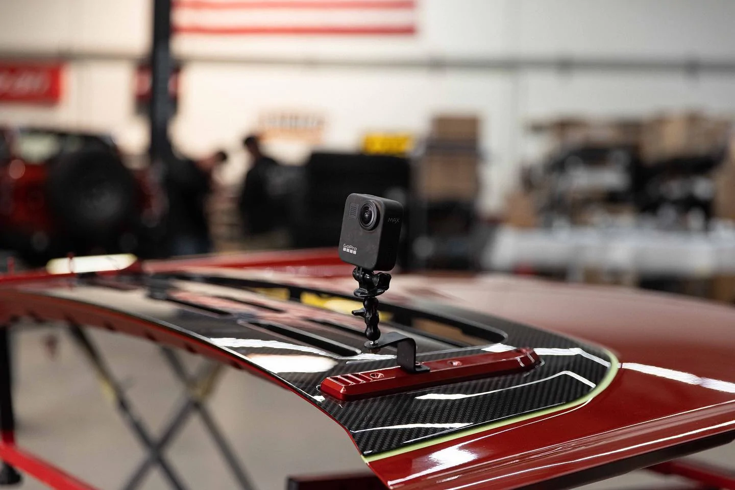

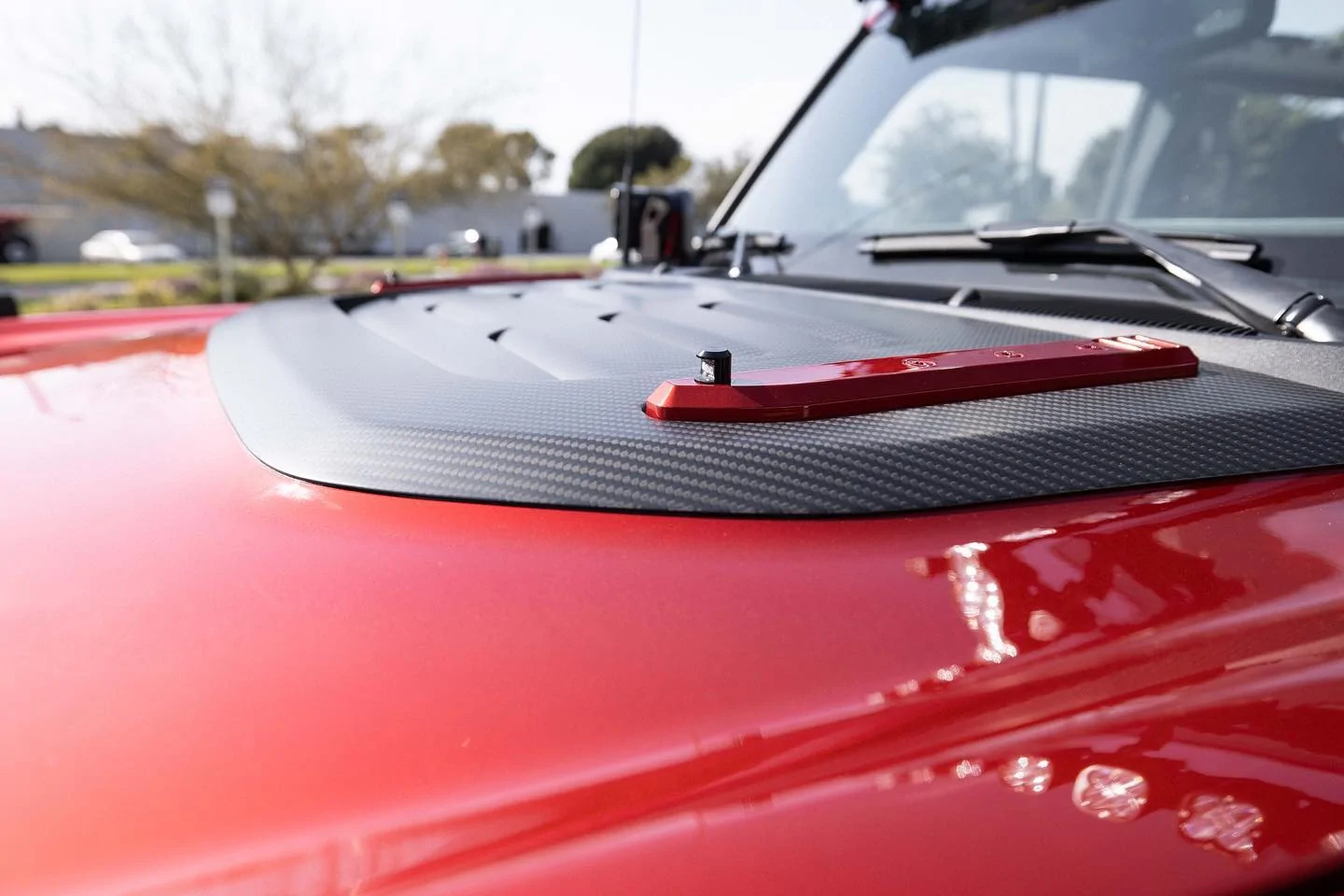

Saw this today on @APG Instagram feed and thought I would share:
Ford Bronco APG "Ram Air" Hood Trim w/ Heat Extractor in Carbon Fiber 350721071_786526782844457_2139626315597387274_n
Ford Bronco APG "Ram Air" Hood Trim w/ Heat Extractor in Carbon Fiber 351249052_1415605935872350_2856675728084760358_n
Ford Bronco APG "Ram Air" Hood Trim w/ Heat Extractor in Carbon Fiber 350472238_3164102037068259_7409524624389761447_n
Ford Bronco APG "Ram Air" Hood Trim w/ Heat Extractor in Carbon Fiber 350782858_1351960572084772_8212676209403693652_n
Ford Bronco APG "Ram Air" Hood Trim w/ Heat Extractor in Carbon Fiber 351064080_1024615598504155_1988180811913980611_n

That's...not ram air. Ram air uses a scoop to force air into the intake when the vehicle is moving. That hood has a heat extractor, specifically because it uses back-facing, recessed vents, which promote a low pressure area and help pull air through the engine bay to cool it down.

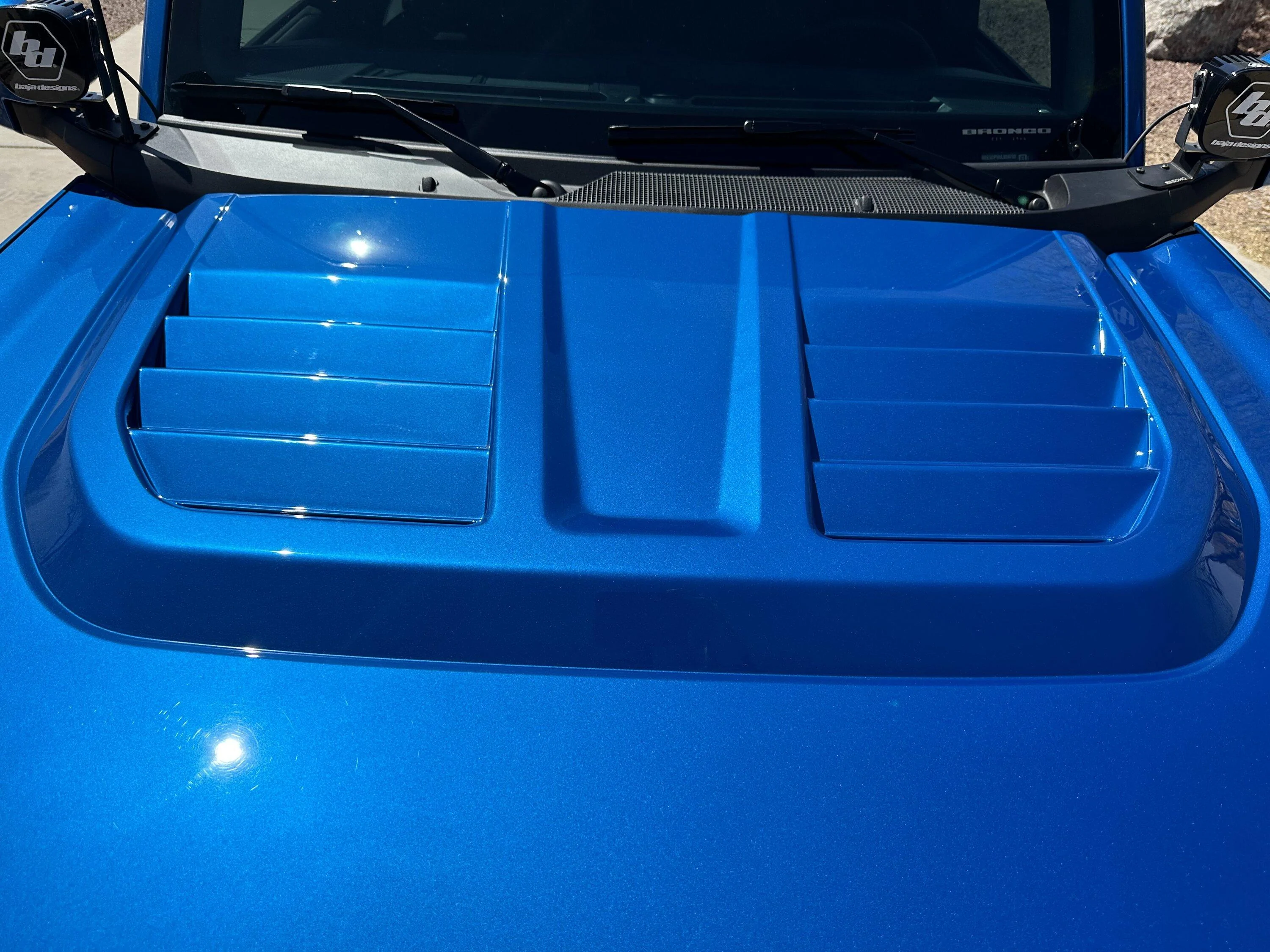

ADV hood scoop:
Ford Bronco APG "Ram Air" Hood Trim w/ Heat Extractor in Carbon Fiber 1685741306477

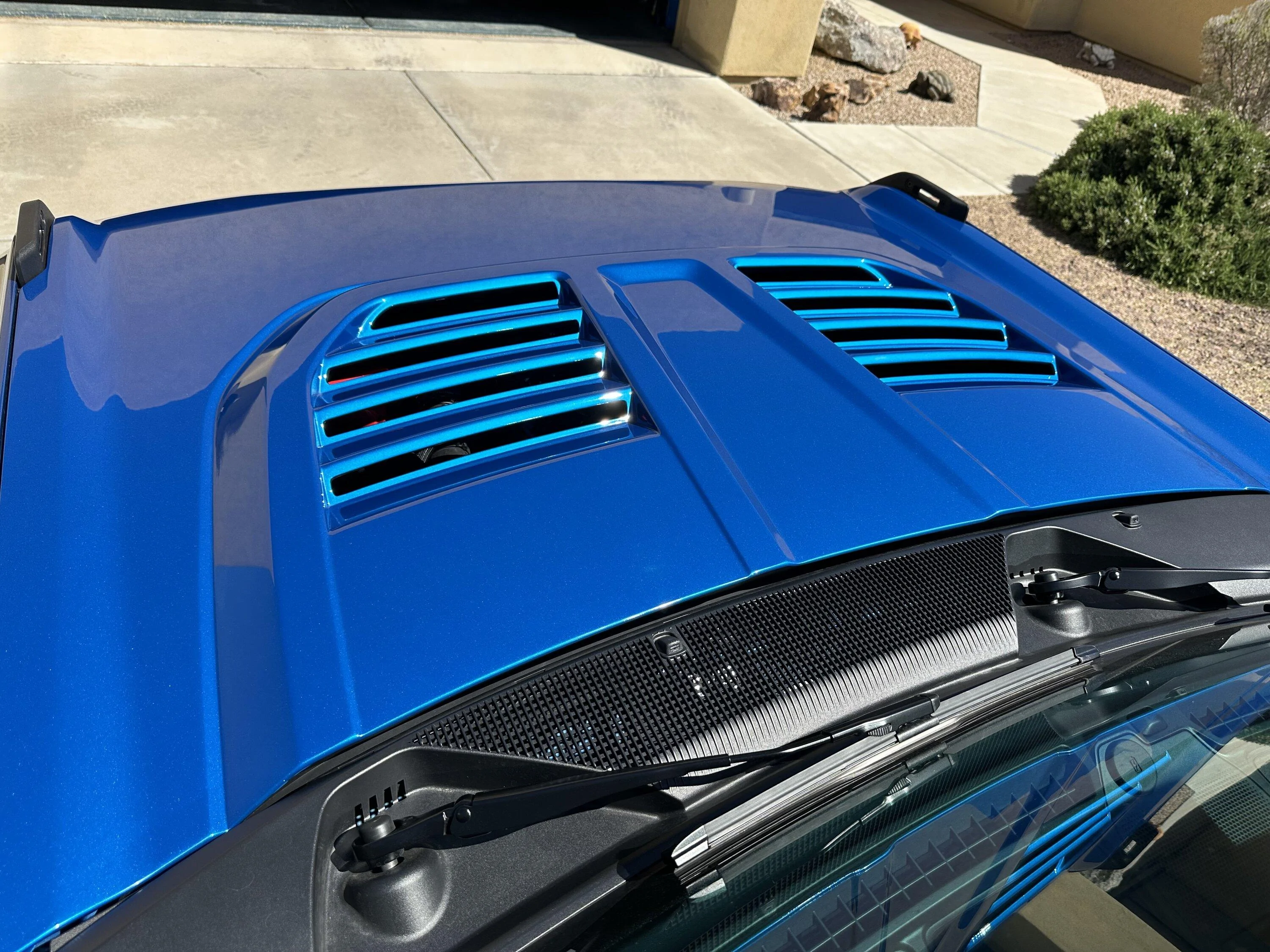

ADV heat extractor:
Ford Bronco APG "Ram Air" Hood Trim w/ Heat Extractor in Carbon Fiber 1685741313419

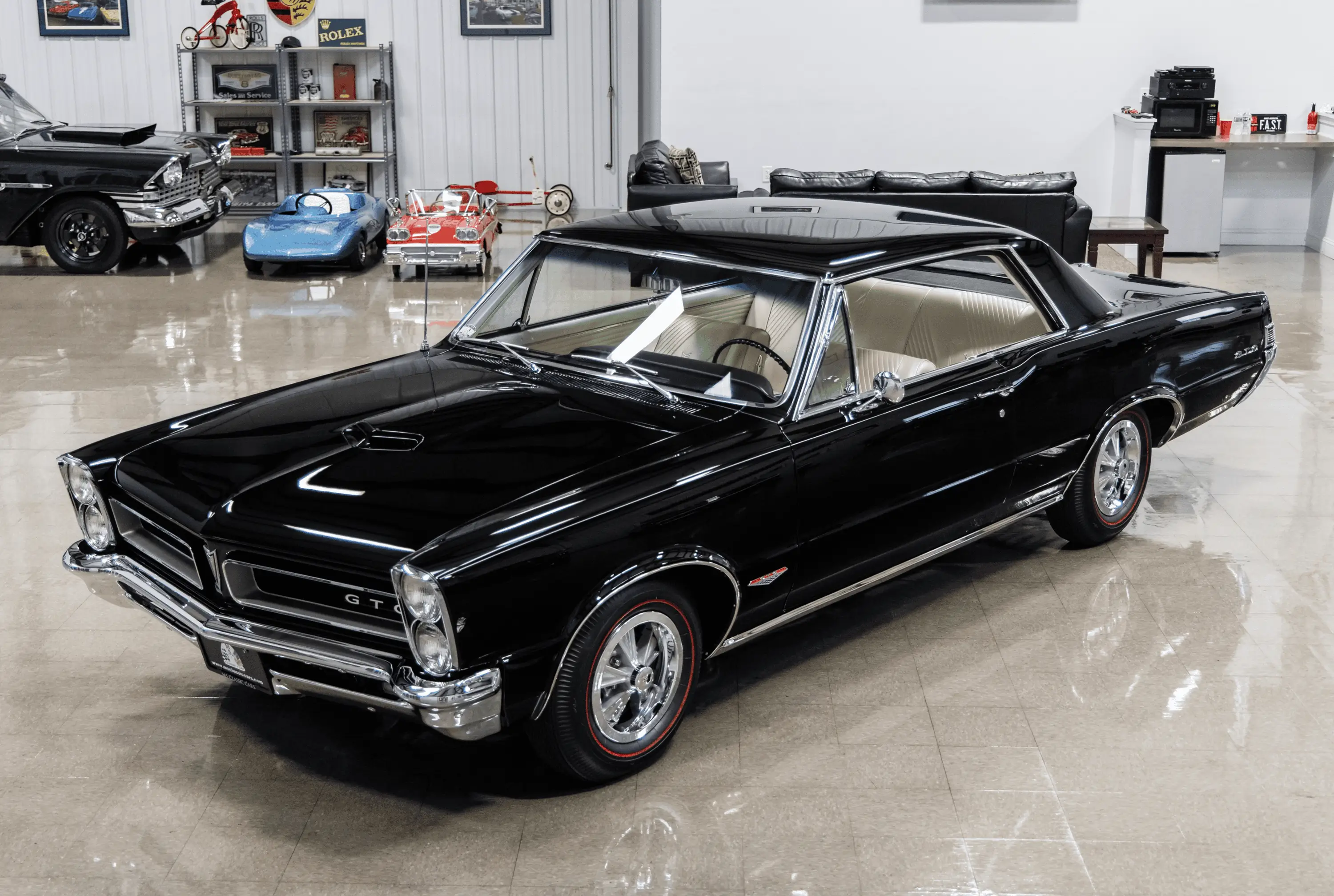

The original Ram Air:
Ford Bronco APG "Ram Air" Hood Trim w/ Heat Extractor in Carbon Fiber 1685741577516

Anderson Composite makes a sweet one that you can get for just south of $1900 shipped so what I’m expecting to be a $6,000+ hood is fun if you have F*ck You money. Unfortunately that’s not my tax bracket. Also no one makes a functioning ram air hood for the bronco currently. The intake is front left in the engine bay and any “ram air” hood for the bronco isn’t forcing any air into the intake.
