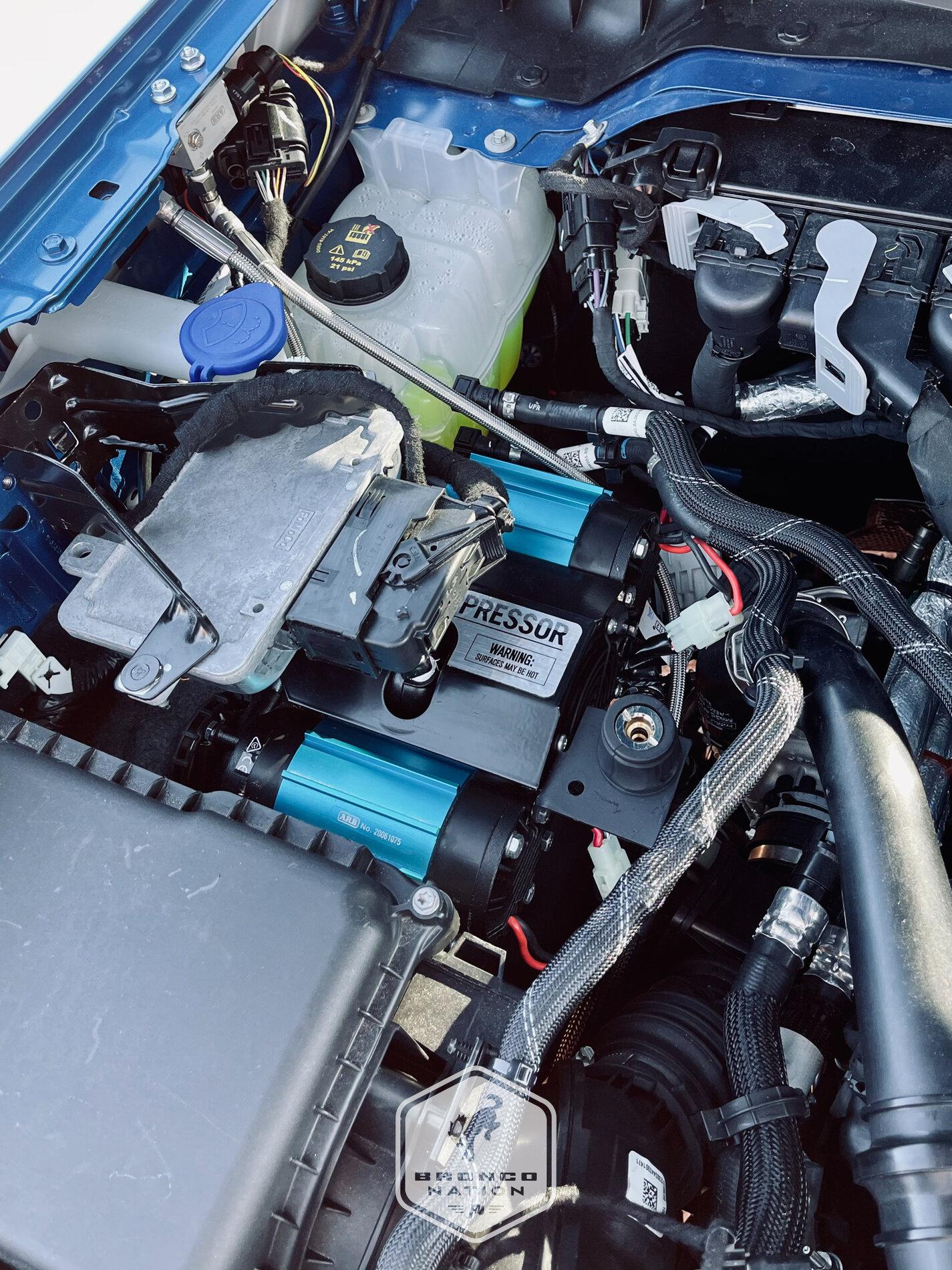

As far as I know we are still waiting for an aftermarket solution. I'm aware of the ARB Bronco compressor install, but I'm not really clear on what they did. If you look close, the module bracket on top of compressor is no longer bolted anything, and it's unclear what they did with the ground wire. Nothing seems to be flopping in the breeze, so I guess we get to wait and see.

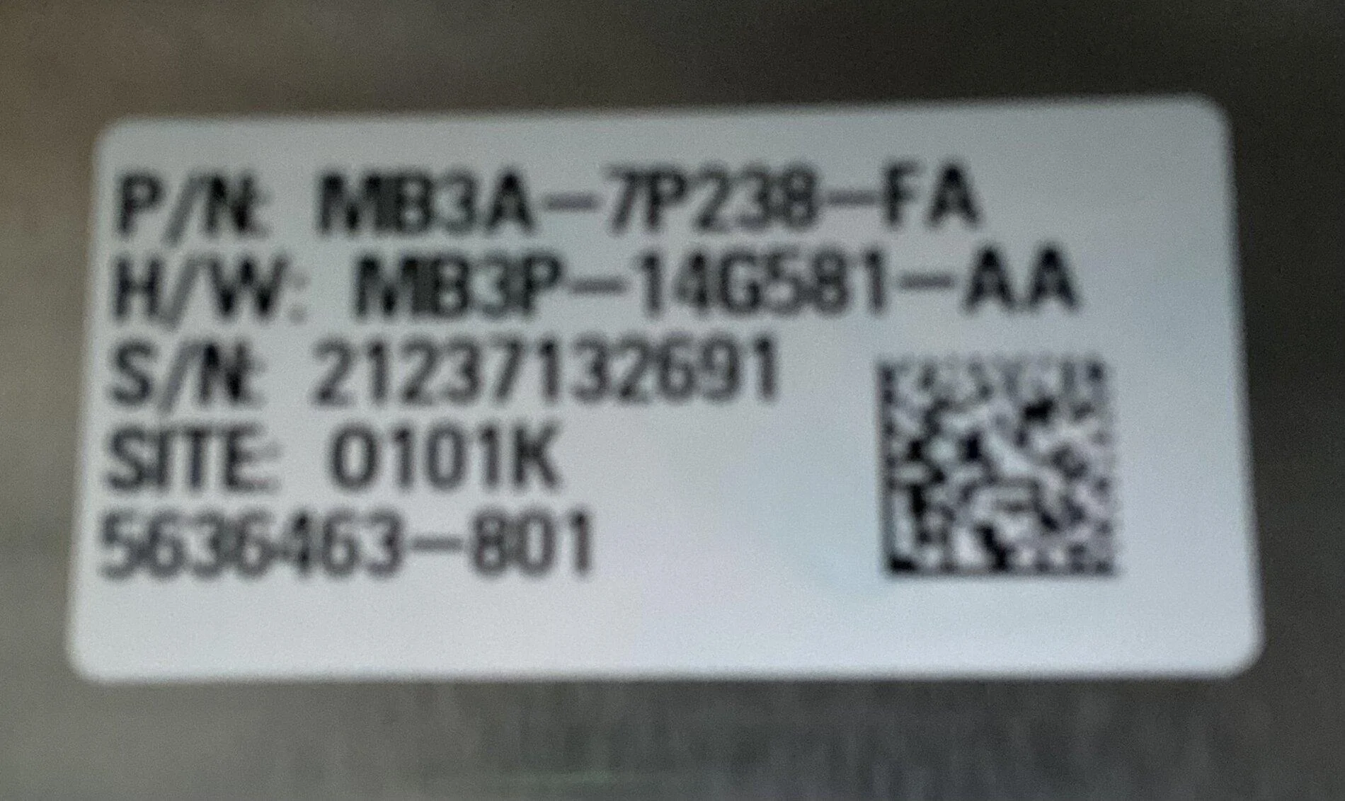

Does anyone (@flip) know what that module is? Part number on mine is MB3A-7P238-FA.

I also suspect it may not be really mounted to anything. Why wouldn't they use the existing mounting holes that the module was using? That's the only solid structure in the area. And when you look really really close, it appears the compressor main harness may not actually be plugged into anything. I also would expect some heat shielding, being right above the turbo and all.

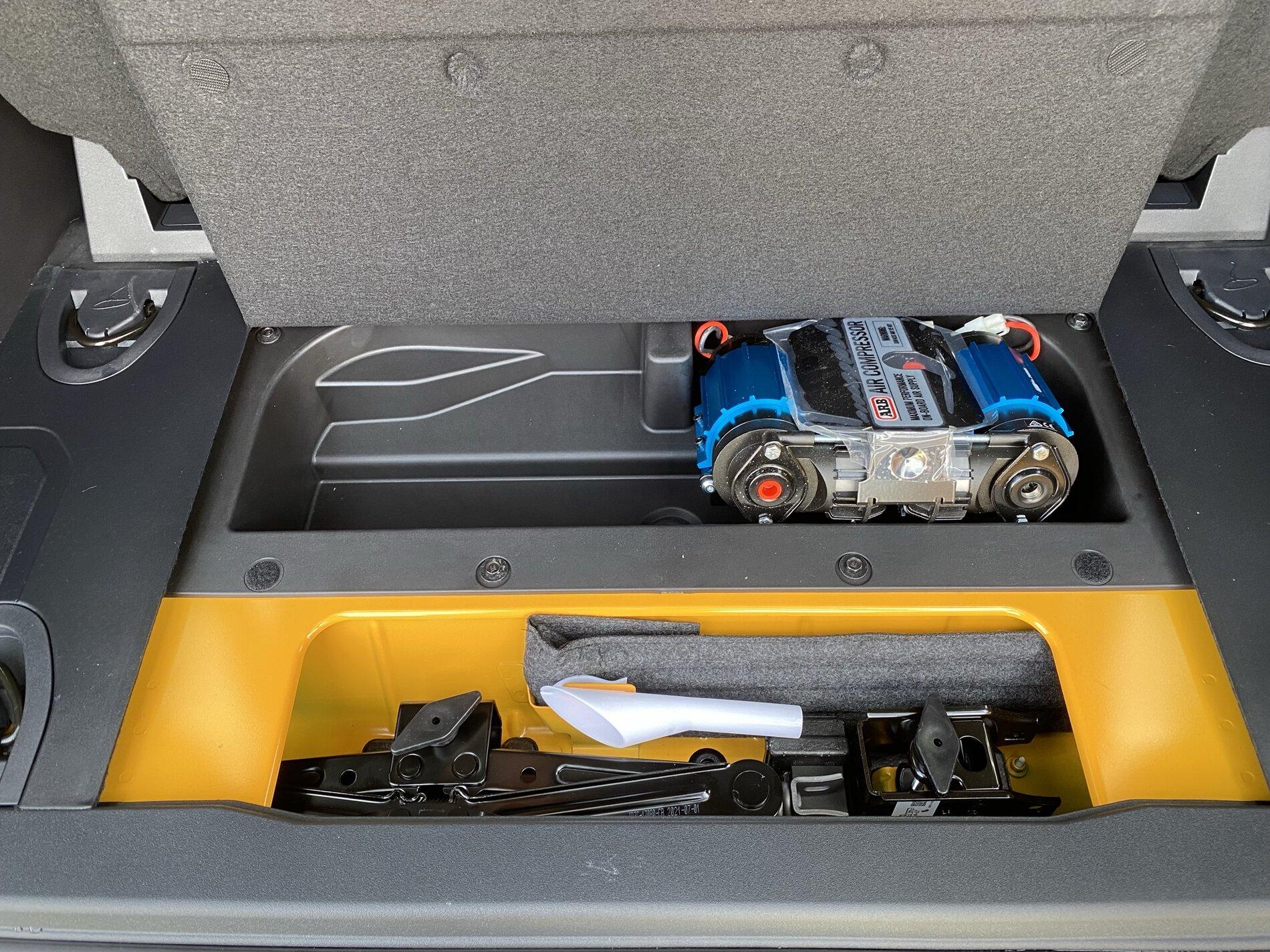

It does not fit in the the under floor cubby of the 2 door. However, I could see a replacement storage box allowing it to fit. I haven't pulled any interior panels, so not sure if there is an option there.
A big advantage to the engine compartment is the proximity to the battery. The specs say it pulls 68.6 Amps at max load.

If you don't have the Lux, check to see if it will fit where the sub-woofer would be located. It is my intent to locate it there with access using the AUX wiring. Of course, I don't have access to a Bronco to see if it will fit behind the plastic trim panel. If it does fit, then a simple quick disconnect port would be needed.

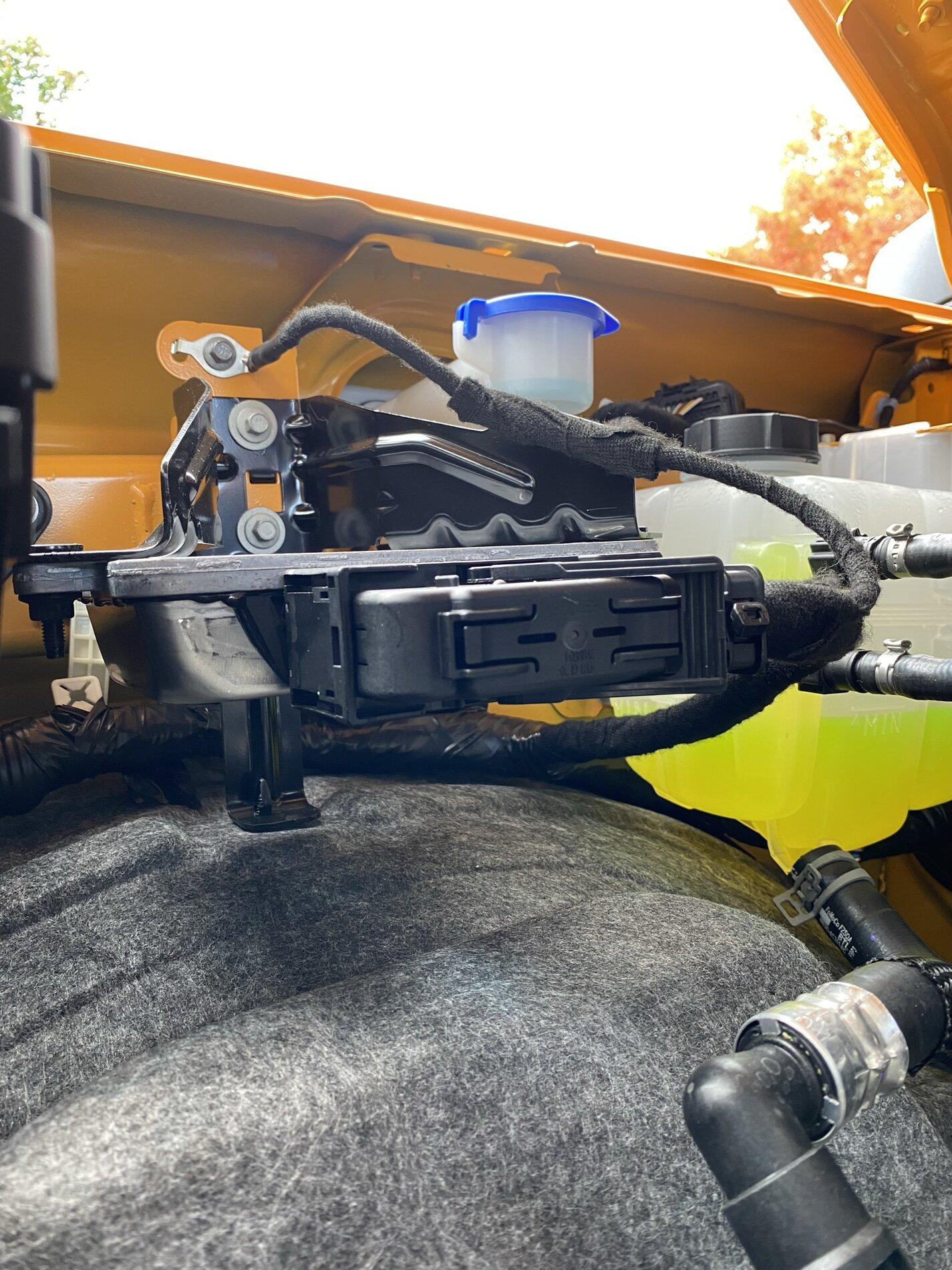

There's actually nothing where they have that compressor mounted. Meaning no support structure really. Under the compressor is the felt/carpet pad that covers the suspension components. Lift that up and you can see your springs - That's why I think this was just put in for some photos and it's not really hooked up. As there is a lot more to it to mount it.
I'm 3D printing a prototype now for final fitment.
