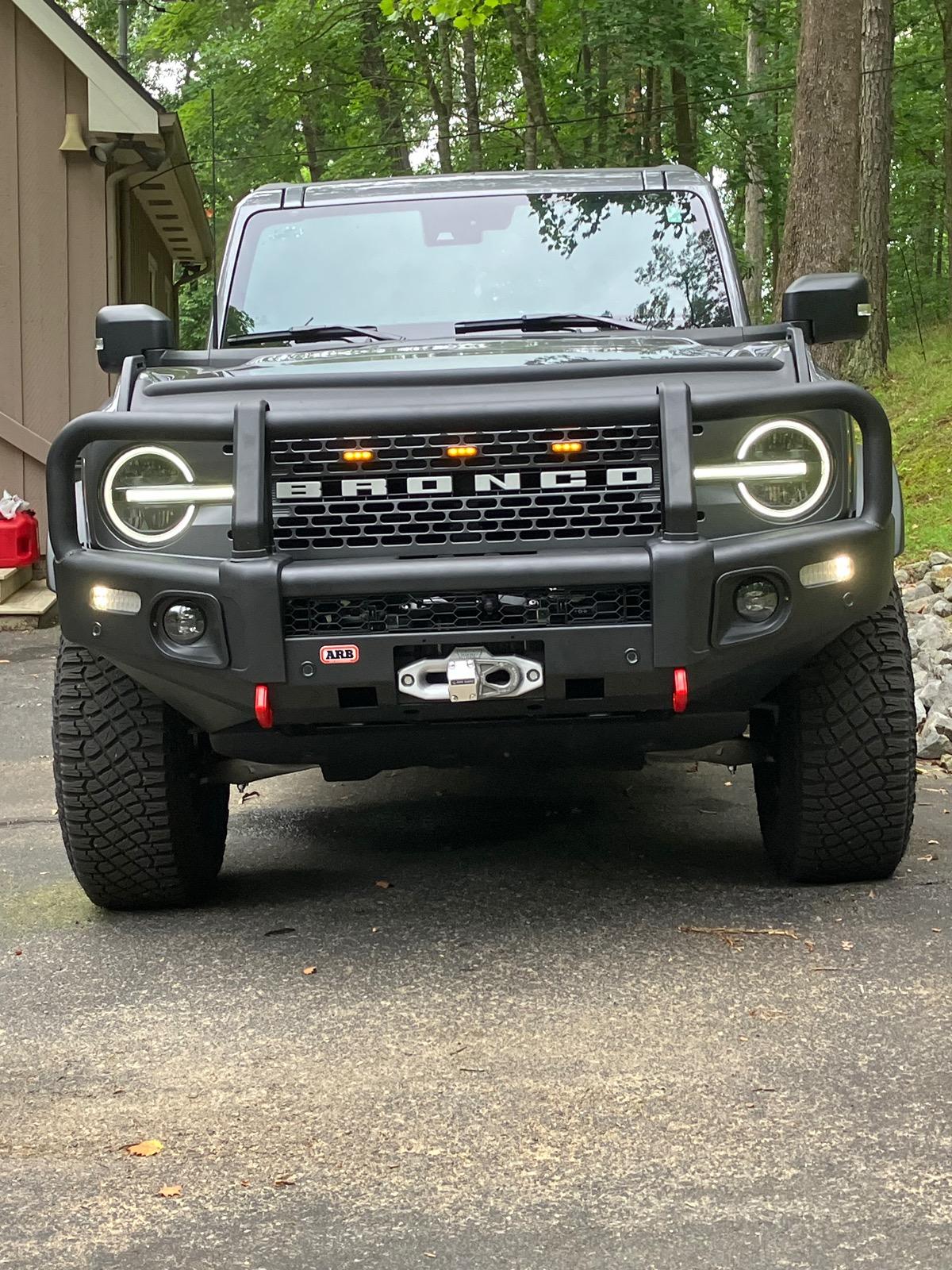

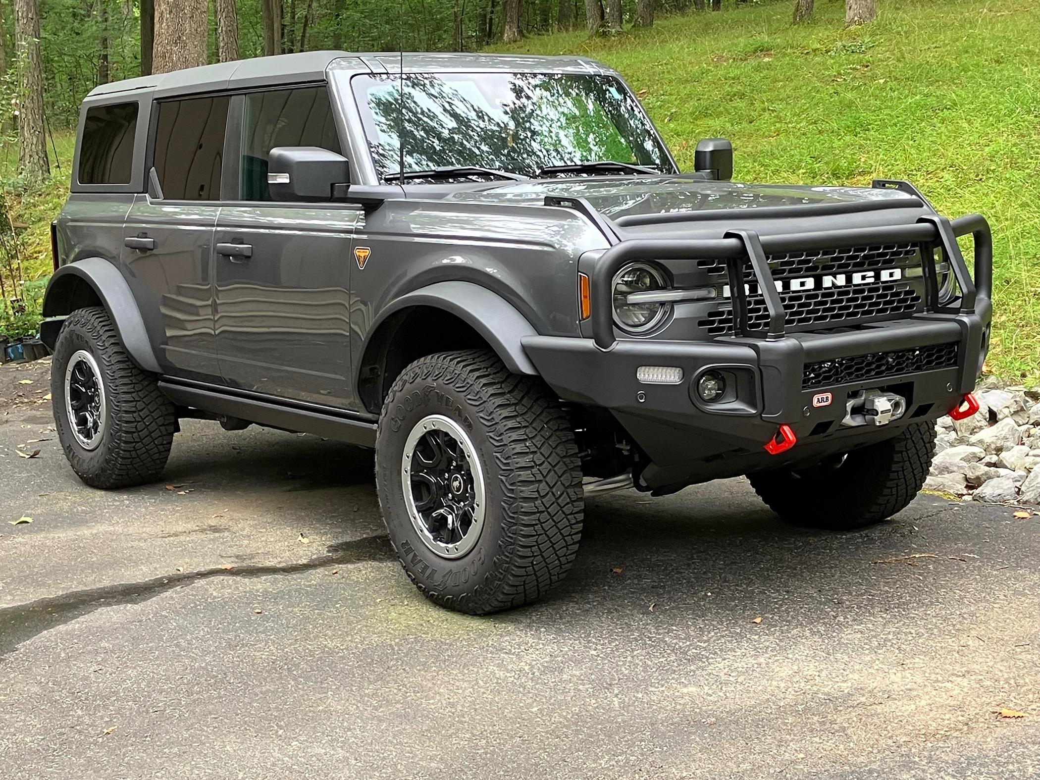

Pretty happy with how this turned out. Used preset height on the Eibach coilovers. The front coilovers have the H.D. springs to compensate for the bumper/winch combo. Front camera and 360 works great. Ride seems pretty good so far (only 20 road miles). She’s begging for 37’s (still more lift available) but my wallet says noooo. Will go with better 317/70R17’s when the Territories wear out. 👀 Look out deer, I’m ready for battle now! 🤣

Nice! Was install reasonably easy?
I was going to do the winch and bumper myself, but I ended up taking to my local off road shop. They had 14-1/2 hours of labor in it, which really wasn’t bad…that was new coilovers (and playing around with ride height adjustment), UCAs, bumper, winch and alignment. There is a fair amount of disassembly from the old bumper to reuse sensors, fog lights, relocate front camera and washer assembly. Then assembling the new bumper, switching stuff over, wiring, etc. Most posts I read said plan on 2+ days with a buddy just for the bumper and winch. I have no help, so, off to the shop it went.
