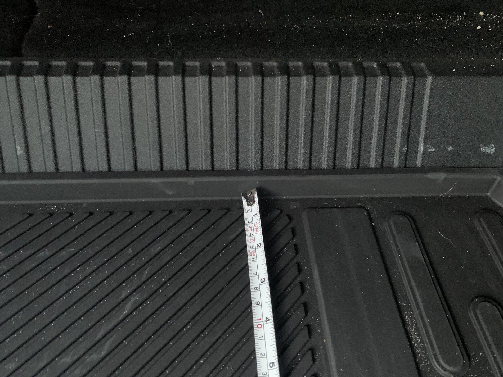

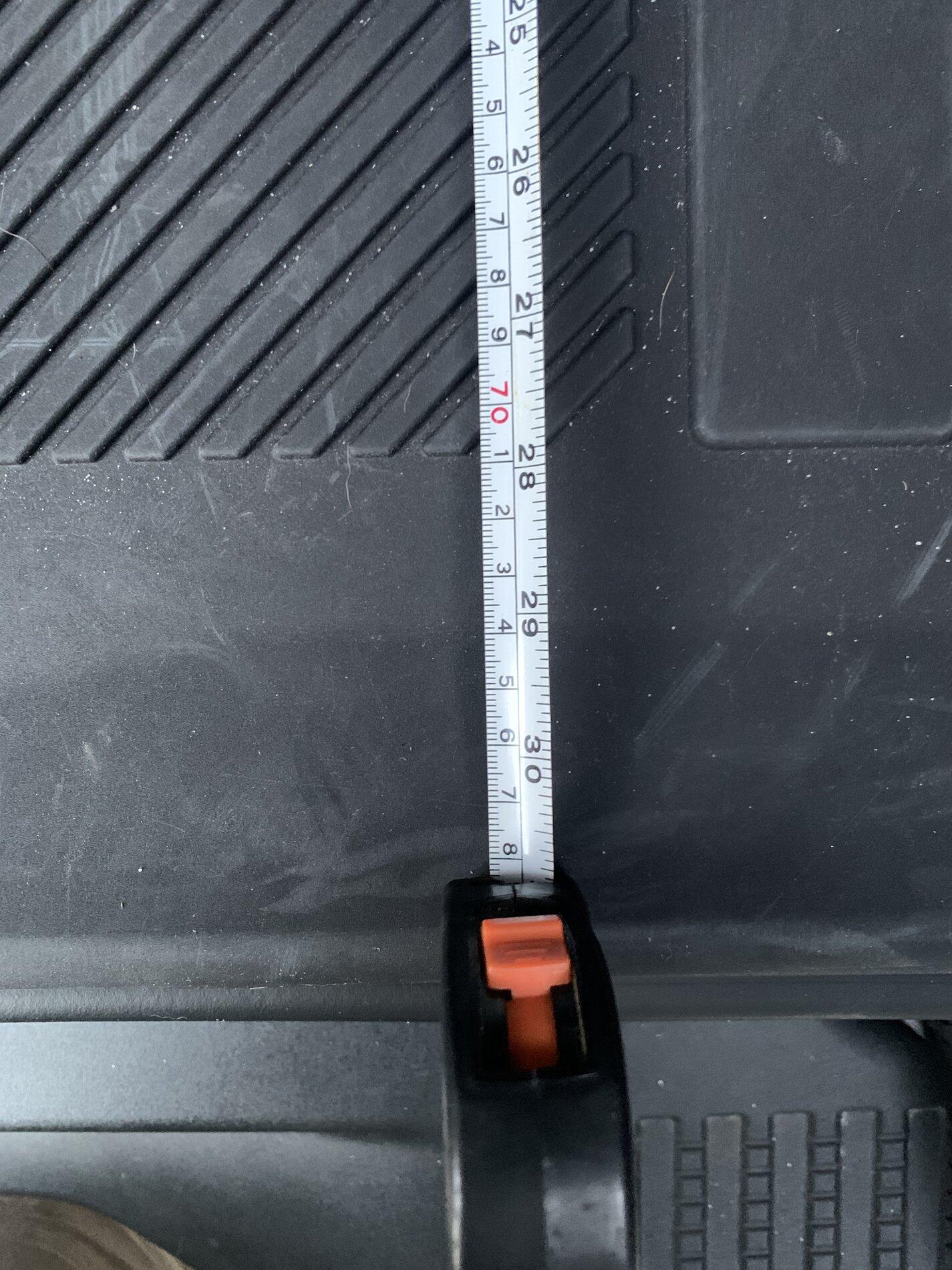

You've seen a 63 or 73 fit the same orientation as your 47 (handle towards the rear)? I'd like to see one in the back of a Bronco with back door closed before dropping $1500.
It will be close. Especially with the flat 12v plug - it should JUST make it.
Ford Bronco ARB Zero Series Fridge Freezers 5B26F655-EBDF-4C46-93C7-842F4CCCDA67
I have the cargo cover - which you lose roughly 3/4” in the back from the sidewall.

Same as above. That being said - I jumped the gun and should have went bigger. Looks like 63 and 73 are the same size footprint. 73 is just taller.

I know it's snug, Can you measure up higher (20in or so) because the back seat slopes. Plus to the inside of the back door. Thanks!
Even with the backseat fully reclined - it doesn’t sit further back than that lip/edge on the cargo cover which is as far back as you will be able to get the fridge and have it level. Door closing has at least 31”.

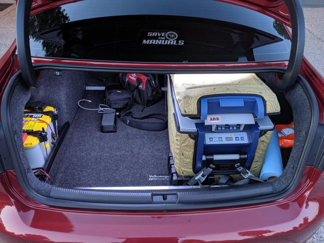

Just picked one up and haven't messed with it too much, but doesn't seem like the outlet works without the bronco being on. Is there a 24/7 hot port somewhere?
This is typical for the cargo area outlet to shut off. In my extensive use living out of a couple different ARB fridges, I can tell you they run best when wired directly to the battery. I rigged the fuse panel in my Subaru Outback and VW Touareg with an add a tap circuit to make the cargo area outlet hot all the time. It worked, but on a hot day the fridge would shut off sometimes because the small wiring showed too much of a voltage loss causing the fridge to shut down to protect the vehicle battery.
Ideally a second battery on an automatic charge relay is the best way to power the fridge. This is the setup that I ran in my Passat TDI for a couple years. It worked flawlessly in Phoenix summers.
