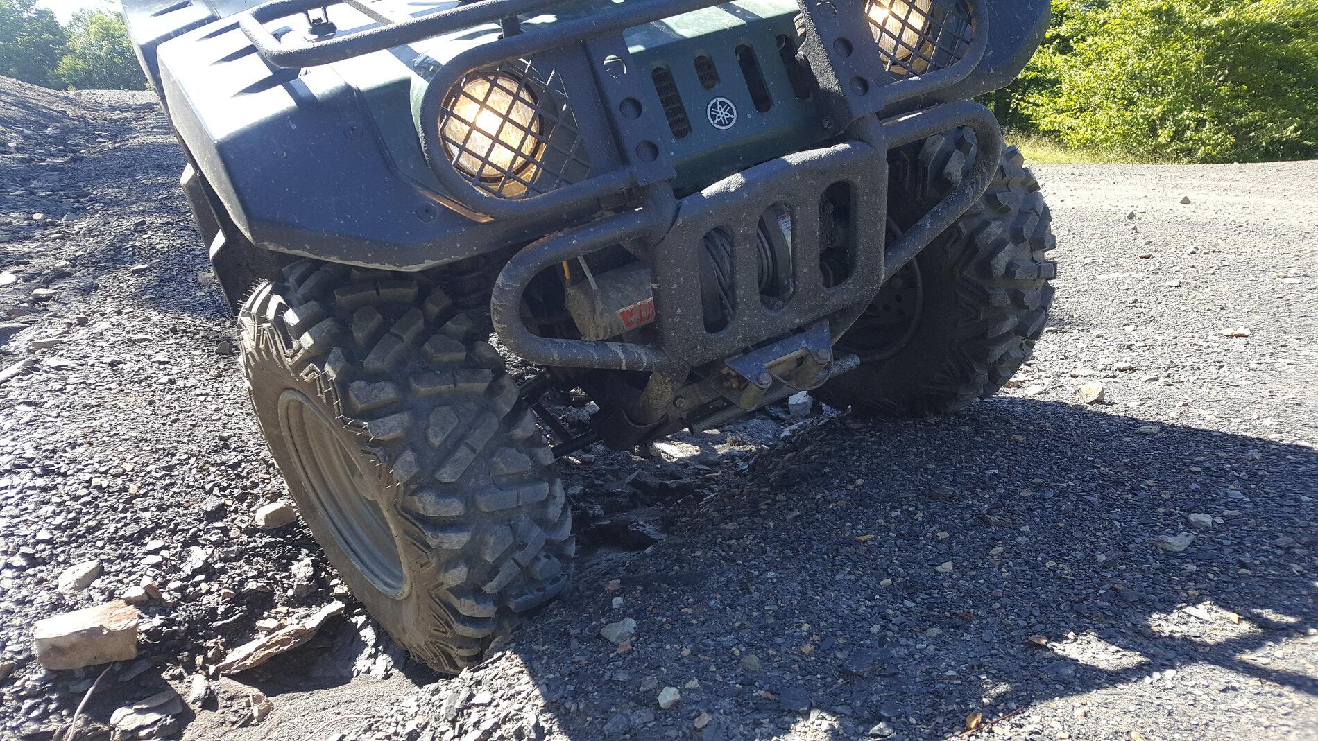

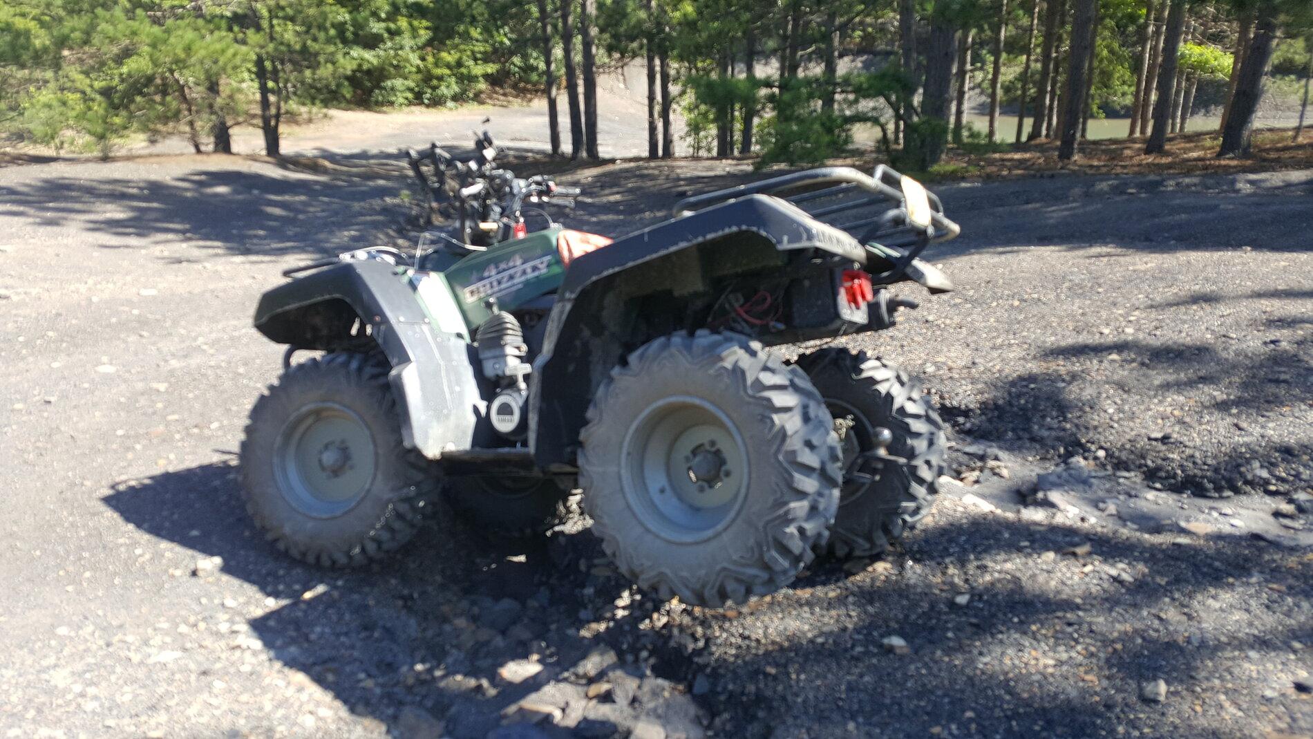

Posted this in another thread but here is my grizzly crossing a wash like the short vid of the Bronc. Hanging the tire happens a lot on the grizzly so I am used to it but it will make you pucker

There is an enormous difference with a vehicle that you ride instead of drive ... your'e not going to be able to use body language to keep traction in a 5000lb truck like you can with a 600lb quad.
I'm not worried when I only have 2-3 wheels on the ground with a quad, but **** can be real sketchy in a heavier vehicle losing contact and traction. If you tip your quad its an inconvenience to roll it back over and keep going -- do that with your truck and you'll probably be done for at least an hour and looking at thousand in repairs.

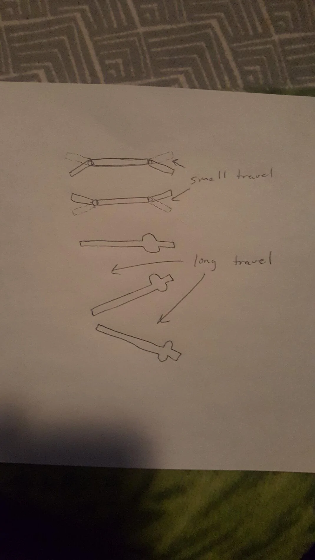

Yes there is a big difference. I posted this only to show how easy it is to hang the tires, everyone here had a fit when they saw the Bronc lifting the tires. Why is that, what's going on, must not have any travel, etc.
it is the nature of the beast with IFS. This is why it is important to have lockers because without them you need momentum to clear obstacles and with momentum(read: speed) it will get you in trouble. Try climbing a hill and no lockers, instead of just crawling up it you need to gun it at the bottom to have enough speed to make it the top. then the large bolder you are trying to get over suddenly throws you into a tree sideways. SMASH !!! Now same scenario with lockers you just cruise right up because the speed is not needed. to maintain forward bite. Watch the XJ in the Lite Brite vid above he tries with speed and more than once, just about wacks the tree beside the trail. Later in the vid he tries the trail called Barney Rubble, lots of wheel speed and lots of bouncing, VERY uncontrollable, with lockers you are in control even with a tire in the air.

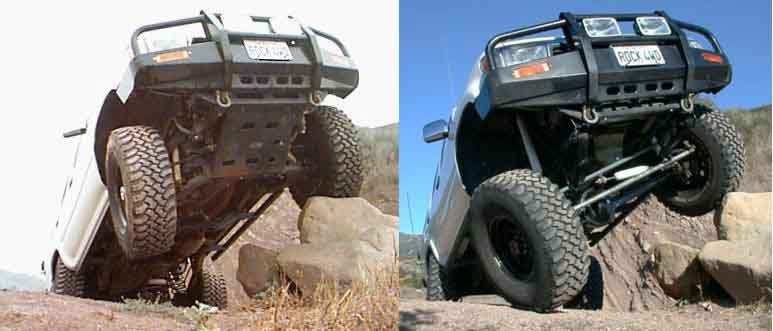

Second pic is one I post long ago, just to show how you can't get the same articulation from IFS you can from a solid axle. one pivots side to side and the other only pivots at the end.
